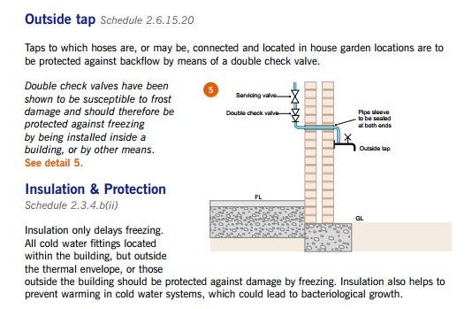

@mrcrow Find attached the water regs for an outside tap. Note that the Double check valve is required to be internal to be protected against freezing and that insulation is not classed as a protection against freezing only a delay against freezing. The check valve should be in a heated part of the property or provision made to ensure that freezing cannot occur.

that is pretty clear
the tap will be installed inside my garage...do you think it will be ok there in frost conditions?
i can put a frost cover on it...otherwise...where should i fit the required double check valve...the source of the cold supply is from the central heating boiler in the cupboard where its situated...and also used as a airing cupboard...there is an isolation valve there so i could cut into the pipe at that area and it would certainly not ever freeze
the rest of the pipework is all inside the garage which is attached to the house and fairly cool but has never shown signs of freezing

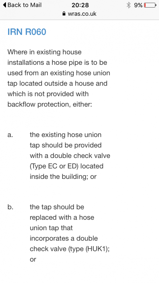

In practice Jon, I agree with your post above, but to be fair, the WRAS website states the following...
And while I agree with that sentiment we aren't talking about an existing installation. This is to be a new install to the front of the house.
