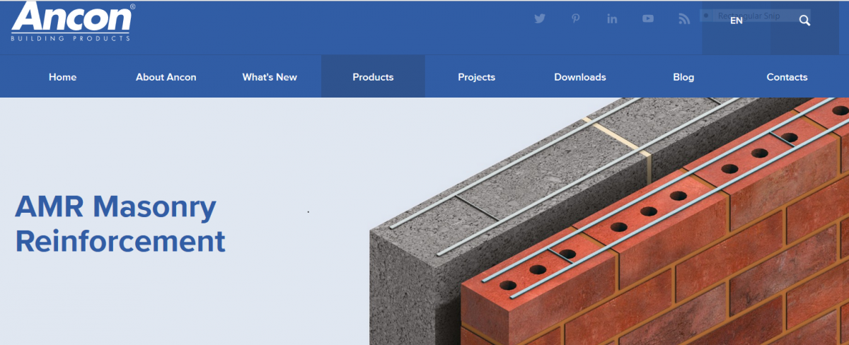

As a matter of interest, did they specify stainless steel mesh or galvanised? Galvanized is OK on the inner skin, but if any is on the outer skin, it should be s/steel.
(I was caught out with this some years ago; the galvanising soon breaks down in an outer skin due to the dampness).
In any case, if the SE specified that as some sort of tensile reinforcement for the masonry, coiled mesh is not advised for that purpose - the proper stuff for that purpose is the stainless steel ladder frames made by Ancon.
Both the architect and the BCO raised eyebrows about the reinforcement and neither would have been bothered if it went in or not. I'm not even sure whether it was galv or SS. The SE did recommend the Ancon ladder type but I could not get any locally.
