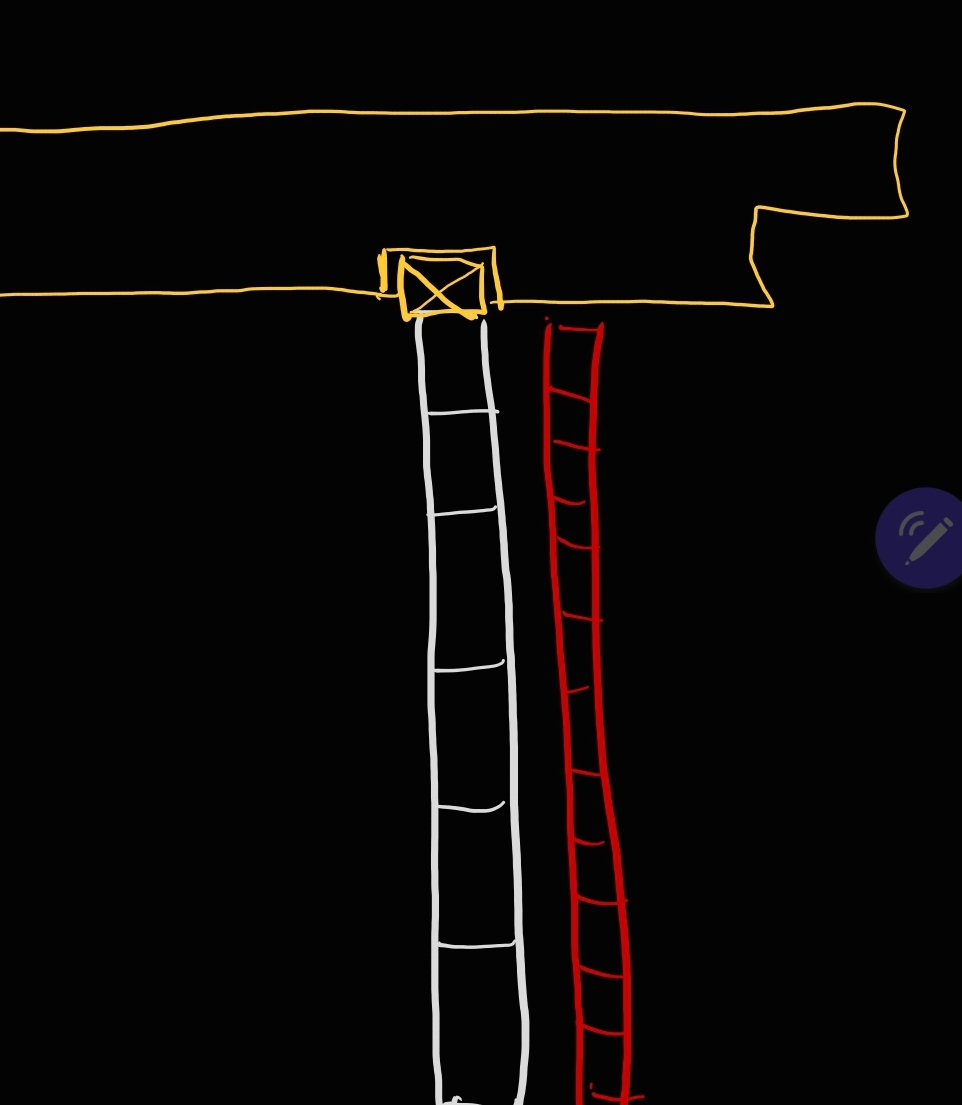

Ok, got it. But why is the steel beam over the bi-folds set so high up - i.e. way above the standard 2100mm?
We are going for full height doors hence the steel beam height (were only only doing this once )

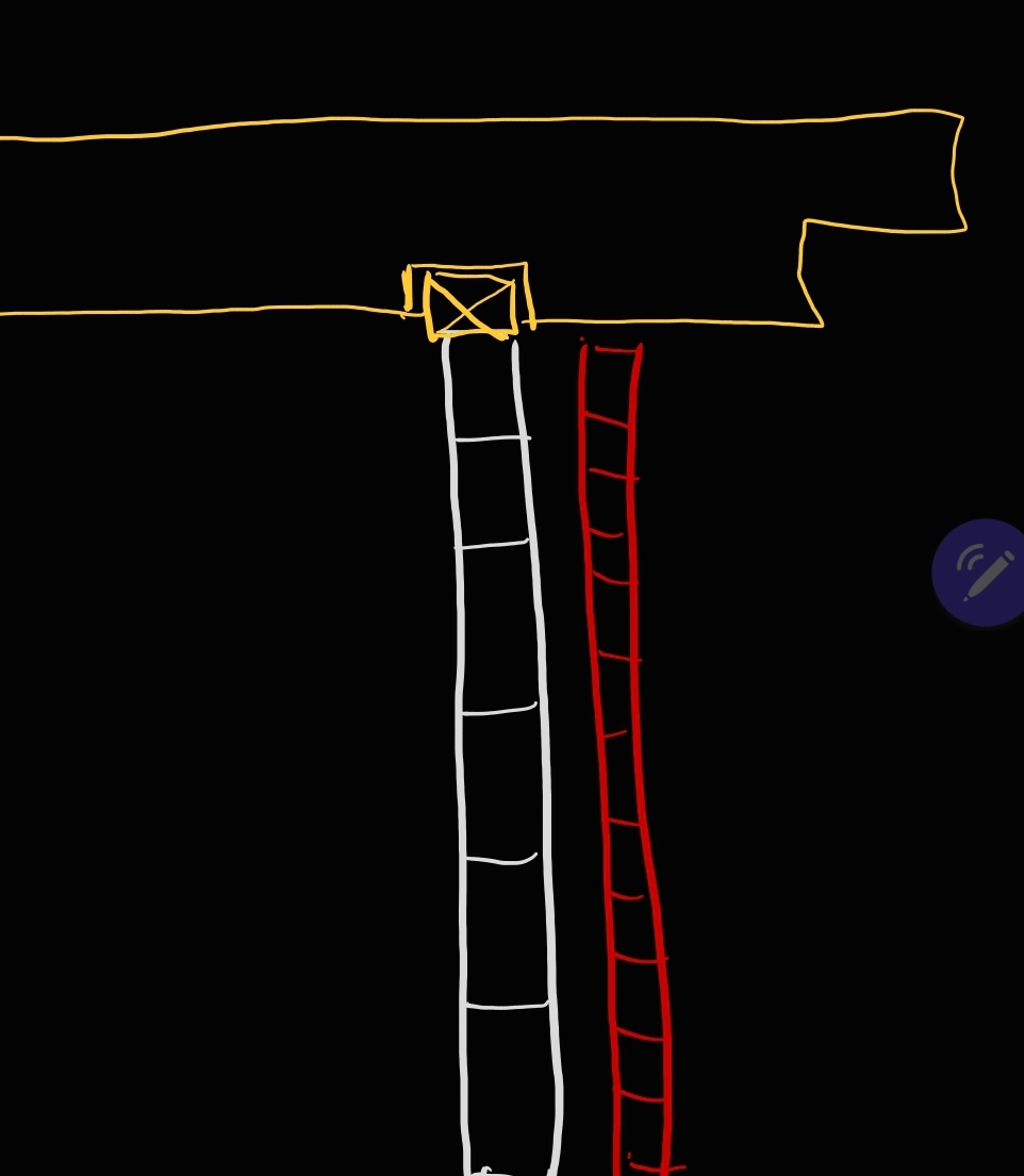

As for the notching, in my head, if I run a wall plate either side of that steel beam I would then have to cut the underside of the joists to allow the joist to sit on the wall plate but keep the remaining height for the where the joist overhangs the externall wall.
A very crude sketch below of the cross section either side of the bifold steel.
If the wall plate isn't necessary and to save alot of cuts, I'm wondering if I'd be better off strapping the joists now instead of the wall plate.
But I could be over simplifying this/missing something important......

Set the wall plate lower, lol.

Can't help feeling notching the joists for a wall plate will undermine the integrity of the joist
Indeed, fit a smaller wall plate, a lower wall plate (blocks cut easily), or notch/rip the wall plate rather than the joists

unfortunately this section knackers me for the 400 spacing specified by the structural engineer.
Mmm, and if the spec had been for the beams to be bolted together directly and rest on top of the column then the packing wood would likely have been close enough to just hanger either side of the connection. Shorter bolts or the other way round might just have given it to you too but not to worry, there are always solutions..

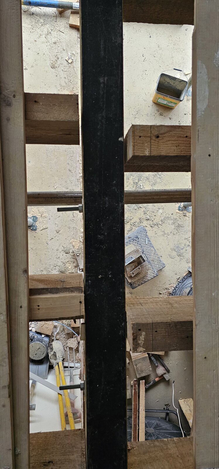

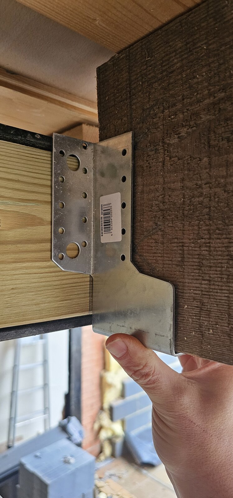

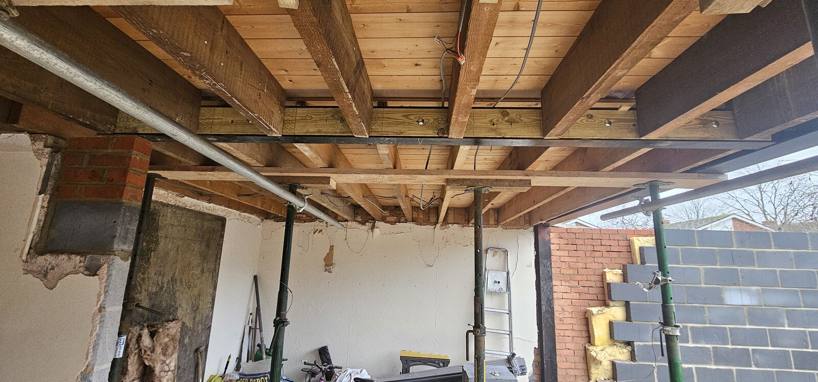

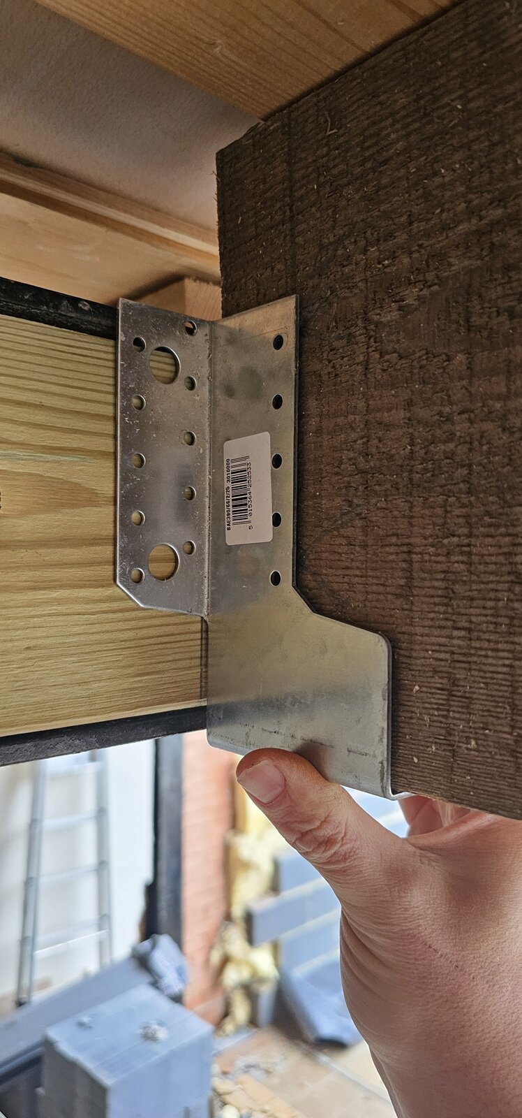

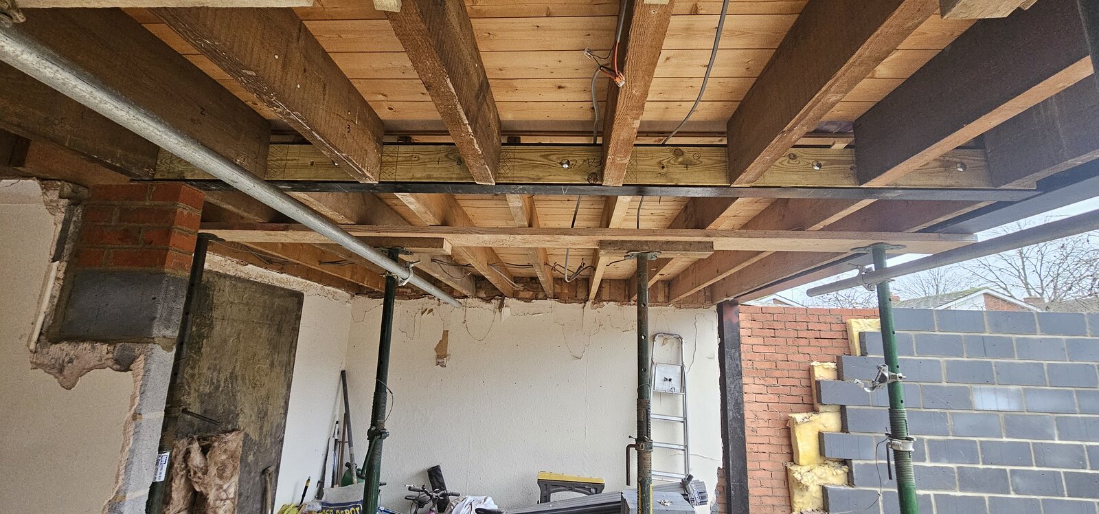

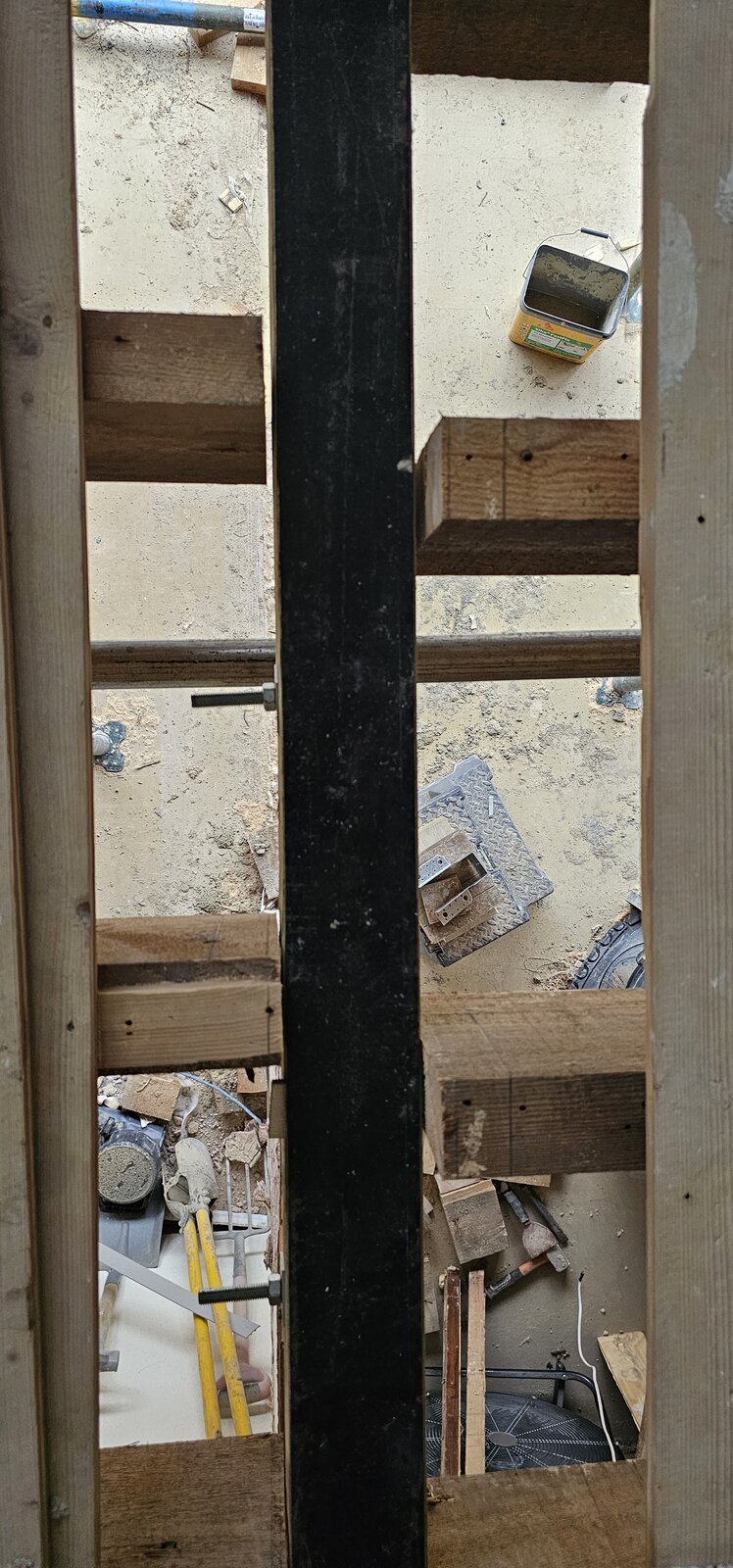

Quick follow up if I may,
Installation of steels and packing the webs has gone well as has installing most of the joist hangers, I opted for the heavy duty (Simpson SAE range) but one of the smaller steels may require a different approach,
As you can see from the attached the profile of the steel specified means the timber packing out the web won't catch the top for nails (top two on each leg of the hanger).
Ontop of the steel requires a timber packer (approx 75mm).
I can't find any details on reduced load ratings if those nails are not installed, so I'm wondering if I should go for a a longer leg option or not using those nails holes would have a negligible impact and I should just crack on.
Cheers
