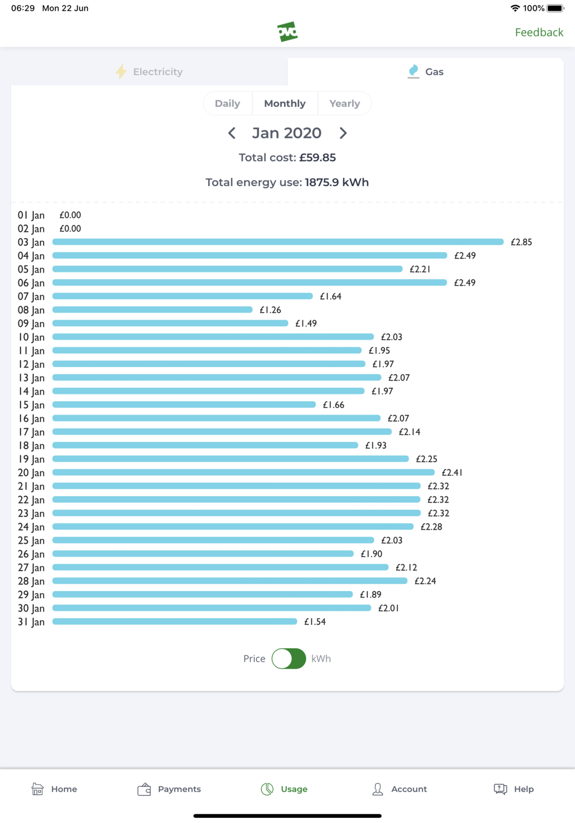

Maybe a quid if you’re really unlucky or have a massive house. When we were away over Christmas and New Year and came home mid morning on Jan 3rd to a stone cold house, it cost us £2.85 that day (including the standing charge) to get the house up to temperature and heat the hot water cylinder. It took a lot longer than usual. 3 bed semi. In fact, looking back, that was the most I've spent on gas in a day, ever!
Gas is cheap as chips at the momentt, 2p/kwh. I'll bet your standing charge costs more than gas usage during the summer
