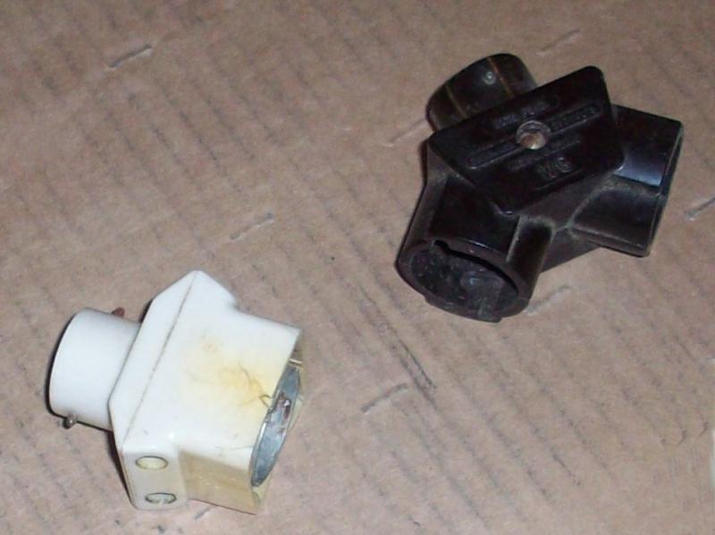

There was a time when my grandparents had virtually everything electrical run from the lighting circuit (I think they only had one or two 15A sockets) - I remember frightening 'Christmas trees' of (mainly 2-pin - "what's an earth?"!) adaptors dangling from lampholders. However, that does not move me to advocate any such practices in 2014 :)

Probably worse - I certainly remember my grandmother doing her ironing with the iron's lead dangling from a 2-pin plug plugged into one of those things (that is, after she retired the iron that she heated up on the gas stove :) ). As a small youngster, I used to have to move the kitchen table so that it was positioned beneath the light (the iron's lead was not very long!), then climb onto the table to plug the iron into the lampholder adaptor for her!
Kind Regards, John
We had an adaptor that went between the lamp holder and the lamp. The outlet for the iron was un-switched but the outlet for the lamp was switched with a pull cord. I am told that about the age of 6 I took it apart to see how it worked and managed to get it back together again in working condition.
