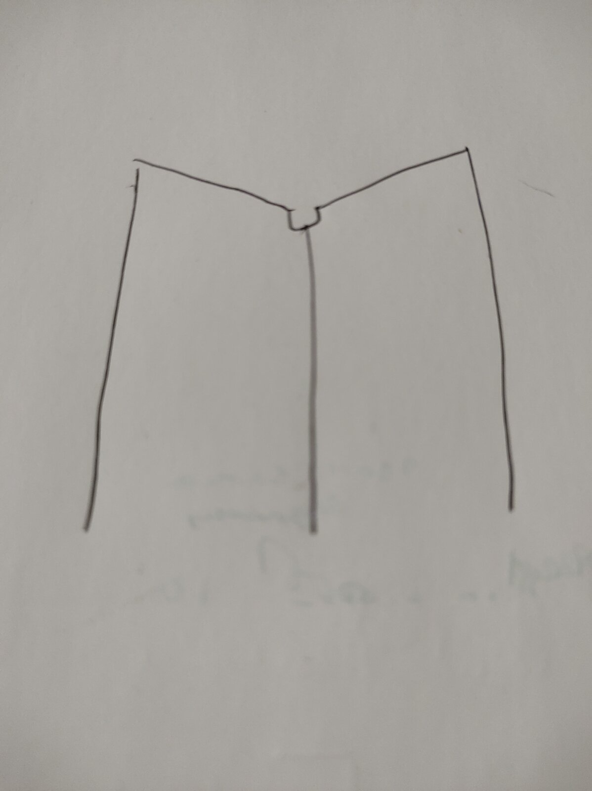

Hey all,
Me and my neighbour have decided to utilize the space between our two houses. I was thinking to build a roof covering the area, and use it as a storage space.
I am considering using polycarbonate sheets for the roof, shown on the picture in red.
Would be using 3 sheets per side, each 5.5m long and 0.8 m wide.
My main concern is how to add the fixings and the ridge once the sheets are in place. Is it possible to move over the polycarbonate roofing with a sliding board or lay over a ladder to reach the ridge/sides without damaging the polycarbonate sheets?
Or would it be better to use 1m by 2.4m sheets and put them "horizontally" from house to house? The concern I have is that water will end up in the glazing bars as they will act as a barrier.
Any advice would be greatly appreciated!

Either do it as a leanto (so one side is higher than the other) or have a central ridge supported from the ground (such that if 1 neighbour decides after a while they don't want it the other side can stand on its own).
Corrugated poly is pretty weak but with an A frame ladder reaching over 800mm to get fixings in is not hard

Having read some of the horror stories on here about "connecting" houses with these structures it's not something I would do. By all means something sympathetic, using shared central supports would be ok. The biggest issue would be flashing the house walls - I would make something like this (maybe two gutters as already mentioned) so the water is shed centrally.

Some pointers
1) glazing bars can only be used in same direction as fall
2) twin wall polycarbonate can support your weight provided a suitable plywood board that spans rafters is used, so don’t panic on that
3) your biggest issue is weathering the walls: are You happy to grind out a cut line in the render and put in a lead flashing?
4) I would keep the ridge simple - just use lead flashing maybe use a lead roll mop. Hold the flashing down with the glazing bars

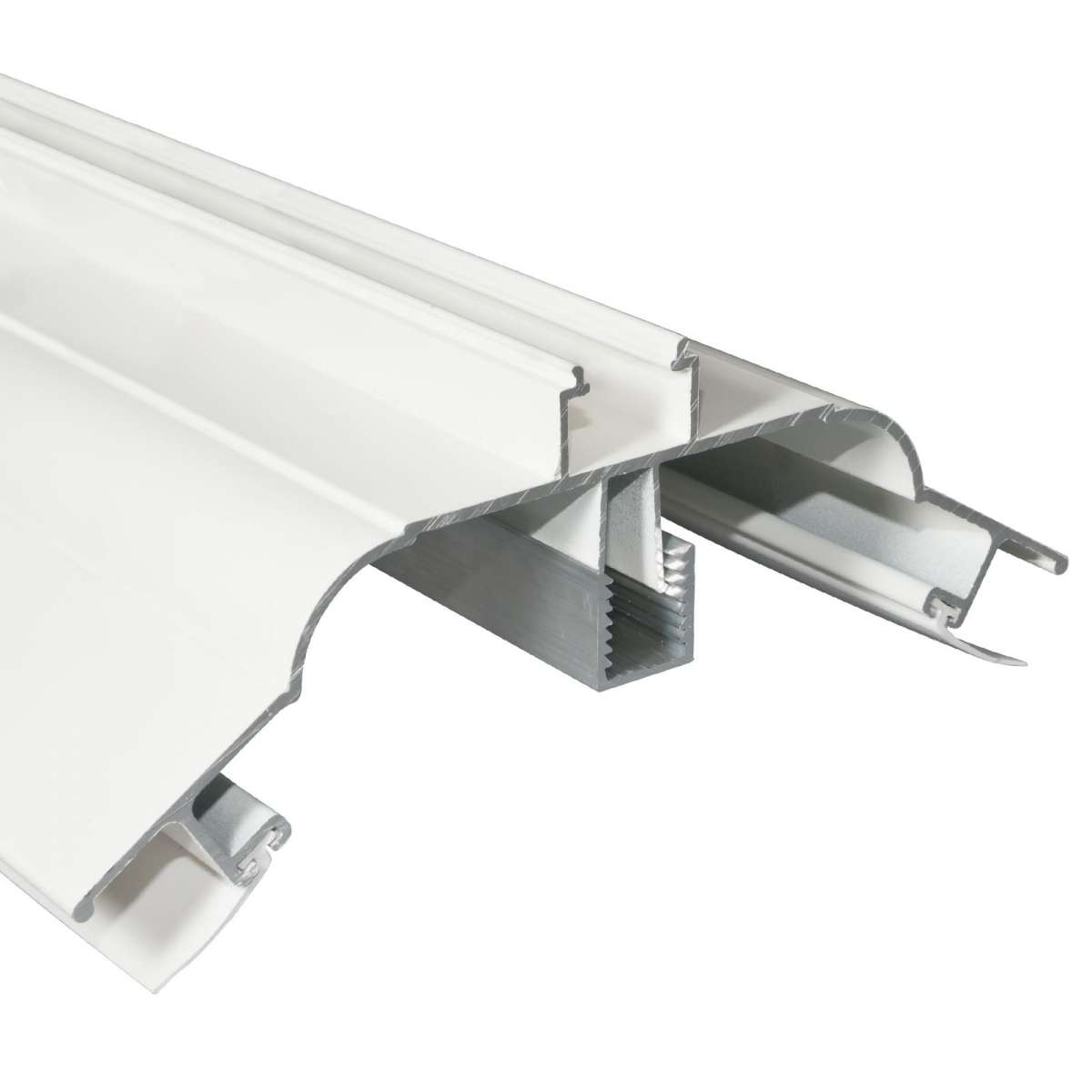

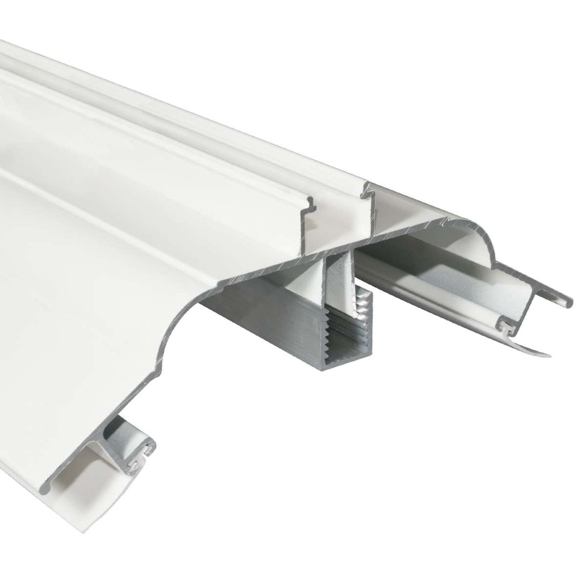

About Nr.4 - for the ridge I was thinking to use something like this:
But you are right, I didn't think how to waterproof the side. I can't find online a ridge that comes with a flashing.
Only this end plate, not sure if it would do the job.
Would there be some video where I can see how to possibly do that ridge flashing relevant to my case?
