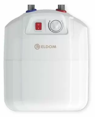

A under sink water heater like this upload_2022-3-21_7-14-55.png holds 7 litres, and I am sure one could set up a system where it heats water when solar panels are exporting, but the big question is by time you consider the cost to fit it, would it be worth it?

Thanks for the thoughts. Yes the installation isn't cheap, I'm thinking perhaps a vented thermal store, and that's likely to cost £1,000 on its own, bore fitting. However, it's a lot cheaper than a battery solution to store the excess electricity. I'm lucky in that I have a space directly next to my bathroom for the hot water tank so pipe runs would be very short, and as I say I'll keep the kitchen hot attached to the combi.
