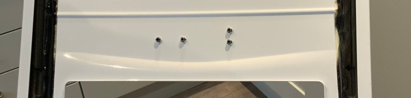

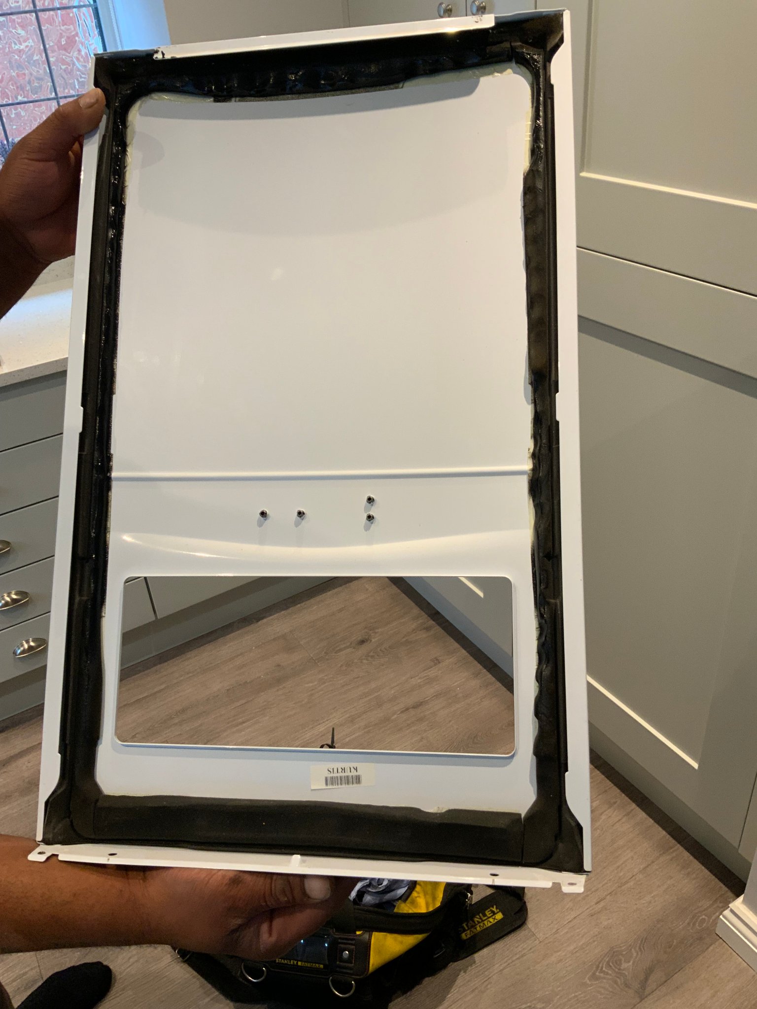

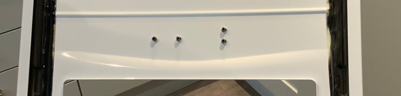

I had my boiler serviced today, it's about 8 years old, and the engineer noticed the foam seal around the inside of the front panel was sticky and had deteriorated.
He had not witnessed something like this previously so I contacted Vaillant technical services and sent them this picture.
Their reply was:
"The foam seal on your door has completely deteriorated due to excessive heat from a passing burner seal.
There should be foam covering the entire door.
The door will need replacing as this will not compromise the doors room seal."
Is this an issue normally experienced with this boiler after 8 years and is it dangerous?
I think that looks like one of the newer ones, if so, then it’s fine. The older types had the cover sealed all the way across. If the pcb housing is fine and the cover forms a seal all the way around the outer edge then it’s fine. They’re only classed as At Risk as there’s no current danger (from what we know).

Thanks for your reply.
When they said about the foam covering the entire door, I thought it strange as it's never been fully covered.
