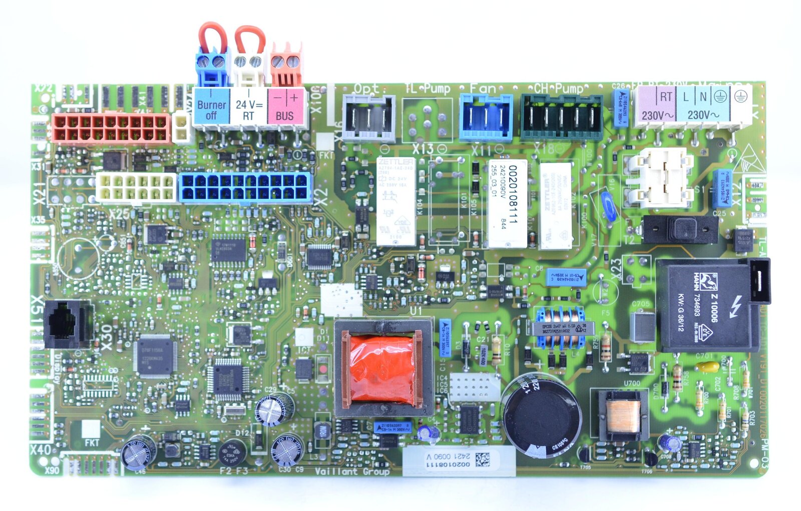

I just bought one of these thermostat but I am not 100% sure of the correct wiring to the boiler,
Boiler model : Vaillant ecotec plus 824
Thermostat KKMOON HC-T010-EWF
Could you please clarify it to me?
Andrea
The simple way is 1 and 2 to 24 volt RT and L and N to L and N and E just safely terminated, in theory should be two cables one for extra low voltage and one for low voltage, in practice it depends how close the thermostat is to the boiler.
The on/off thermostat is only to stop boiler cycling in the summer so does not really matter what room as long as set a little higher to the TRV temperature, that boiler clearly designed to use a modulating thermostat if being used to control area temperature, I note the MODBUS and the BUS +/- so may be the thermostat can be connected to bus instead of using the extra low voltage option, but I personally do not know if they are using the same protocol, or where you would get the plug to fit back of thermostat.
If you wait some one may know if you can connect to the ebus, personally I would not take the chance without a lot of reading up first, but would use two cables so I could switch to ebus control in the future.
