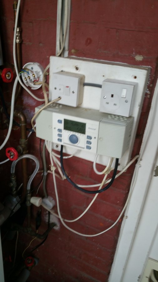

3 this week for me too Today's was Hot Water, 4 rad zones with Hr92 heads and a mixed circuit on the HM80.
All to replace a rather mullered Smile
