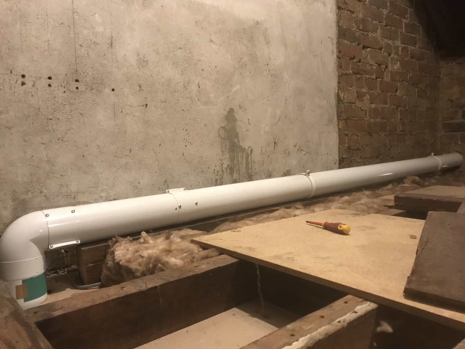

Hey John! now that is a great comment!, and I think you may be right - I have this odd thing on my computer that renders PDF glyphs (like plus/minus) as squares, or sometimes as something else entirelly (like for example a minus - indicating 'to') I did find the range a bit odd when I was reading it, and it would make far more sense to present as a median and then a variance plus or minus. that makes it entirelly clear in my mind then - install specs is an absolute minimum of 30mm per meter of pipe run drop. I'll be having my laser level out tonight, but just by eye (as everyone else already said) there is just no way it's installed at that minimum angle.

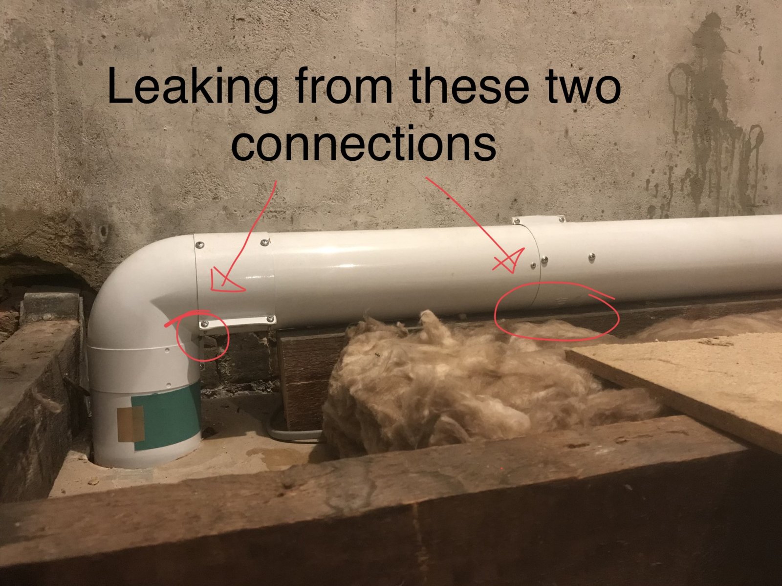

I have a thorny issue with a flue installed at the same time as a new ecotec boiler about a year ago. I noticed a couple of months ago that it was leaking from two of the connector joints connecting the extension pieces of the flue together. I called the original fitter - he came, said it was all installed correctly (I guess I should have watched what he did to ascertain that) and said that Vaillant flues “ have this problem” and that I should call them. Clearly that’s rubbish, but i’d like to know what the problem could be. I’m not having him back here again, that’s a lost cause, he either doesn’t know how, or is not willing to, fix it.
After he had visited one of the joints had stopped leaking, (I think) - you can see a little green strip of paper taped to the pipe as my test to make certain)but the other one remains leaking...
I did call Vaillant, they told me (unsurprisingly) to get another plumber....
It looks to me like it’s installed at the correct angle (believe 1-3 degrees sloping back to boiler).
Attached a couple of pictures...
Any ideas?

Looking at that picture it’s looks like the plume from the flu has been slowly eating away the cast iron pictured just to the right of the flue
Not my problem, but you dont know its condense, it could just as easy be rain water,or an installer having a schitty day and couldn't be bothered to clean up the cut end of his flue and pushed the flue gasket out when he assembled it, who knows? Without being rude, having spent my entire working life as a gas fitter and serving a five year apprenticeship, I probably know a thing or two, just because my RGI membership has expired doesn't make me an idiot theres alot of idiots out there who have their cirtification, the installer of that flue for one.

just for the record i meant that although the flue isn't falling back to the boiler (judging by the brickwork to point it out obviously to the OP) it also might not be cut straight, de-burred, or pushed in enough. But to see that the flue would have to be dismantled by a gas safe engineer.
