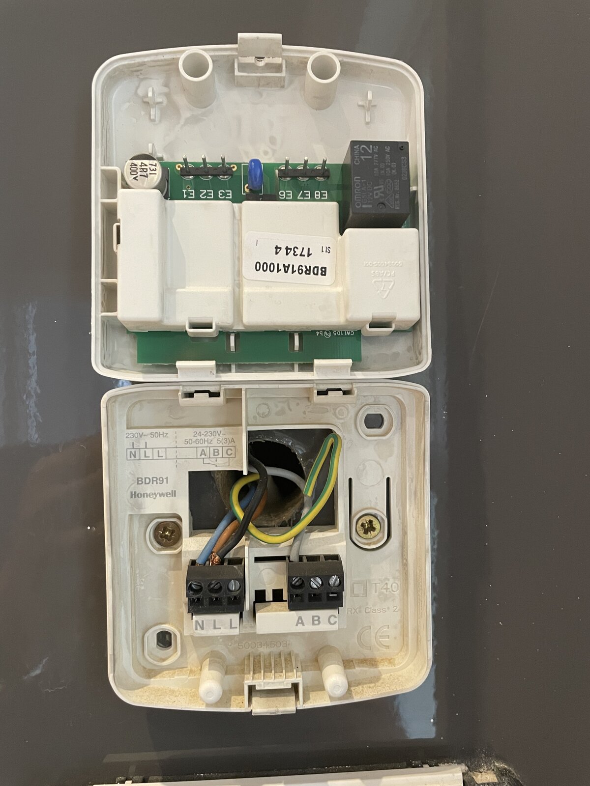

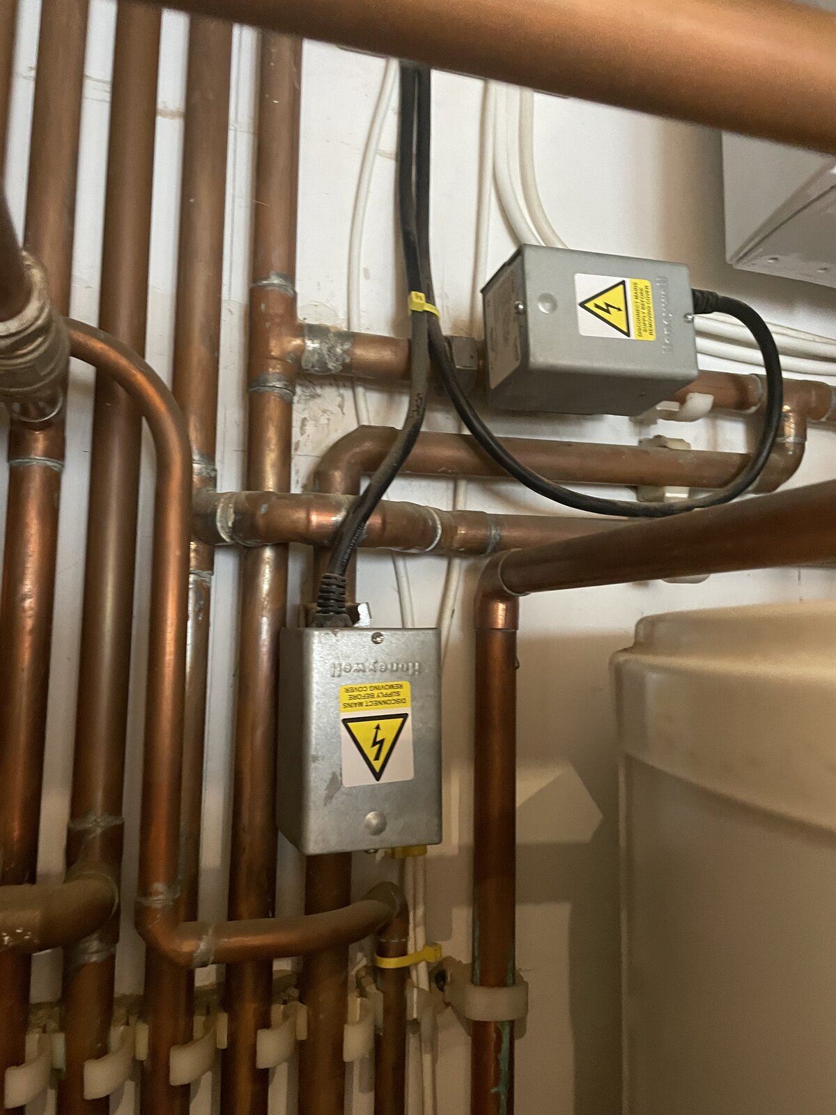

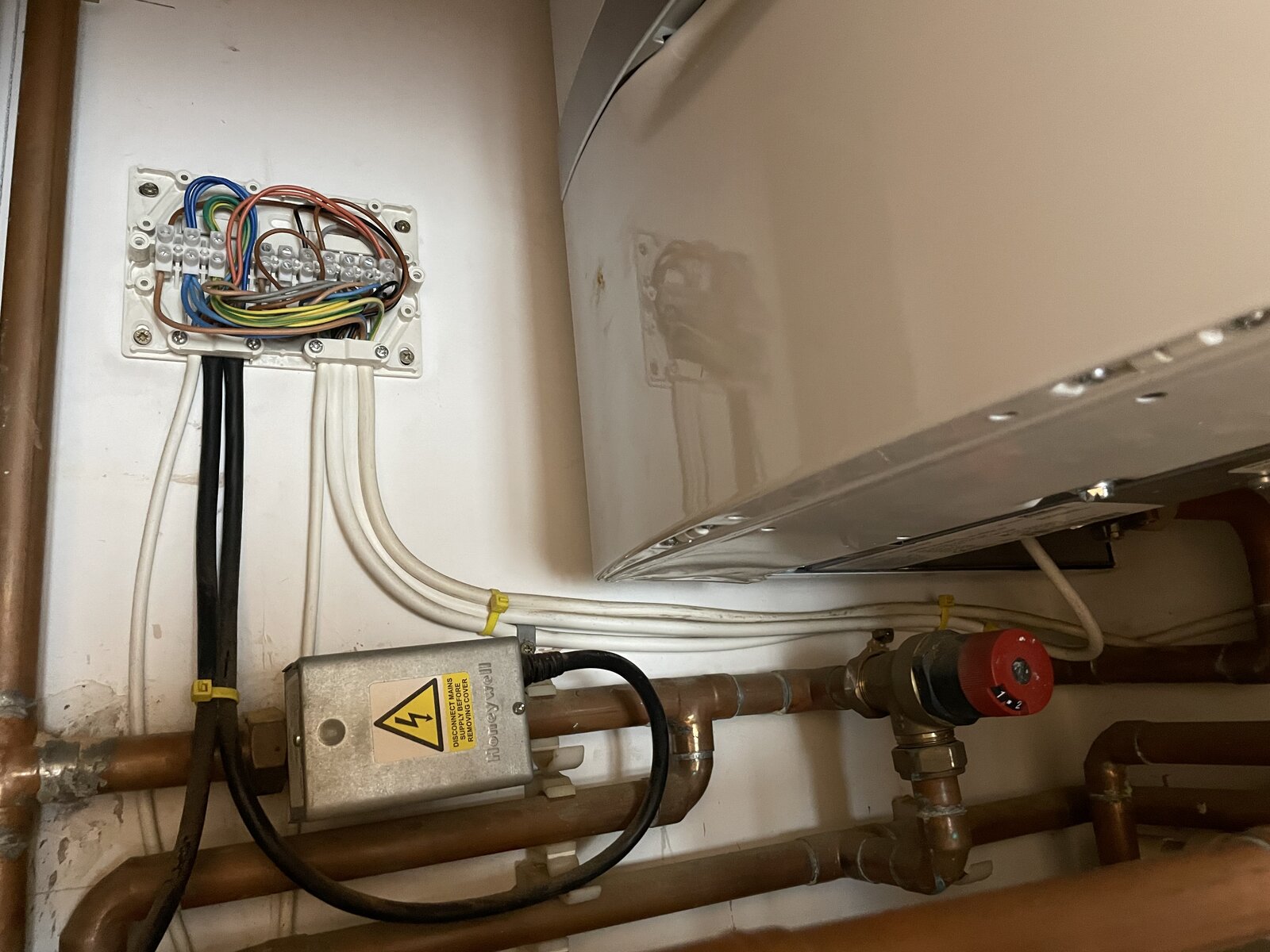

The boiler was controlled by a Honeywell evohome system. This was wired to a thermostat BDR91A1000 and a Potterton EP2 controller was attached, but the potterton didn’t seem to control anything - the boiler was on all the time irrespective of settings on the boiler. These are wired to a couple of relay controlled valves via a wiring loom.

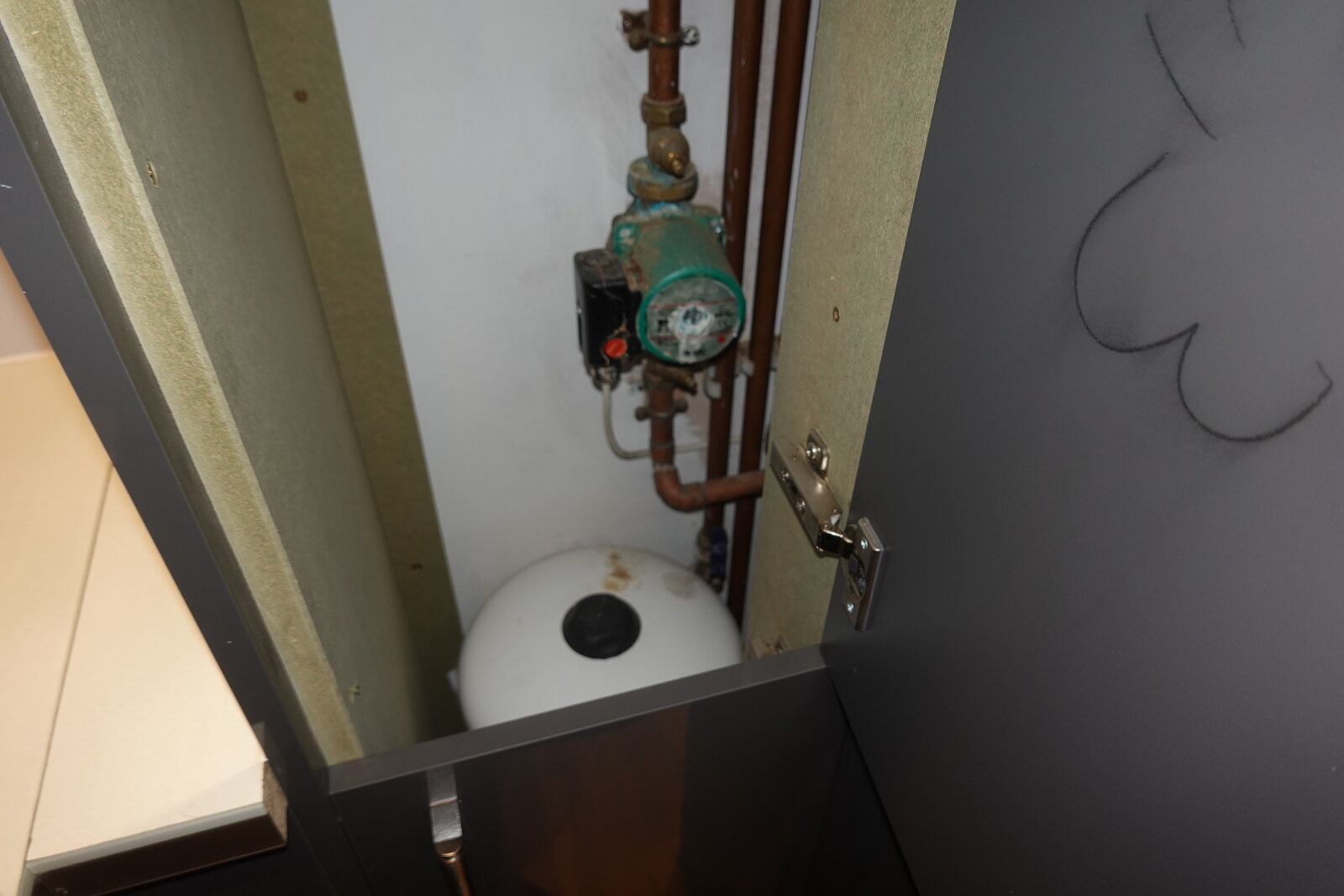

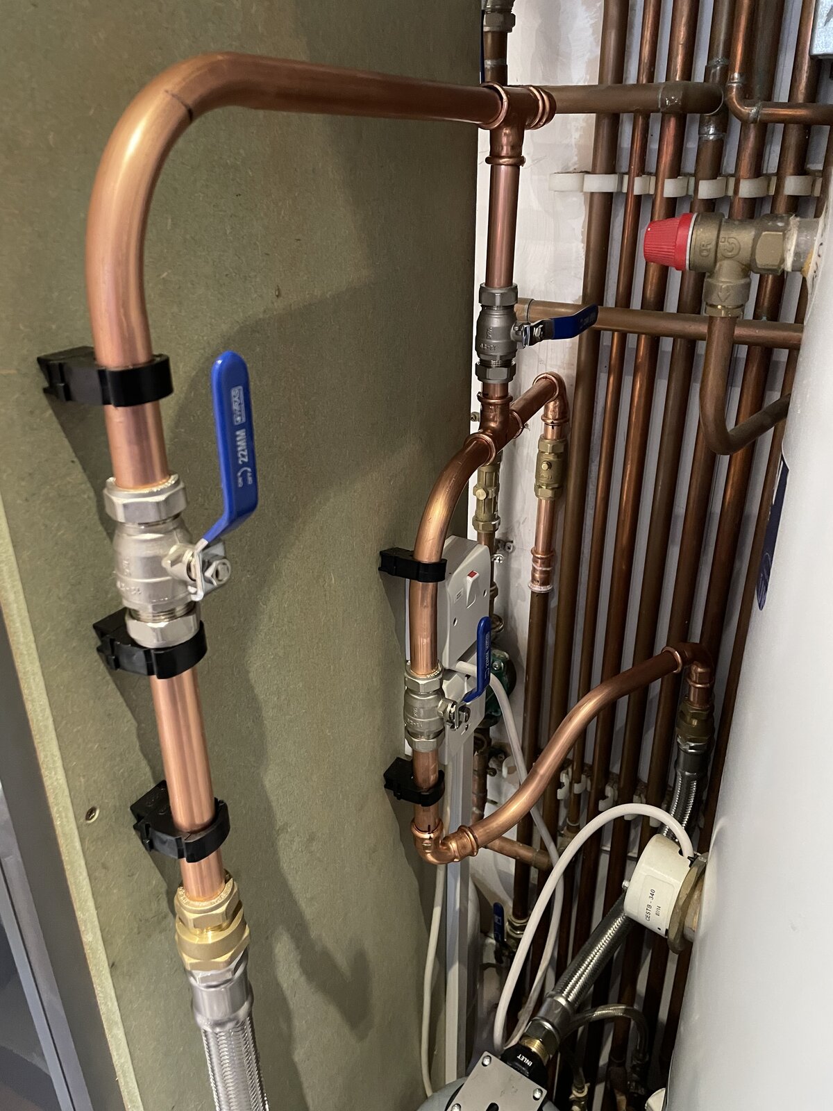

So your Potterton EP2 is the programmer. Where the hot water cylinder is situated, there should be a small thermostat strapped in place with a wire - a bit like a net curtain wire. Wiring loom? Relays? The relays may bring your hot water on. Also if you’re in need, you may have an immersion heater. A couple of photos at this point might be best.
Cylinder cupboard showing: cylinder, any valves and wiring.

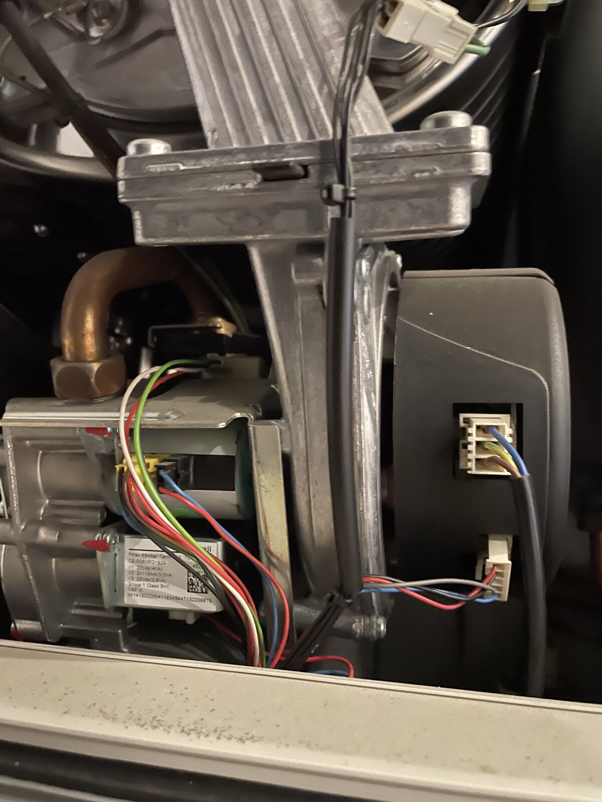

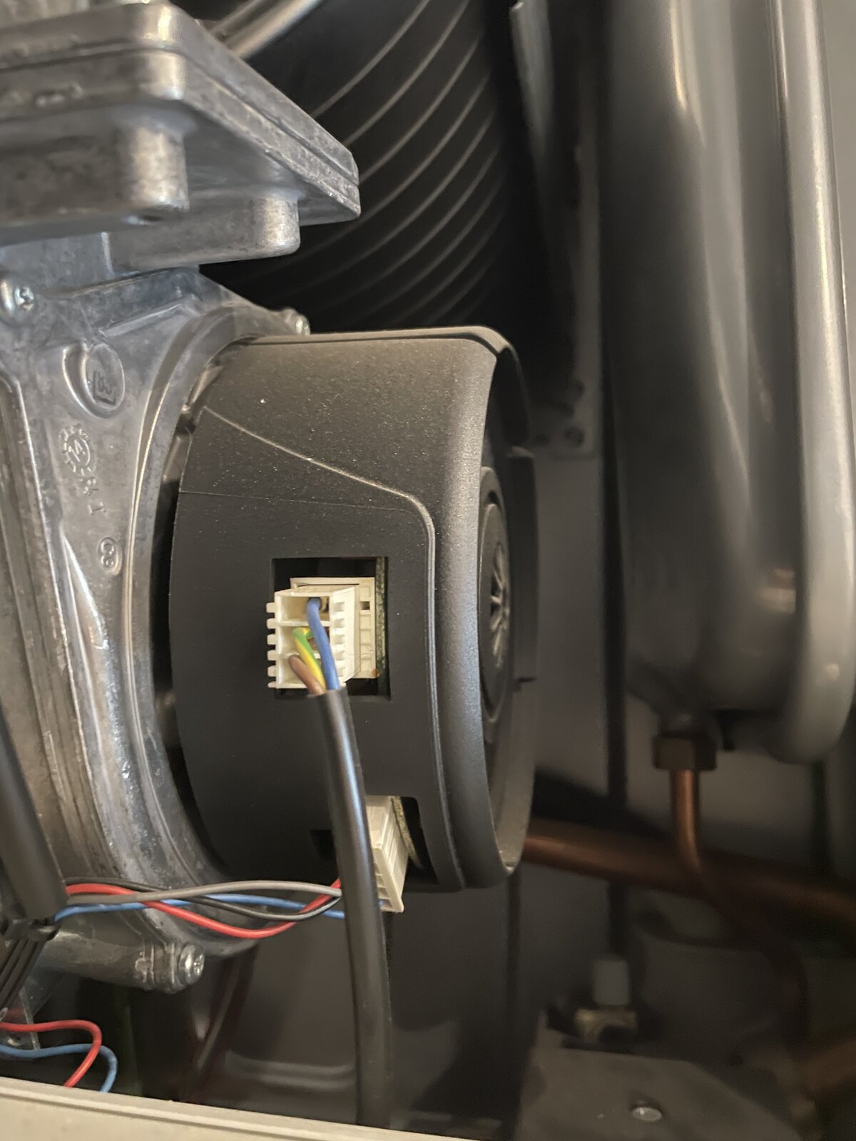

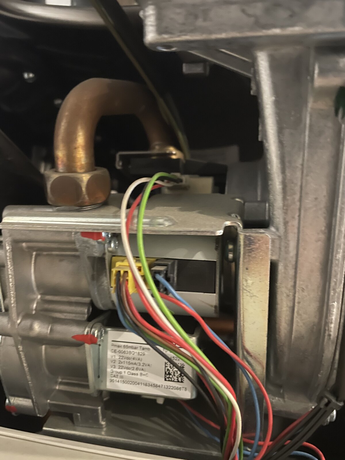

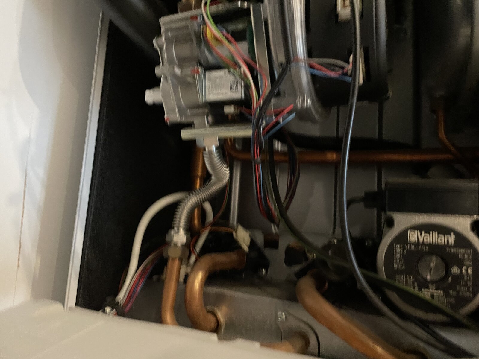

I enclose some pictures below:
The potterton unit is no longer attached. This has been replaced by a tado extension attached to the + and - terminals of the eBus as instructed by tado.
