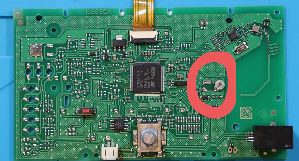

After scouring some YouTube videos, I've found a video showing the insides of a similar VRT350F.
There appears to be a very tiny PCB mounted backup battery/super capacitor (circled):
So yes, it may have a backup battery/capacitor, but it is tiny and I suspect it is only designed to provide power to retain settings for the briefest of intervals (i.e. when changing batteries).
They are also designed to be non-user serviceable and last the lifetime of the device.
...However, the battery backup question is moot!
How can a battery powered, wireless device lose power due to a mains outage? :unsure:
Was it connected with the eBus link?

Thank you RandomGrinch, form the pic it seems a capacitor, which, as you say, would only retain the settings for a very limited time.
Your question "How can a battery powered, wireless device lose power due to a mains outage?" is legitimate (and I should have thought of it earlier !).
I have the feeling that the receiving part of the 370f (the one close to the boiler and connected to the ebus) is where the data is stored, and that part is powered by the mains.
When, for example, I change the temperature setting, it takes a bit for the display to show the new temperature, as if it had to be sent to the receiver and somehow acknowledged.
I just made a test, removed the batteries from the thermostat and reinserted them after a few minutes. The thermostat initially did not show the settings, that were restored after a little while, though, (including correct date and time) I guess received from the receiving part.
So if the mains are interrupted, the receiving part shuts down and loses the settings.
