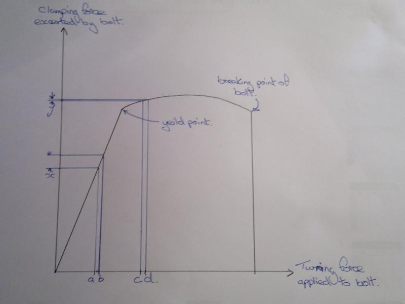

Ah thats not why stretch bolts are used, they are used because they provide a much more accurate means of determining clamping force.
When a bolt is torqued down there will be a tolerance on how much torque is applied to the bolt, namely, working tolerance of the torque wrench, manufacturing tolerance of the bolt, and what type and how much lubrication is used on the threads, so there will be a difference from one bolt to the next.
See graph below:
A non stretch bolt torqued down with a small tolerance between a & b will result in a large tolerance in clamping load x
When a bolt is tightened past it's yield point elongation of the bolt occurs(it stretches) so a similar tolerance in torque on the bolt between c & d results in a very tight tolerance in clamping load y

Well that is the thing, torquing a bolt down in the normal manner, the end result is very dependant on how it is done, when it's taken past it's yield point so long as you get it there or there about the end result will be very close to what it should be.
