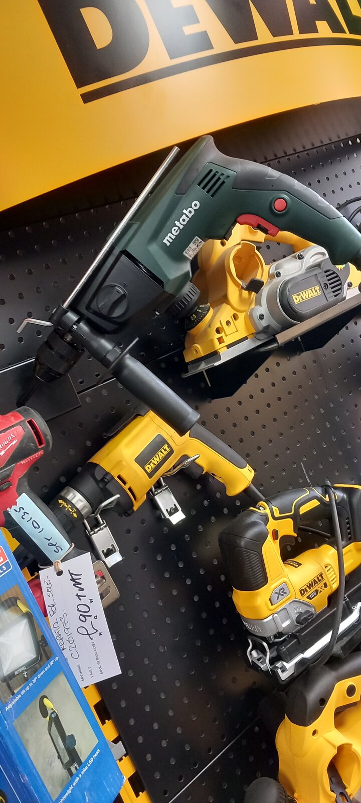

Just bought the souber DBB. The guy in shop said my 18v Dewalt codeless combi drill might not have the power for it though or would strain the battery. Recommended percussion drill like below maybe mains powered
e.g. Metabo one
TBH the guy in the shop had a valid point (or rather points) - if all you are working on is softwood or chipboard core doors, you have a top of the (trade) 18 volt line cordless drill fitted with a freshly charged 5 or 6Ah battery and you aren't trying to chop out really thick (32mm plus) lock bodies, then from experience you'll probably be OK. For comparison I often use a Makita DHP481 18 volt combi drill (2100rpm, 125Nm - model replaced by DHP486, same speed, 130Nm) in chipboard core fire doors and it works reasonably well if a tad slowly. OTOH my other drill, a lower spec DHP484 (2000 rpm, 54Nm - not too bad a spec), really can't hack it on the DBB as it hasn't got the torque of the bigger drill causing it to slow down then stall

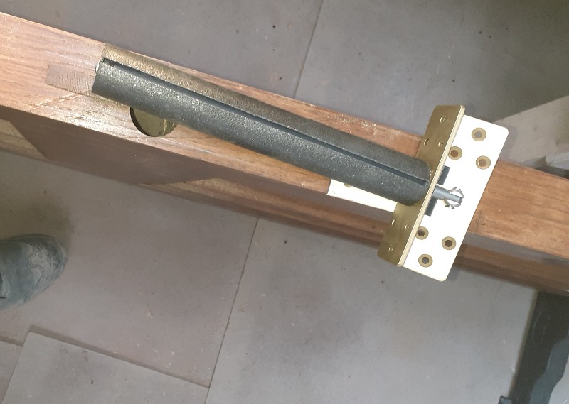

On hardwood doors, for large/thick locks (e.g DDA locks) and for deep drilling (e.g. for Perko-style door closers like the Astra 4004) you really need a large, heavy duty corded drill. My own corded drill happens to be a fairly old Bosch GSB21-2 (1100 watts, 3000rpm) and it powers through softwood and chipboard core doors a lot faster than the cordless can (2 to 3 times as fast IMHO) - but even with that drill, on solid oak doors, the safety clutch does cut in from time to time, especially if doing a job like I was on a few weeks ago where I was edge boring solid oak doors using a 32mm diameter boring bit and the long boring bar to create 290mm deep holes to take the aforementioned Astra 4004 door closers. I'd be sceptical of the cordless drilling being able to do that anywhere near as well (I have actually tried it once and the drill tends to stall or the safety clutch activates frequently - the battery also gets pretty warm)
As you can see, those closers ar big so and so's and they need to be drilled on a centre line 22mm in from the knuckle edge of the door and parallel to the face of the door which leaves only 6mm of "meat" between the edge of the hole and the outer face of the door - not something you want to get wrong on £2k oak doors or irreplaceable historic doors, and why for multiple doors like the ones I was doing the Souber jig is indispensible. On this case a special Souber offset drill guide body was used as we don't want to self centre like you'd normally do and I had enough to do to justify the expense
So, if all you are doing is fairly small basic locks into softwood or chipboard doors your existing drill might work providing your drill is high torque, has 2k rpm plus speed and has a freshly charged 5 or 6 Ah battery in good nick (and not a 5 year old clunker). You can always try it out on a piece of 4 x 2in softwood and see for yourself. But if you are doing a lot of hardwood doors you'll need the corded drill

Actually, I used my mortise gauge to mark out where the face plates of those Perkos went before using a router to hog out most of the waste - being offset and few in number I didn't want to risk effing up some very expensive doors. In any case I still chop out stuff by hand from time to time and the Souber can't do stuff like cutting out recesses gor flush bolts, etc. So not quite as useless as you think

Since purchasing my Souber, the vast majority of the few locks that I have fitted are chip board cores. My 4000 rpm cordless Metabo has been fine, but yeah, you have a good point about using it on an oak door.
The primary reason for buying the cordless Metabo was that I found my corded Metalbo to be too long and heavy. From memory it is about 13" long. I struggled to hold it level whilst using my free hand to pull the boring mechanism up and down, I also had to use my hip to apply pressure.
I struggled to find an excuse to purchase a corded drill that would only ever be used for the Souber, but I had no problem with spending £300 on a cordless, the reasoning being that I can use it for other tasks.
