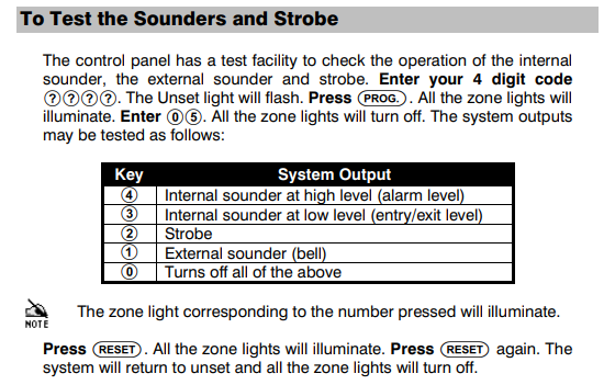

Check the sounder first using this

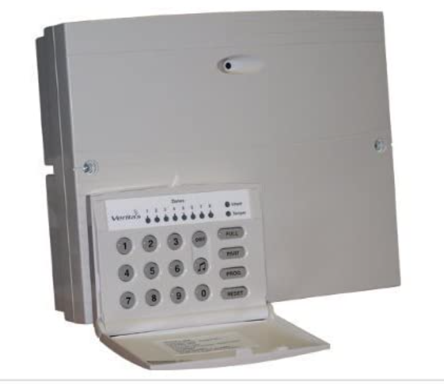

Is the veritas box the control panel or remote keypad ?

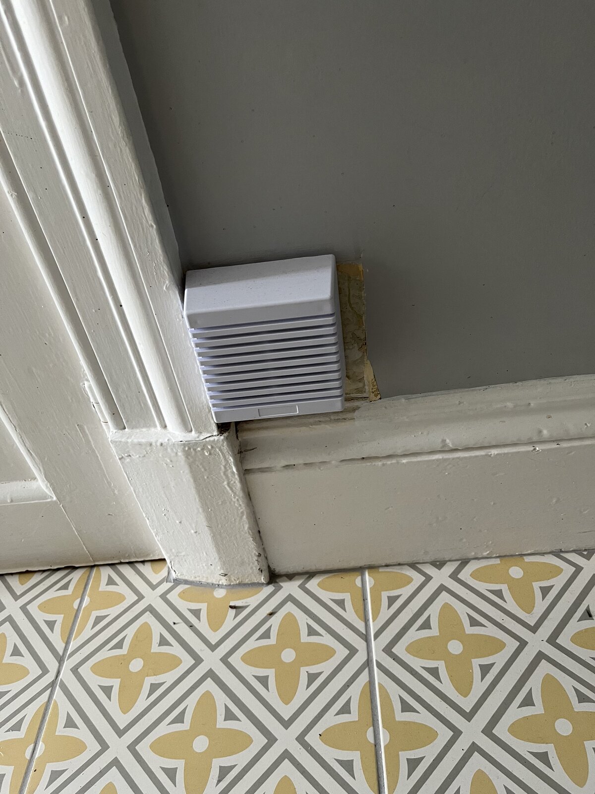

Post photo of Hall sounder
That is an extension speaker - does this sound at all such as entry / exit tones? Try the options (3) and (4) above?
Do you have this panel?

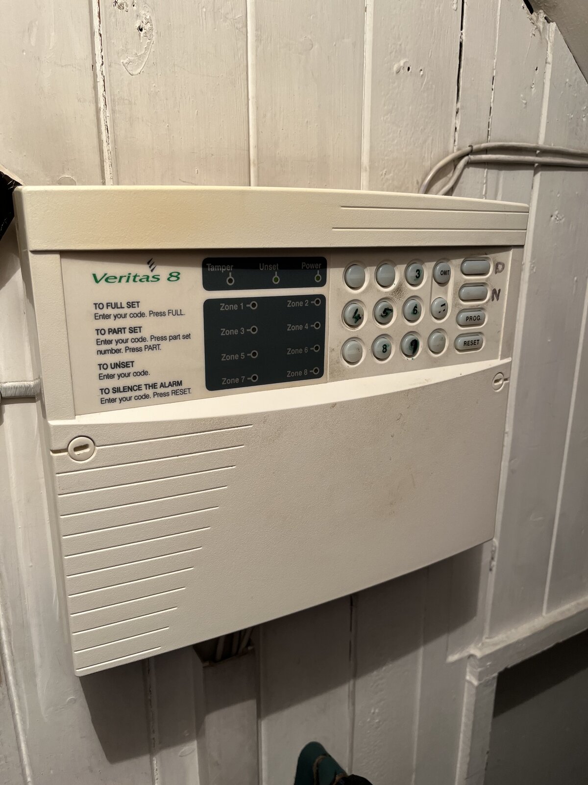

It sounds quietly on entry/exit. (3) & (4) tests are fine. Panel photo attached

check Part set alarm setting, in miscellaneous menu …. think it be in the engineers manual.
There is an option in miscellaneous 01 to turn internal sounder off in part set.
This is defaulted on in programming,unless it's been changed.
Do you have engineer code ?
Isn't that for the entry / exit tones for silent part set? I cannot see why the extension doesn't sound on part set alarm but the panel speaker does
no idea what is on and off in misc menus at default as they have changed once or twice over the last few years, but if it isn’t sounding In part set that’s where it would be turned on or off.
Wiring wouldn’t make it sound in full set but not in part set As far as I am aware on a Veritas 8.
