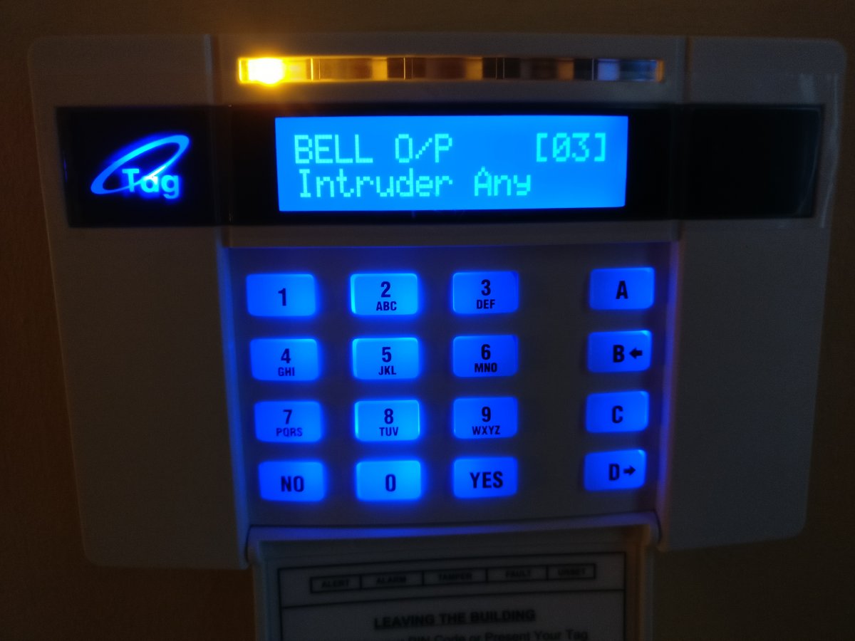

Go into programming what do you have for output 3 ? Did you change any panel outputs ?
Is that this? I can't promise that's what it had before.
Would that cause the immediate alarm when trying to set if it was wrong? I started the panel and defaulted it with code 2000.
Also confused as to why the bell test wouldn't sound the sounder.

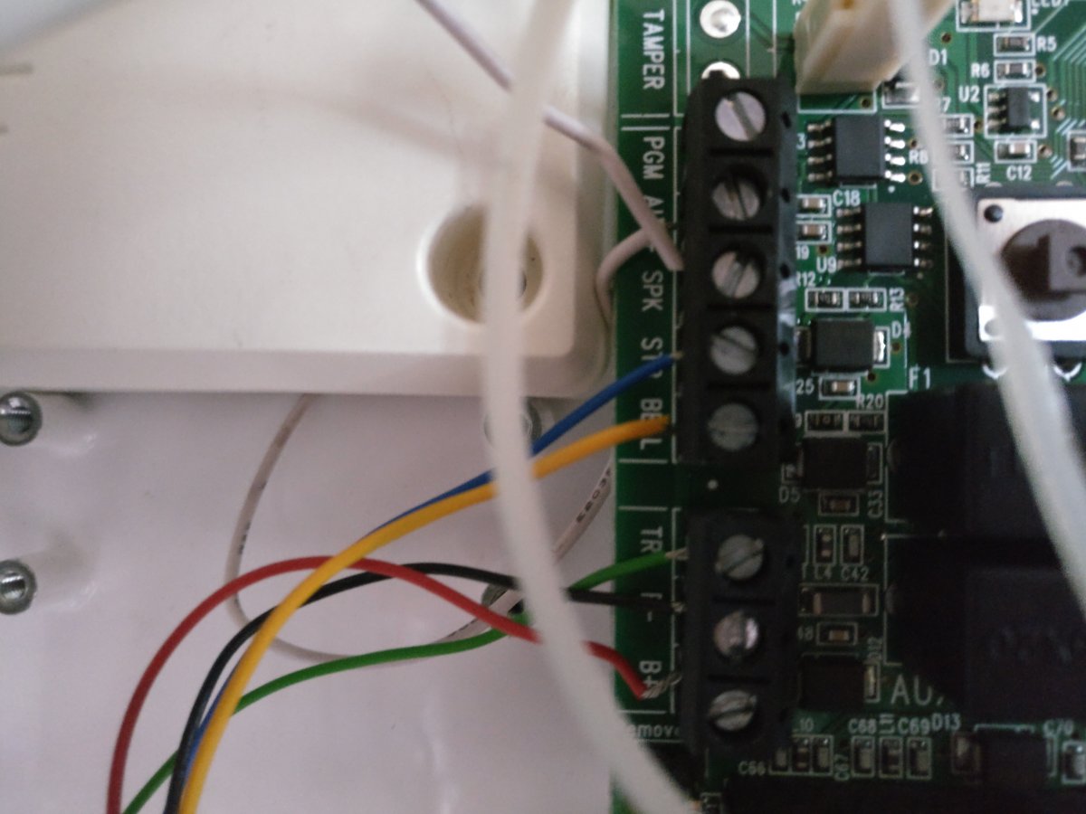

Here's the SAB wiring panel side. From my notes before
Red +12v hold
Black 0v hold
Green Tamper
Blue Strobe Trigger
Yellow Bell Trigger
This was as wired in the previous panel. Measuring direct on terminals between red and yellow during siren test get about half a volt, seems that is always there.
When the siren test is running can measure 13v or do between red and blue though. That normally reads nothing at all.
Do you think that output been set wrong (I think it was) would affect that too as well as setting? I won't try again tonight as it's getting late to annoy the neighbours.

That looks ok , take out the yellow wire and touch it onto 0v , bell should ring

I can't open the SAB as I don't have a set of long enough ladders to do so. It was sounding on full alarm before the panel change though and definitely using the same wires as before.
Should I not be able to detect a voltage between permanent hold off and bell trigger during the siren test as there was no change during test?
Let's say that output was totally wrong (and I think it was) would that change the siren test? What is output 3? Is that the SAB connections? I have inputs on all zones except zone 1. All zones show as closed unless I walk past a sensor, when it opens.
