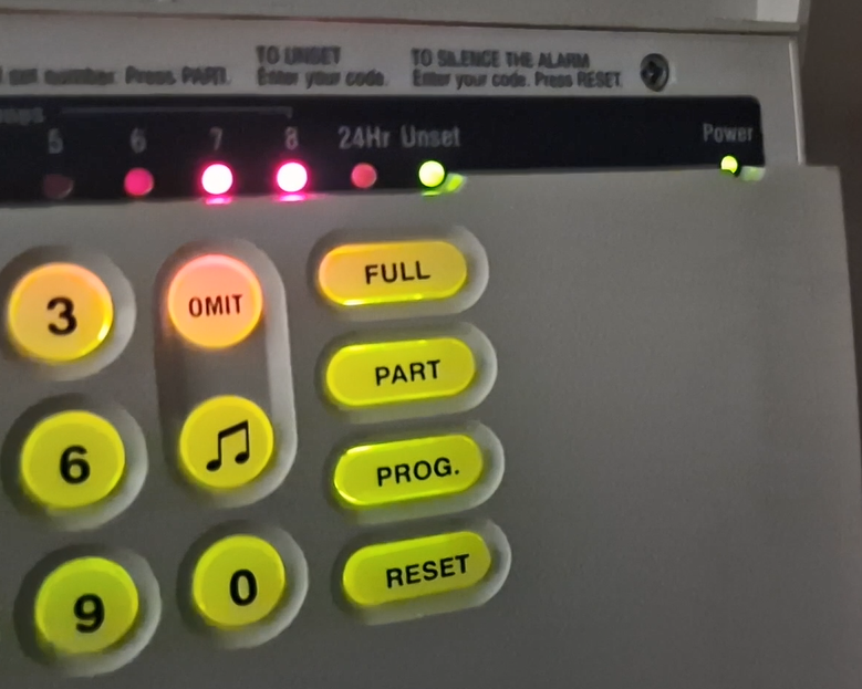

My veritas 8c alarm panel keeps beeping (8 beeps) since we had a power cut/surge
- zone 7 & 8 lights are on

That indicates zones 7 and 8 are active normally.
So what’s on zones 7 and 8?

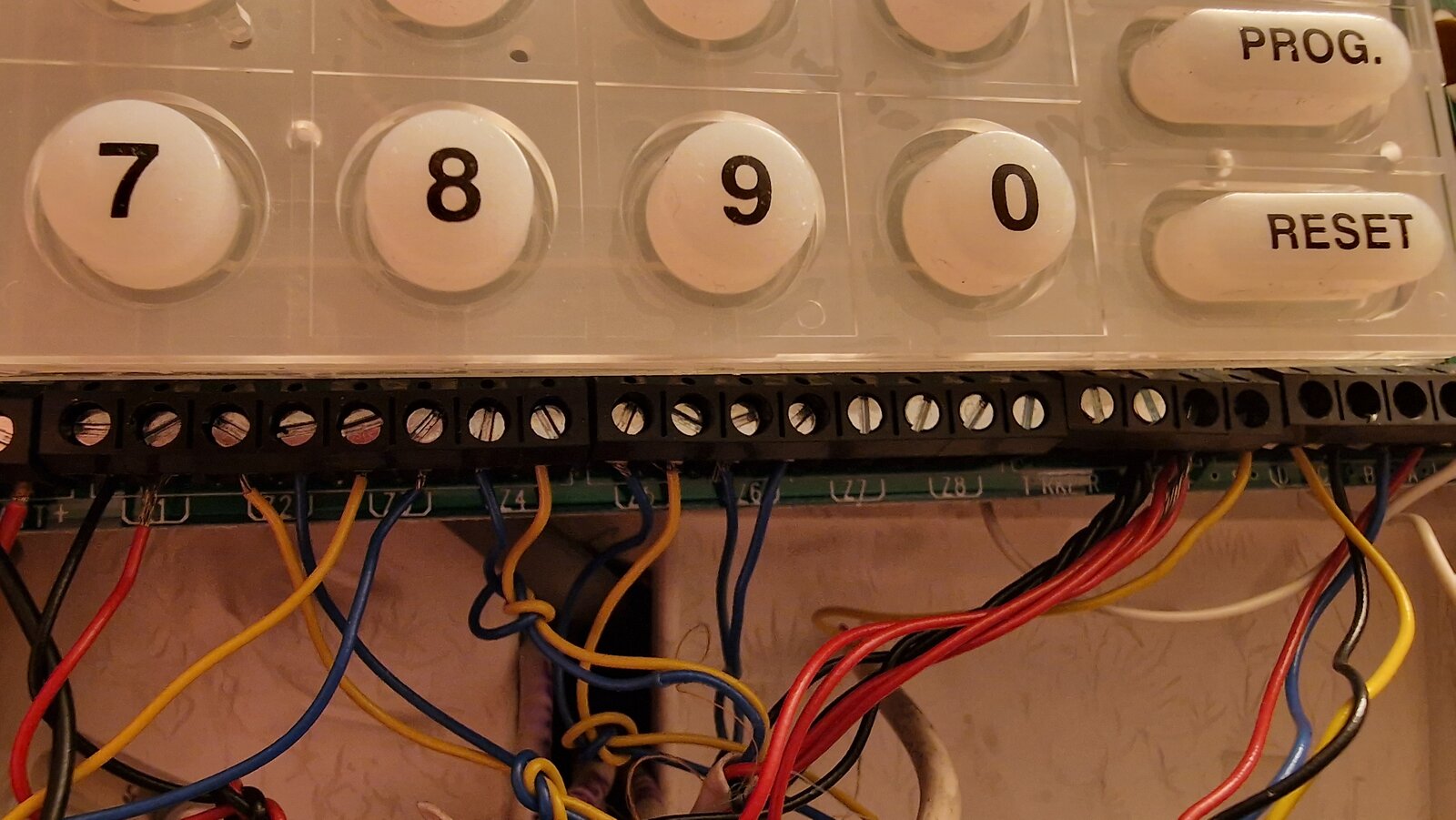

If you link them out do zones 7 and 8 go out?

OK so I managed to reset the panel by pressing the tamper spring 3 times and entering code 4321.. This resets the alarm.. However when I now try to set the alarm the beeping comes back and zones 2, 7&8 light up! I tried omitting them but that doesn't work... I conducted a walk around test and all zo es were fine apart from 2 so how do I fix the sensor?
So when you try to set the alarm now zones 7 and 8 no longer light up?

agree easiest way is to link zones out 7 & 8
