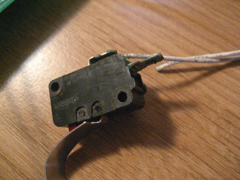

It always turns out to be the micro switch.

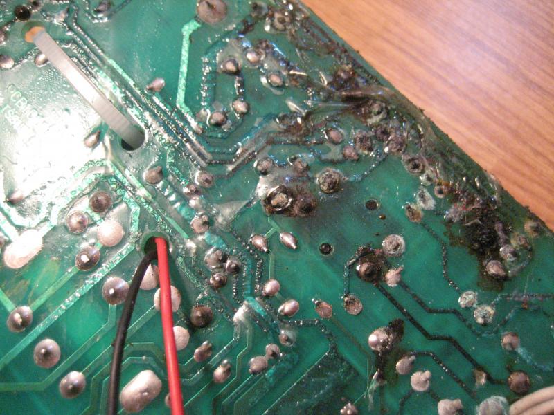

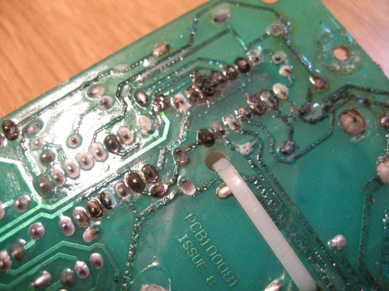

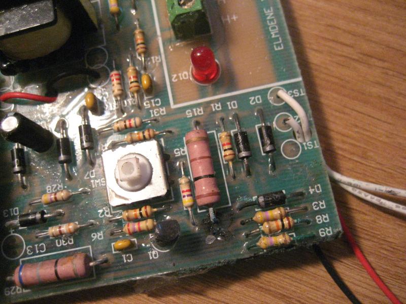

Could not see a TR or 0v in the panel, could see a "T" and a "R". Opened the bell box, not a pretty sight. See pictures below, looks like there could be a few dry joints on there, hoping to get them soldered in next hour. Had my fluke on the micro switch and was getting conductivity in both the open & closed position, tried it again then got nothing, thought it better to remove the PCB and give it a clean. The wire came off the switch on removal, is the switch in the normally open or normally closed position when in situ? will clean with switch cleaning lubricant also.

If I link TS2 & TS3 on the microswitch, will this bypass the tamper facility?
Markings on PCB are - PCB100081/issue 8

Hi Ottosump, yes linking the two wires together will by-pass the tamper switch. The tamper circuit is just a N/C loop
Looking at the other photo's it would be worth replacing the sounder, I would reccomend a Texecom Odyssey sounder to keep things simple.

first thing change battery, the external bell " may " have a nicad fitted inside it may be faulty they sometimes split. the panel may be trying to charge a faulty battery in the bell box ive seen it before and it can pull the voltage down to around 5-8volts and this could be causing the erratic sounds or it could be water damage.
as stated water damage replace bell box
I strongly agree with SandyLyon, one look at the PCB and in the bin it goes.
Of course if you want another problem in the near future .........
Seriously, it's really not worth messing about with a soldering iron, a new box will look good too.
