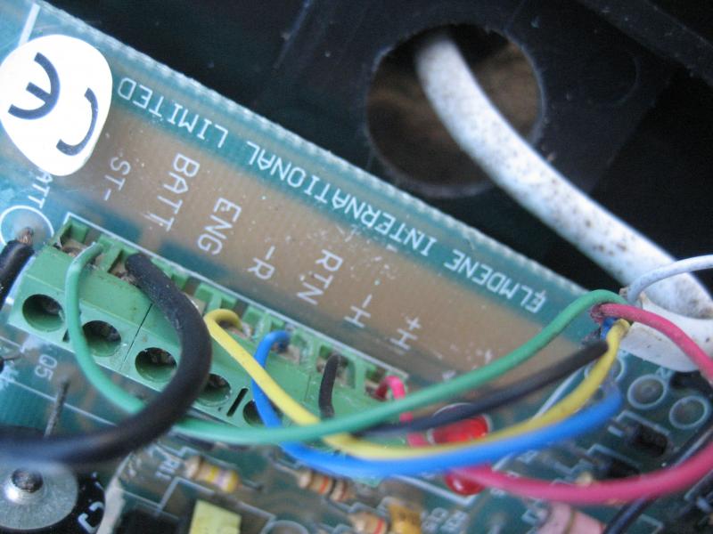

Hi group, got round to fitting the new bell box today, however I noticed that the wiring diagram is labelled differently, I've included a photo below for the old bell box which I am replacing with a Texecom premier E, the connection terminals on it are marked as Strb (S) 0v (D) Tmp (C) Bell (B) +12v (A) Any advice would really be appreciated as our house move is bearing down upon us.

The wiring couldn't be simpler on your main panel you will have terminals marked A B C D S on the Bell Box you also have terminals marked A B C D S you just connect like to like (A to A, B to B etc)
So if you have a pink wire connected to A on the main panel then connect the pink wire to A on the Bell Box and so on.
Oh, right I'm with you now, back up the ladder I go, just before I do, do I have to set the jumper for the battery to on before I finally refit the cover.
Regards Otto
Job completed, apologies for the delay, just got my broadband back on, BT are useless. Anyway, bell box fitted and working fine, new owners didn't even notice.
