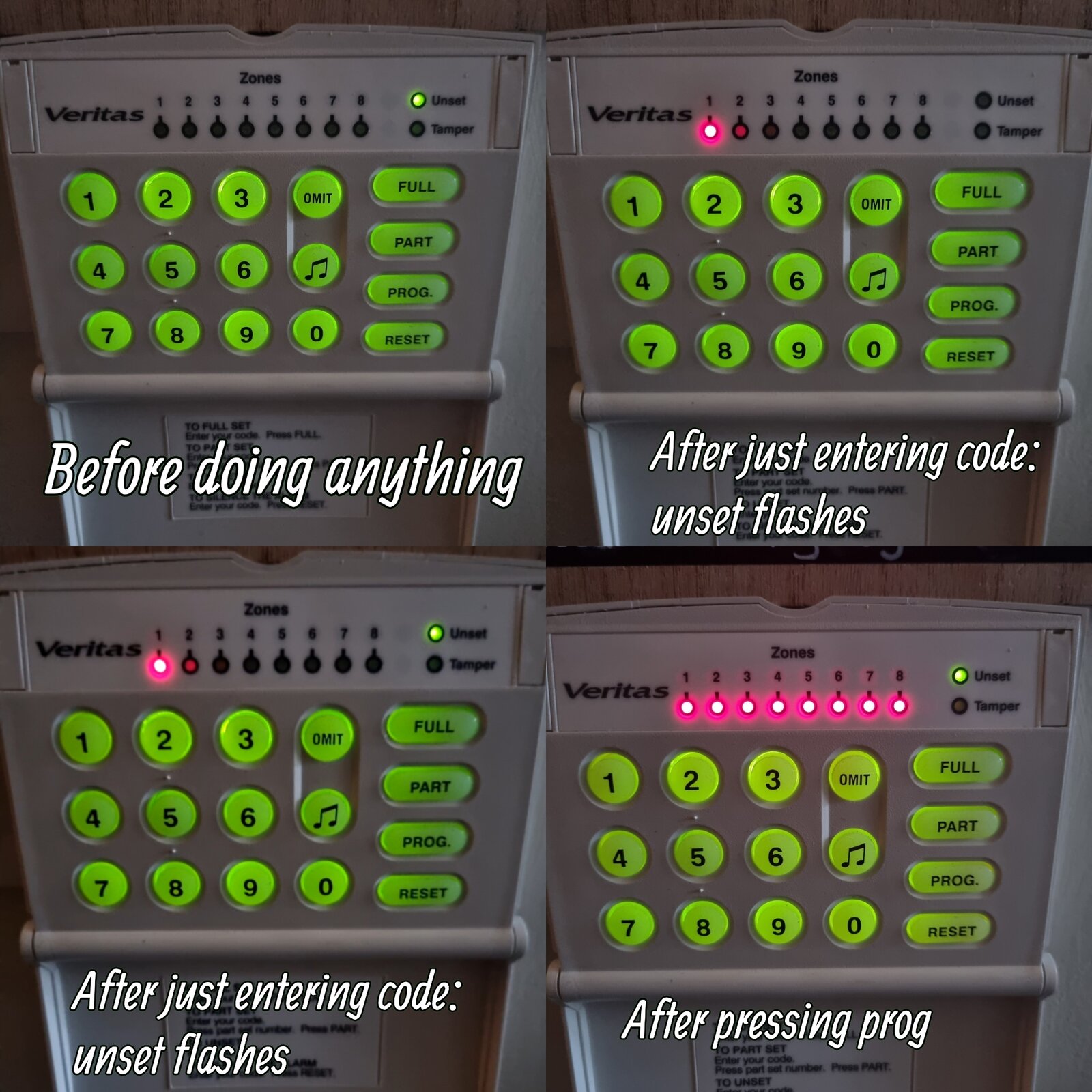

Hi
Bought a house with a Veritas R8 alarm. Seller just left us the default code. 3 PIRs in house down as 2-4. We tested it, seemed to set and work fine, then changed the code.
Now when we try to set the alarm, it wont work and zone 1 is lit up and beeping.
What is confusing us is we don't know what zone 1 could be as we only have 3 PIRs and they are down as 2-4.
Grateful for advice, thanks.

Here's what happens after taking the action you advised, @secureiam :
Also, worth me saying it does the same on those steps when I enter "1234" and then also when I enter our personal code. Doesn't do anything with "4321" (they were both codes we were given)
You have to press either FULL or PART after your code OR if quick set is enabled. Pressing just FULL will set the system RESET will cancel setting before it has armed otherwise your code unsets it

If zone one is faulty you can program that off and use a timed exit (veritas is usually set to a timed exit.
And if you have a pir in the hallway usually zone 2 that can be. Hanged to e/e.
Then when you get a replacement door contact you can change it to how it should be.
Do you have anything on the door and door frame?
With all the lights illuminated press 06 prog and you will be in walk test, if zone 1 light is permanently lit than that zone is active and as mentioned before it is likely to be a faulty door contact. Press reset repeatedly until you exit to day mode.

Zone 1 normally, but not always, is the entry / exit zone and more often than not it will be a simple door contact.
Seen this a few times, replace the switch and magnet, or you could link out zone 1 just as a check.
