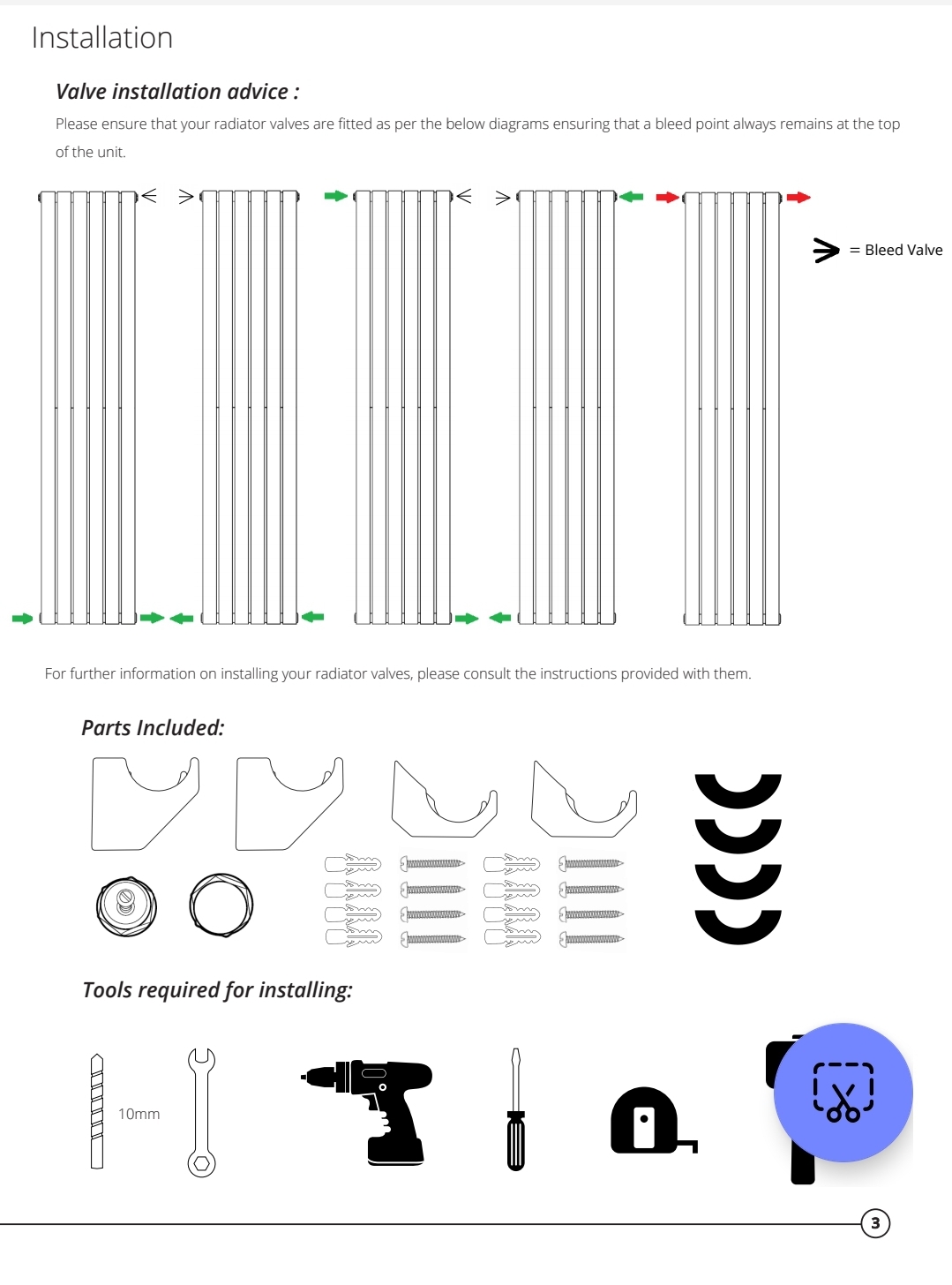

Hi, ive tried this and it still takes a while to heat up, water goes up the first panel but then takes ages to warm the rest of the radiator and the bottom half never really gets mega hot compared to the top.
Its fitted the correct way aswell, no mention of needing baffles or anything in the instructions.
Its a milano alpha vertical radiator.
As it will not heat fully when it's the only rad in use ,there is either a fault with the rad,it's valves,the pipework to it ,or the flow is not connected to the specified inlet port.

Flow is connected to the correct port ive checked the diagrams.

The rad can be fitted multiple ways, ive looked at the instructions, the flow goes in the bottom right and out bottom left and bleed valve is top left, that is 100% one of the ways it can be fitted.
Show
What are the dimensions and rad output? All rads heat up by convecting upwards through the first 75/100MM or so, or in your case up through the first column, the water then moves horizontally along the top and flows downwards, losing temperature and giving up heat, I will post a few readings later I took off one of my own rads (conventional). Not sure if you have a TRV on this rad?, if so remove the head and ensure the pin is out.
