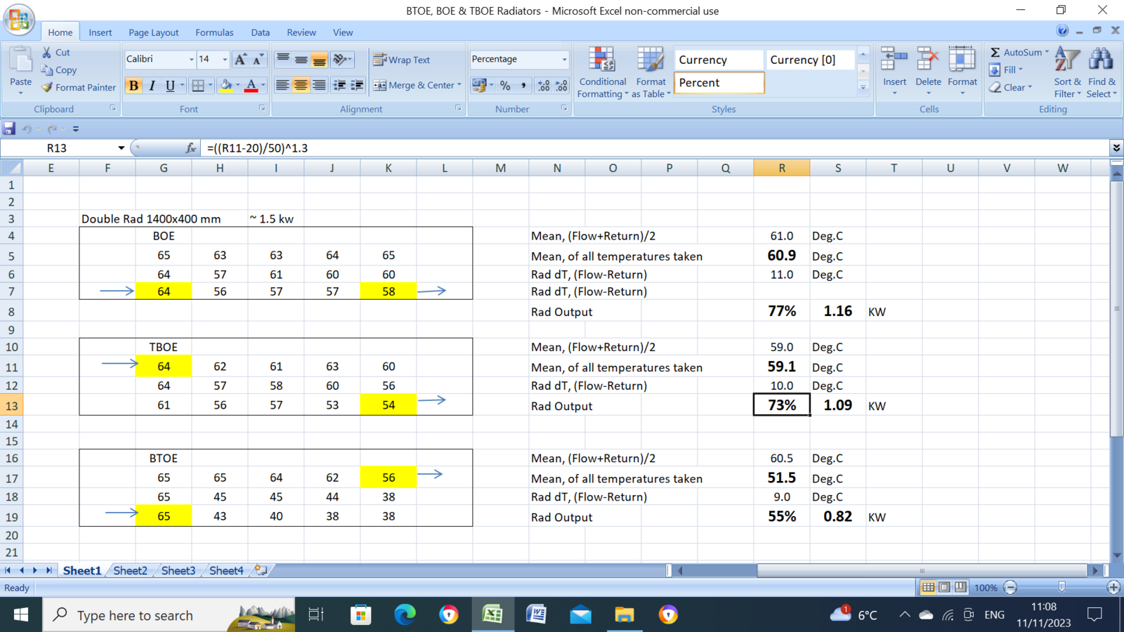

What are the dimensions and rad output? All rads heat up by convecting upwards through the first 75/100MM or so or in your case up through the first column, the water then moves horizontally along the top and flows down wards, losing temperature and giving up heat, I will post a few readings later I took off one of my own rads (conventional).

5000BTU=1.47kw, flow/return temps of 75C/65C would require a flowrate of 2.1LPM, even if the flowrate was only 1.0LPM (shouldnt be a problem for 10mm microbore tails) then you should get around 1.28kw with flow/returns of 75C/57C.

You should still get 0.88kw at a flowrate of 1.0LPM but the return should be over 47C, (quite hot), with a flowtemp of 60C.
Is the whole system 10mm or are the main flow/return pipes bigger, if so what roughly is the total length of 10mm flow & return piping to that rad?. 10mm piping has only a ID of 6.6 to 6.8mm but if the combined length from the rad is 5M then the head loss is only 0.27M anf if its 10M then the head loss is 0.55M.
