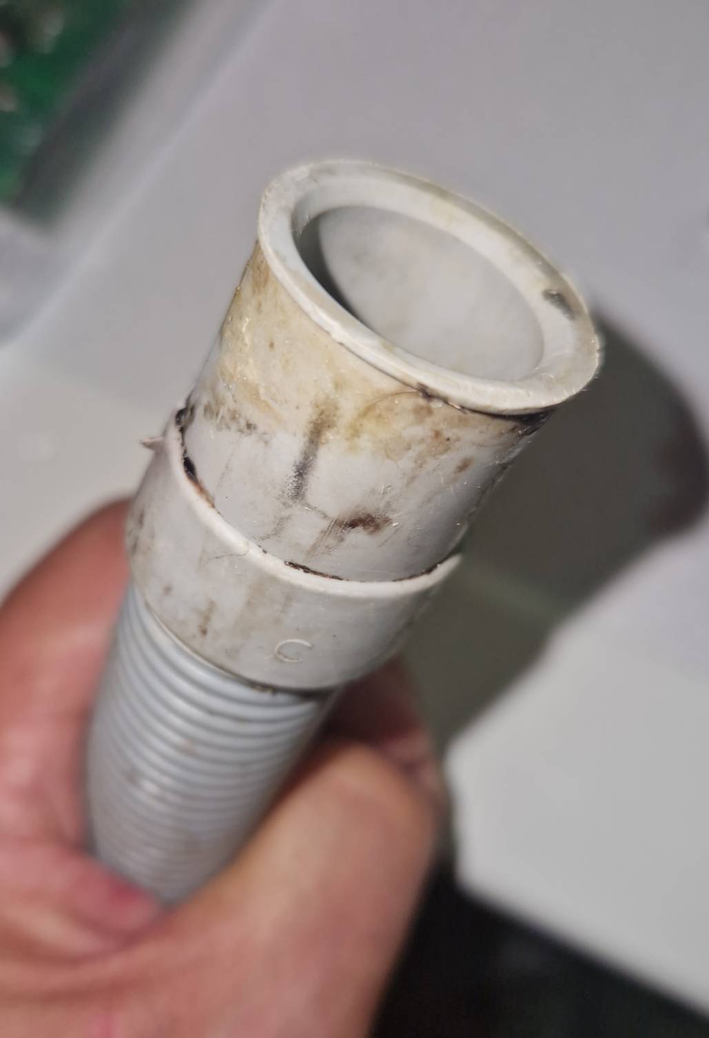

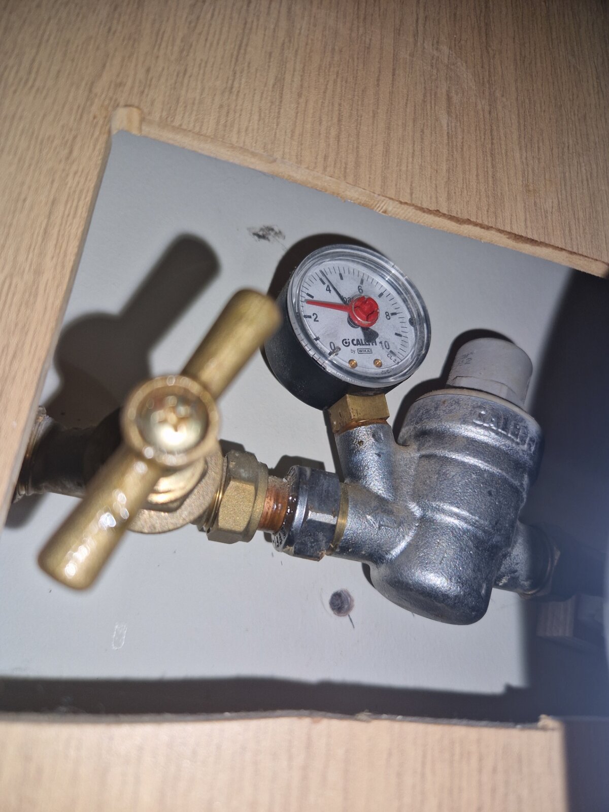

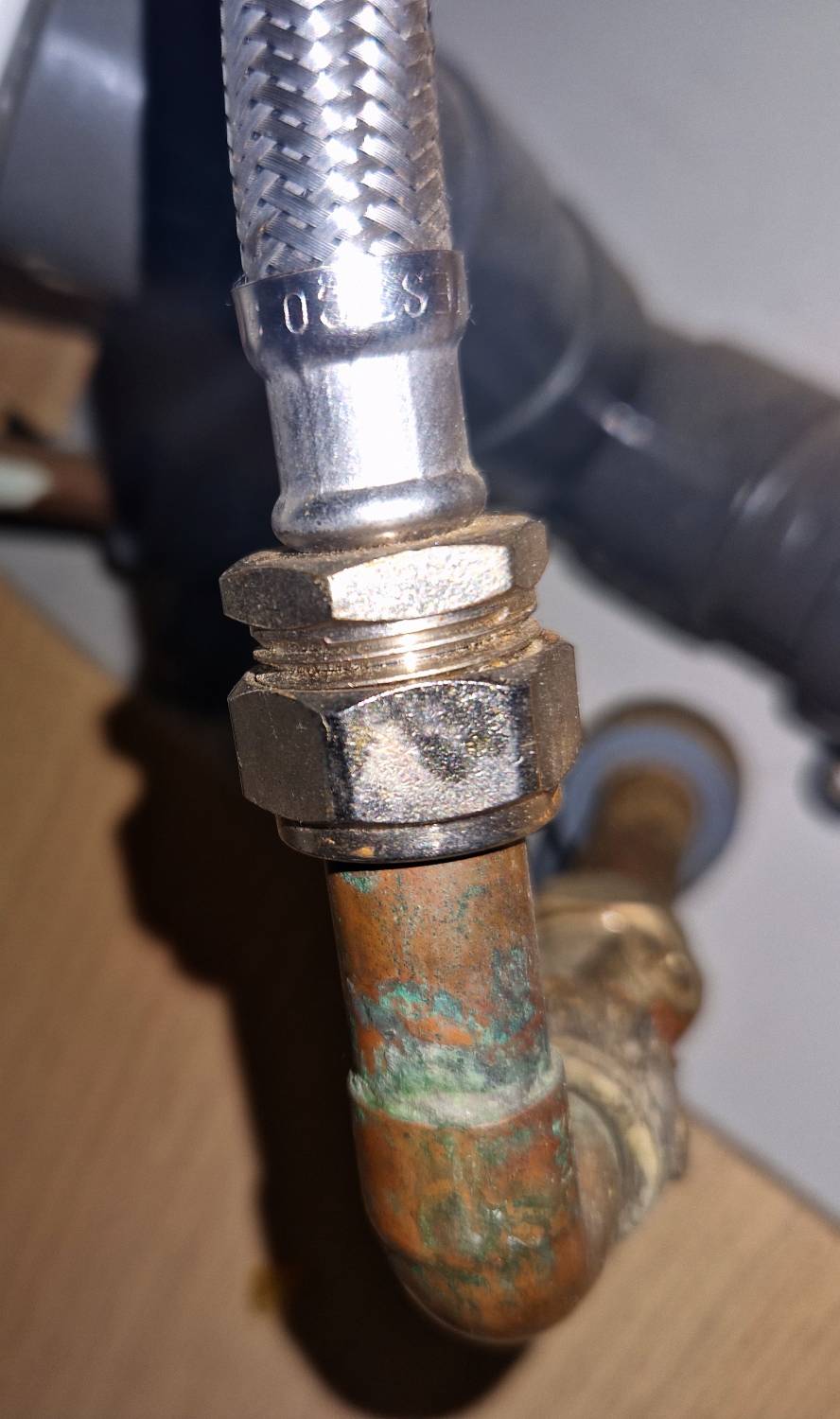

I live in a flat with a tiny kitchen too small to install a washing machine, and no doubt has never had one. I plan to install it just outside the kitchen, pipes that came with it seem just long enough, although in-time I might get slightly longer ones to make routing easier.

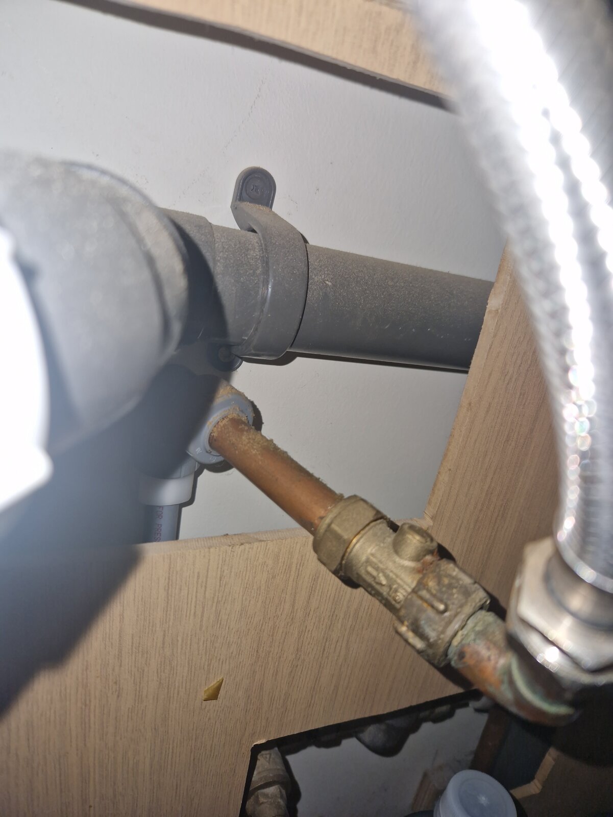

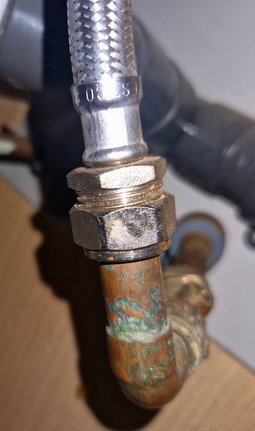

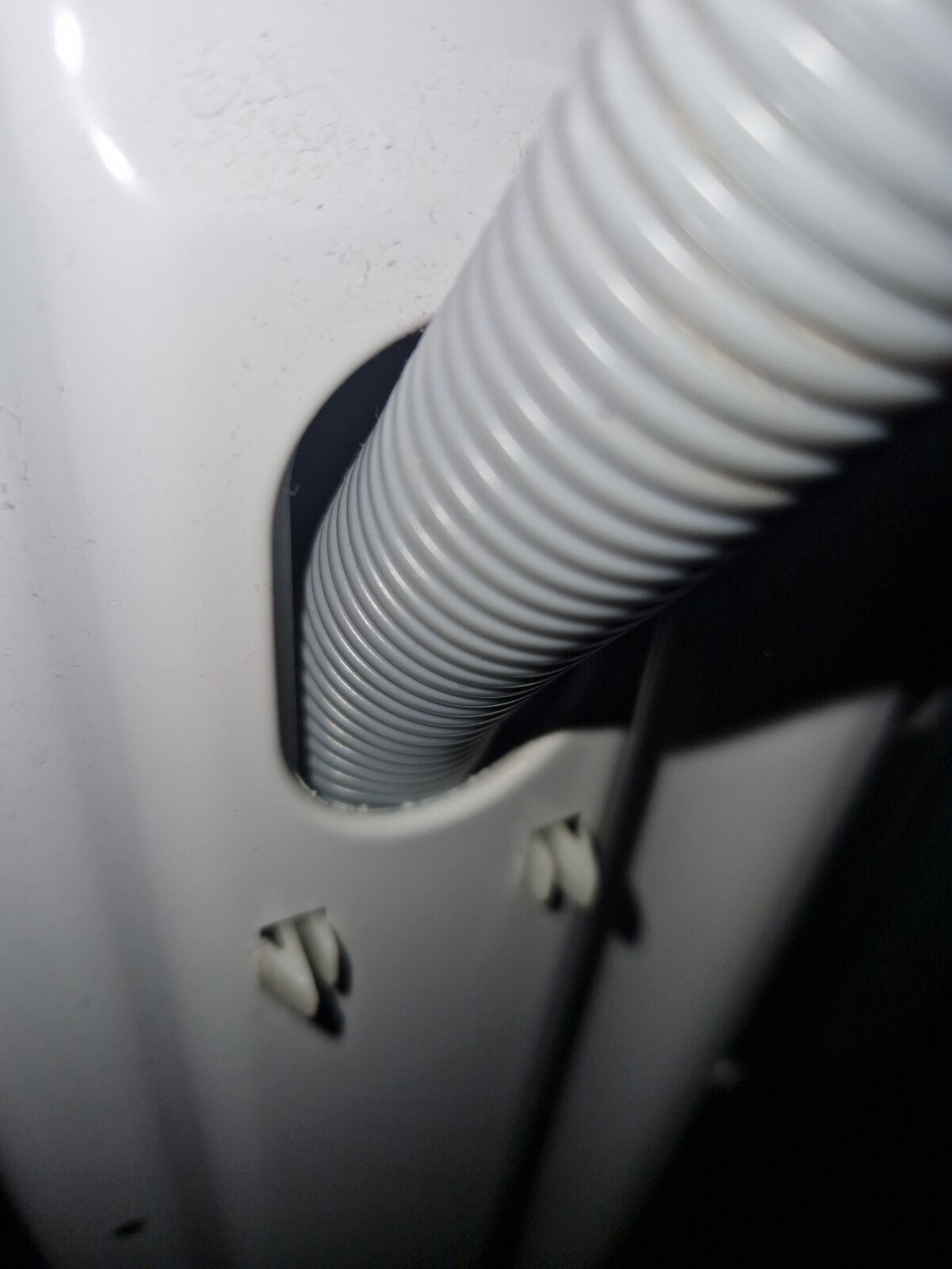

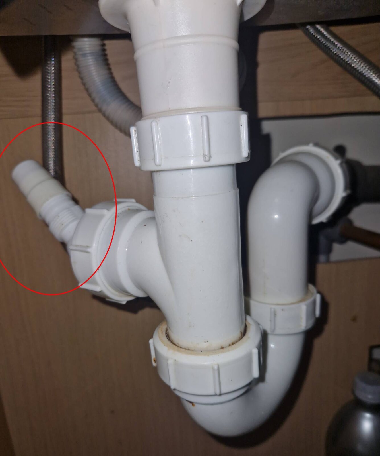

Under the sink there seems to a free doobrie to take a washing machine outlet, see red circle in picture 3. I'm guessing this is fairly straightforward; remove/unscrew plastic cap, pop on pipe (looks about the right size, see pic2). secure with a jubilee clip for safety. Although I'm slightly concerned about siphonage.

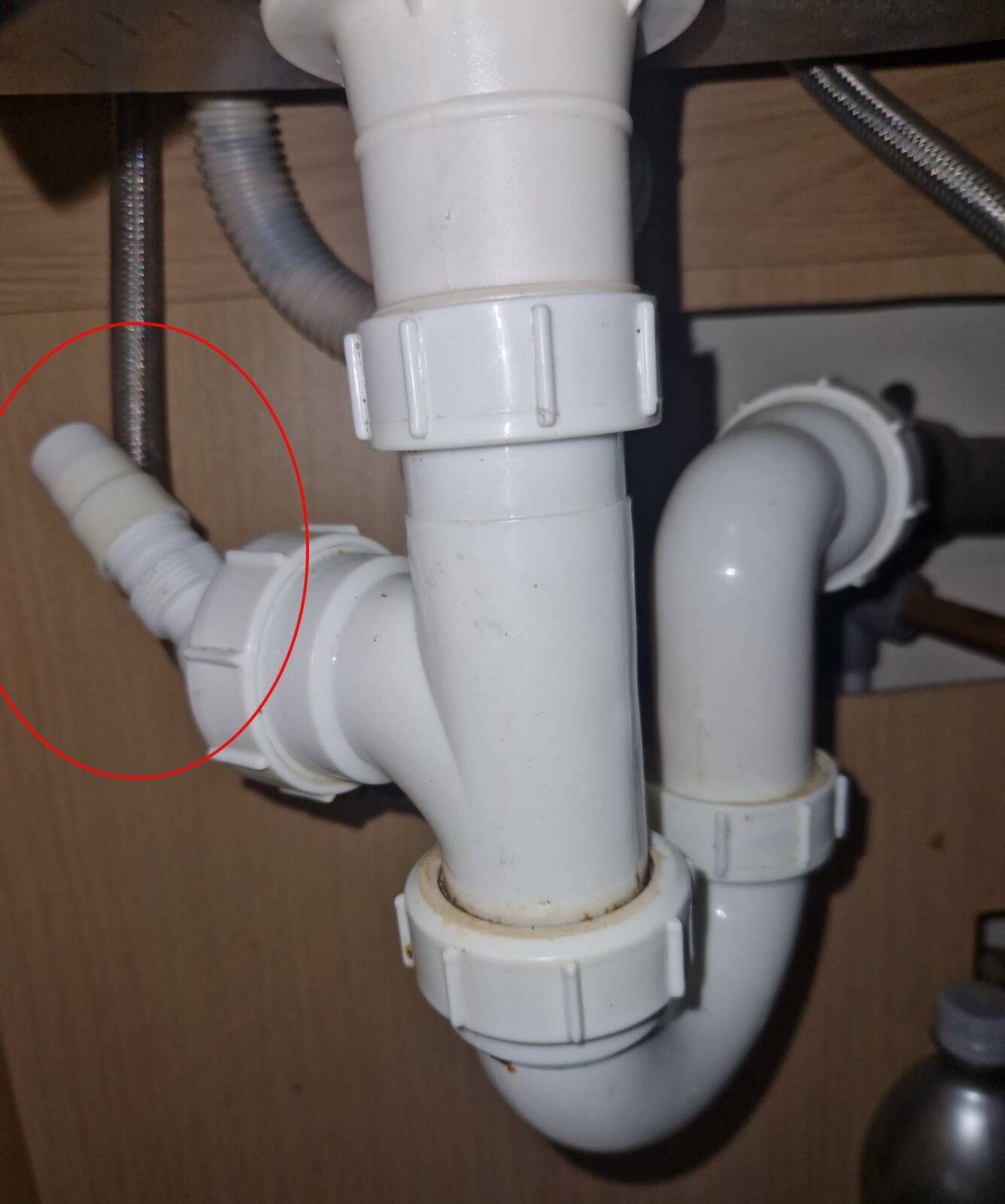

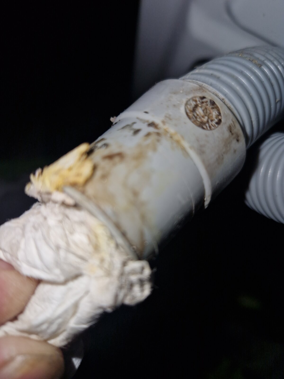

Of greater concern to an inexperienced fool like myself is the inlet, where mistakes get really messy, really quickly ;) My guess is, water off turning screw 90 degrees that's just behind the junction in pic1. Check it's off and remove pressure/some water by operating tap. Then I'm a tad hazy... I'm assuming I can't directly attach a T junction connector like pic4 directly, I'll need a very small bit of copper pipe? Would I be better off using plastic fittings?
Any advice very welcome as I've gotta do this soon, I'm outta clean undies.
Basically, yes, but to prevent siphonage and back flow, the drain pip from the washer, would need to rise up on its route, to a higher level than the highest water level you might ever see in the sink.
Yep, turn screw 90, turn the tap on, and ensure the flow has stopped. Then undo the joint between the silver flexible, and the copper pipe. Have a bowl and rags to hand, to catch what leaks out. You should then be able to insert the item in your fourth photo, in place of the silver pipe, Add a short piece of copper in the upper end of that, then reattach your silver pipe.

So I need a short piece of copper pipe between the copper outlet and the item in the 4th pic? (which is a pain as I can think of a way buying 50cm of pipe (time for skip diving, perhaps!)
It's about £8 for a 2m length of 15mm copper pipe so probably not worth investing too much time or effort in finding an alternative source of a small piece, you'd then have a decent bit left over for any other future alterations.

Unless you can find an alternative location, where you can cut the pipe, avoiding the need to buy any 15mm?

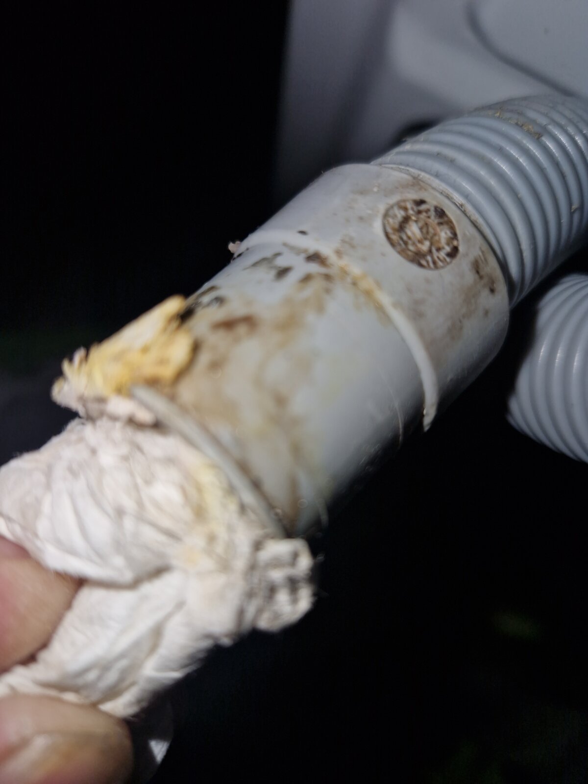

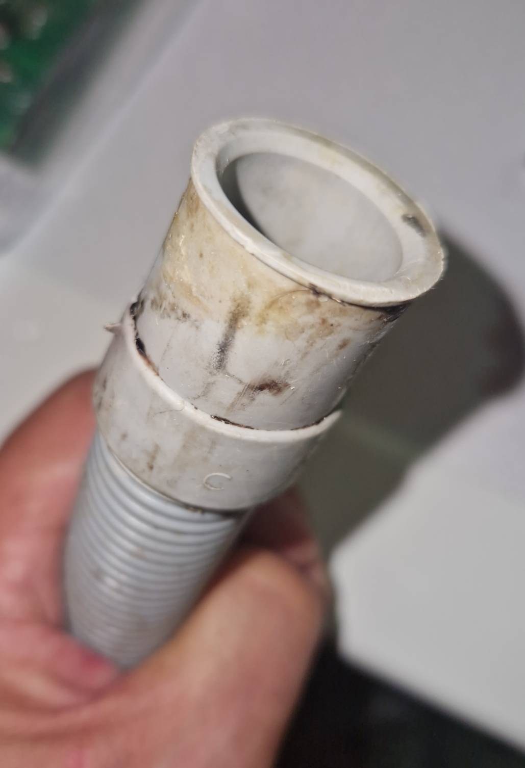

I've decided to increase the length of the inlet/outlet to make things easier & to be sure I can achieve the height of outlet hose you gents have advised. Inlet straightforward, outlet less so as it has no rear connection outlet, as such. See attached pics.

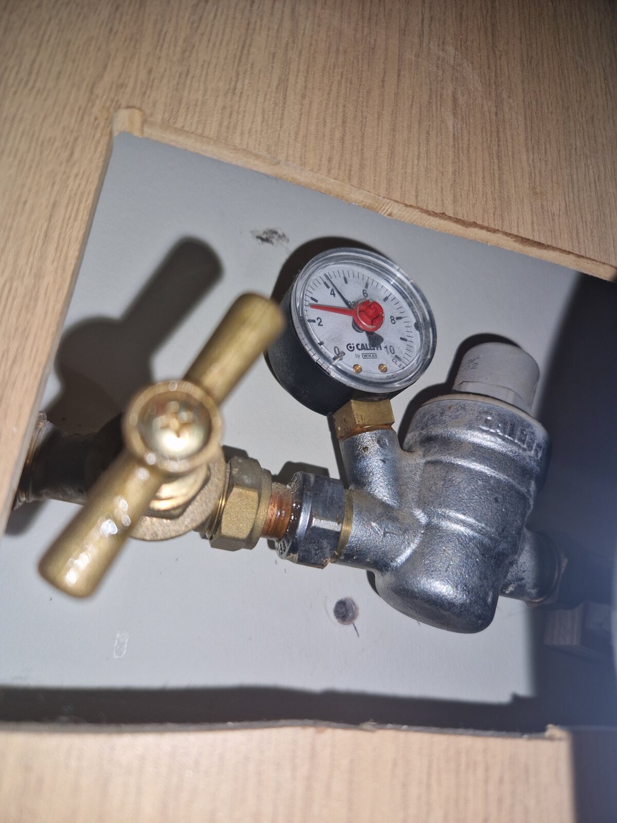

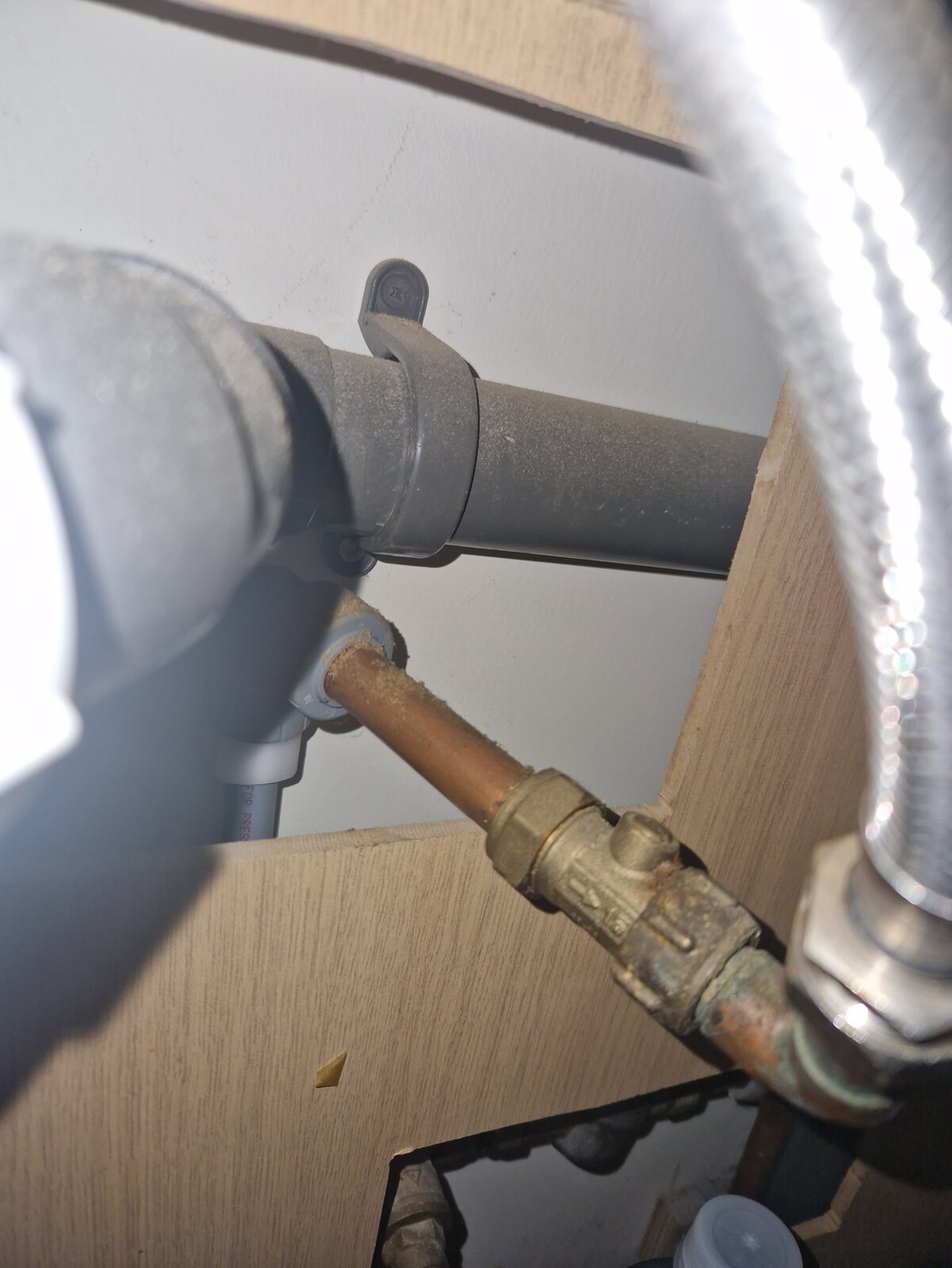

Should I be using PTFE tape on the high pressure unions before assembly? (On that point, re the last advice, Harry. I've always installed using the fitting that cuts into the existing pipe, but this property isn't owned by me, so feel I should use a way that I can remove; additionally I'm unsure where he stop cock is! So cutting in is impossible - there is a stopcock, but I'm unconvinced it's water - see pic')
I wouldn't worry too much about adding one of those self-cutting units, I would not anticipate any landlord complaining about that. Your final photo, appears to be your stop tap. Try turning it off, and running water from a tap, which is connected to the same pipe.
The item to the right of the stop-tap, with the dial, is a water pressure regulator.
As suggested, turn the mains stop tap off and see if it stops the cold water. That silver valve after it is a pressure reducing valve and usually found on the mains water. That being said, it isn't doing much reducing, that should really be set @ ~ 3 bar.
