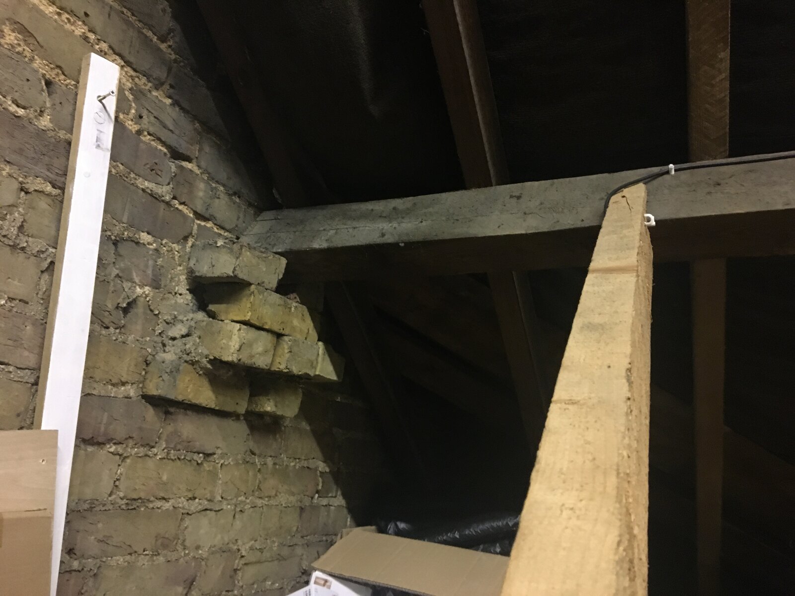

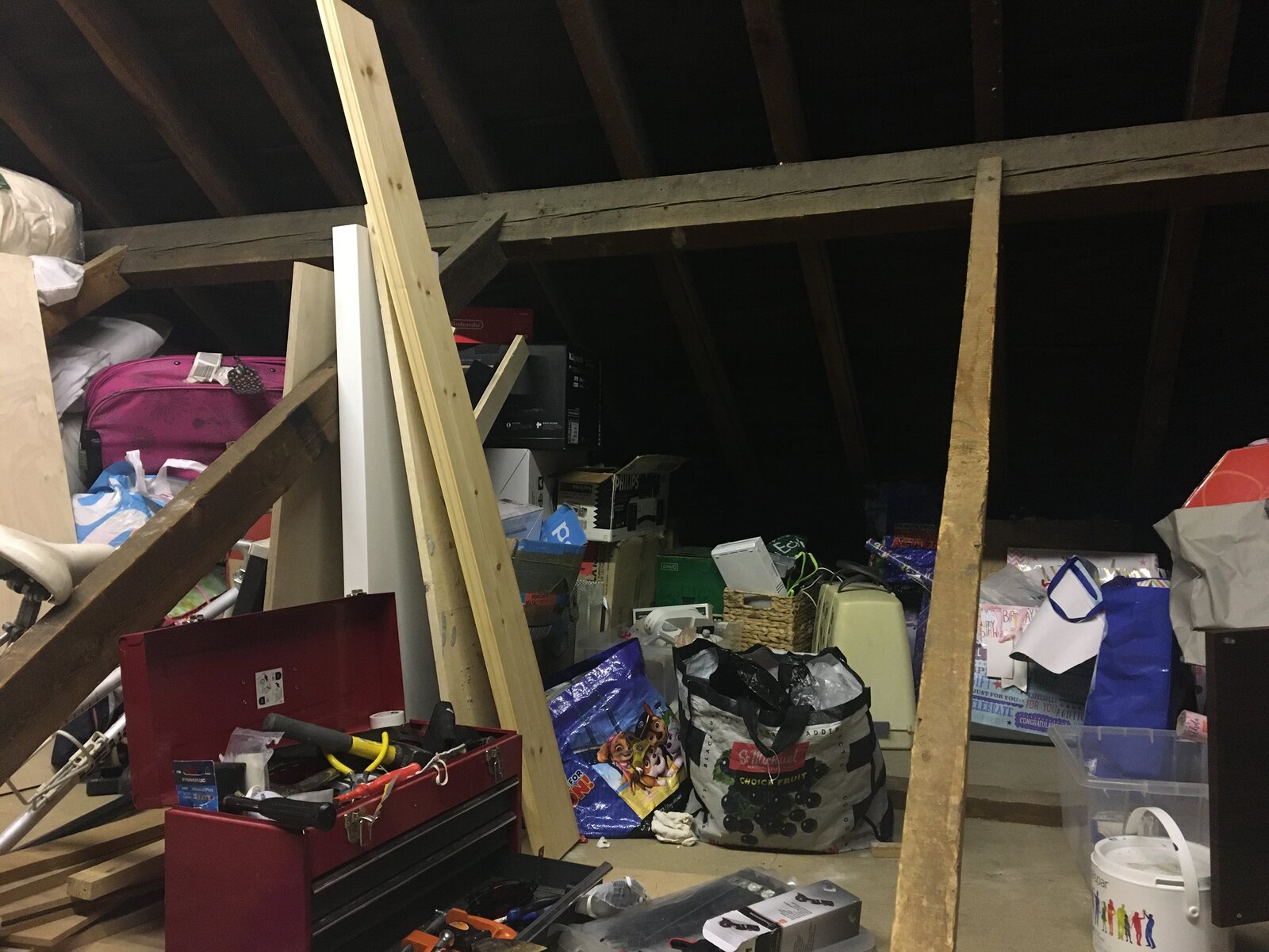

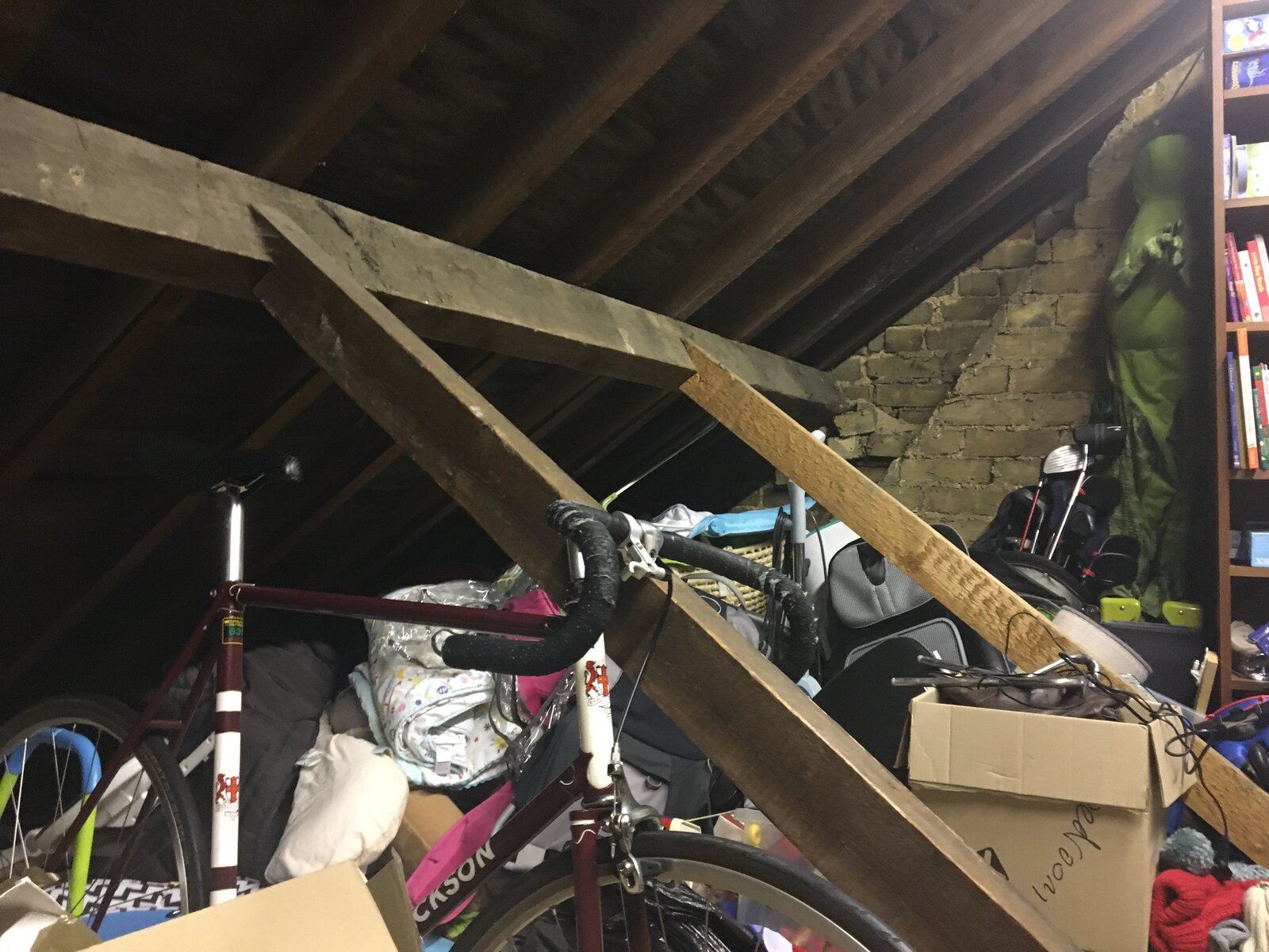

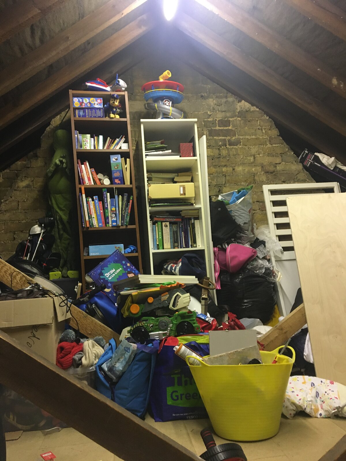

Hey all.
As a lot of people I have found myself working from home and needing somewhere to be more private while working on sensitive material.
We have always planned on doing a full dorma loft conversion at some point, but in the mean time I’d just like to use the space up there.
I’m happy using ladders. We’ll get it well insulated, probably put in a single window south facing. Floor to ceiling OSB for that creative studio look. All of that shouldn’t be a problem and I don’t think I need any planning permission right?
Problem is the beam supports...
They eat up all the space and while I could live with walking over them, I think it would make it hard to fit a desk at the end.
There’s 3 pairs of these. What can I do with them? Can a builder just make vertical supports out of them Without including anyone else? Or Do I need a structural engineer or architect etc.
I need to keep the costs down as who knows if I’ll be allowed to keep on working from home in the future.
Thanks for any advice. Obviously I don’t want to just go running to the first builder who tells me it’s no problem and end up with a collapsing roof.
Christian
748477DD-EC31-4AD1-BD36-B2E94C983C79.jpeg 32F9DBA7-24C0-4356-8BF4-6614DFE2D271.jpeg 9BE877CF-6E9B-443B-87AB-EE77927DF497.jpeg E2EB75B5-1987-49F0-AF76-1880F4303BE8.jpeg
As a BCO I would treat this as a habitable space and would apply the full B Regs.
If you plan to ever convert it, do it once, do it right first time. You will save in the long run.
