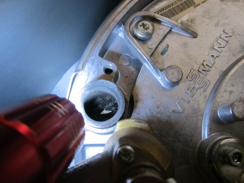

Personally I think either a) your pipework is wrong or b) the boiler is full of sh1te. Had a couple of Viessmanns with clogged Hex on dirty systems and have cleaned through really well if done properly.
the fact it was working ok for a period of time would suggest either b) or a partial blockage somewhere, usually around the F&V connections.
Also I would advise against using the alpha pump they are nothing but trouble with high resistance heat exchangers.
I agree with mickyg, the viessmann heat ex-changer acts like a string and sheds crud off the heat ex-changer as it heats and cools...sadly it just clogs up:
