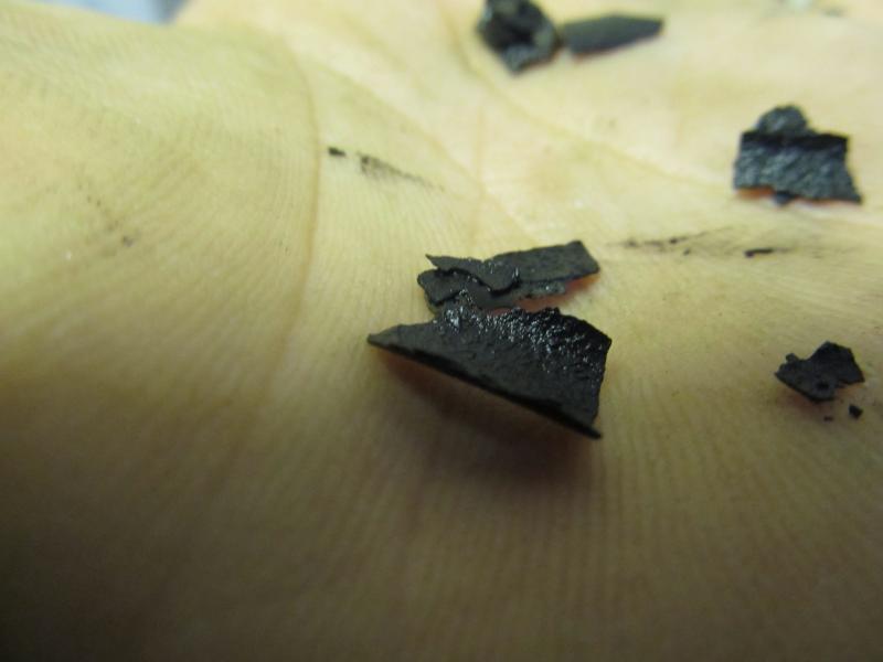

John I think mehran's picture is showing the "shed" corrosion inside the window!
It would be interesting to get some of that stuff under a microscope and do an analysis. I bet it's not just Fe304.

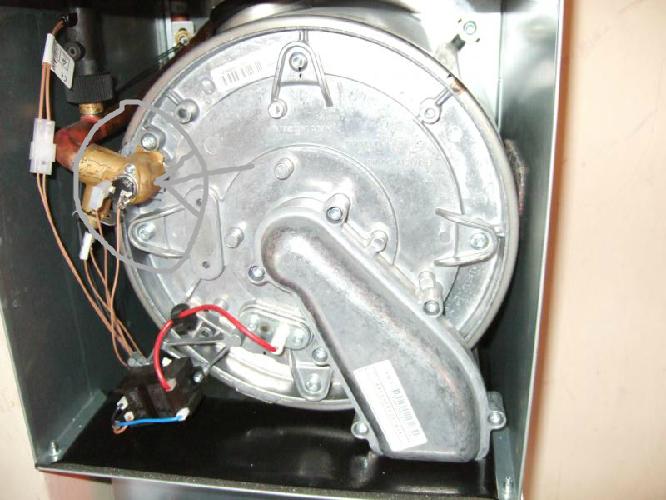

Is there a window in mine?
View media item 4841
or is that not so much a window as the port where the water pipe is connected?
do you suppose a filter would trap those particles?

sorry JohnD :lol: the picture is off a viessmann 200w(it uses the same heat exchanger design)
on your boiler i would of pulled off this pipe:
to show the flow exit port of the heat ex-changer so them black bit in my picture are this sort of stuff:
