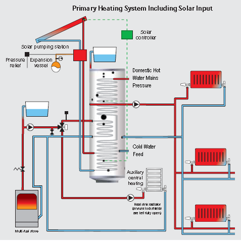

I saw a lovely system,
the diagram is some what simplified, the water stored the energy, in real life two massive water tanks, upstairs, so if electric fails, you still have thermo syphon to cool the solid fuel fire, and the floor is reinforced to take the weight. It was installed when the house was built, and the owner on moving wanted the same system in new house, quoted around £25k, so did not get it installed.

I saw a lovely system, View attachment 351370 the diagram is some what simplified, the water stored the energy, in real life two massive water tanks, upstairs, so if electric fails, you still have thermo syphon to cool the solid fuel fire, and the floor is reinforced to take the weight. It was installed when the house was built, and the owner on moving wanted the same system in new house, quoted around £25k, so did not get it installed.
That is indeed a nice system. But £25k ? Sounds like someone was taking the p1ss.
The problem is the floor needs to be strong enough, the system I saw up and running, had two massive tanks, I would say likely 100 gallons each, this is some weight, and with solid fuel it must fail safe with a power cut, so up stairs.
Quick internet hunt, this house has a 20 kW boiler, will in the worst weather likely runs for 1/3 of the time, (6.7 kW needed) off peak is 7 hours, so need heat for 15 hours, so 100 kWh required when not drawing from the grid, and 200 gallons would give one 80 kWh so not quite enough, but with better insulation or some other heating as well then it would work.
However in the main the whole idea of the system shown is the ability to use multi-fuels, all to same radiators. Each tank can cost £2000 so that bumps up price as well, for most it is a pipe dream, not a real option, and that is my point, we can select a good system, but a good system at a reasonable price is some thing else.
Indeed, and the hot water.
It also means you can design the heating system according to its needs instead of the limitations of the boiler - in particular the requirement for a minimum flow rate. Modulating pump, TRVs (or electronic controls) on all rads = nice quiet system. Then the boiler loop can be designed to suit the boiler not the limitations of the heating system.
I know - put one in the rental flat about 14 years ago now, and in our own house a few years ago. Flat was an off the shelf one, ours was a custom design* to fit the space - could only fit 170l. Both are just there for the buffer and stored heat - the only heat source is the gas boiler.

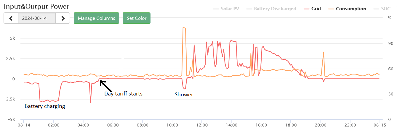

I have looked at tariffs of late, the original tariff I had was 29.57 p per kWh, I went to a split tariff of 8.95 p for 5 hours at night and 31.31 p for the peak supply, if using electric 24/7 at the same rate then average is 26.65 p per kWh, but we tend to use less at night, so to gain from the split tariff one needs to arrange things so the heavy use is at night.
I can see what I use 1723714287731.png and when I draw from the grid, below 0 is import, above 0 is export, so most of the power I use from the grid is over night. With electric heating however it comes down to when we want to heat the home, my oil central heating switches off at around 10 pm, and back on at 8 pm, I don't like it warm at night, and to be frank when I was working heating came on at 5 pm, the problem with heat storage is to stop the heat going into the house, when not required. In an old peoples home likely they do want 24/7 heating, but most other places they don't, so how does one work out the cost of heating 24/7 v 5 hours, as clearly the fabric of the building also stores heat.
So much is down to how fast heat is lost, I know the flat under the house is very slow to loose heat, or without heating on, to gain heat, it is where I brew my beer, and first 48 hours need beer at 19ºC and this time of year rarely cool enough to start a brew. But rest of house as all above ground level, and heat loss and gain is much faster.
So each home will have a different cut off point where single tariff and split tariff end up costing the same, in terms of hours when home is heated, so a couple who both go out to work, panel heater could be cheaper than a storage heater, as only heat the house for a few hours a day, but a couple with at baby the storage will work better, once the children reach school age again it changes, as even if one adult stays home during the day, they are likely busy, so don't want heating as high.
I was stunned when my daughter told me how much electric costs when it heats the house, clearly I use more in winter than summer July was £41.71 and February (did not have smart meter until end of Jan) was £82.50 in summer half the bill is the standing charge. I may also spend £750 on oil, hard to say, as price varies.

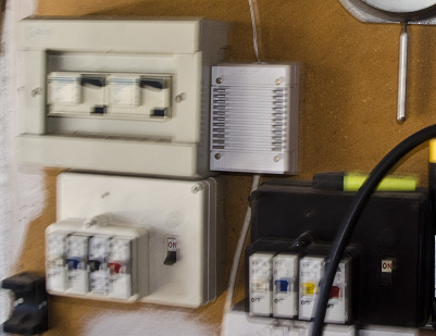

I think @WiseOwlOls has given up, this 1723805922427.png is what one would likely find in a museum, Beamish and the like, the old smiths clocks
I remember well, turn the cover to remove it, and then turn the centre knob to release the blades, and you could then put them at the times you wanted, you can also select the days of the week,
you want it to run, most if you pull the whole unit unplugs, so you can do all the settings in comfort, there was often a little red button on side to manually switch on/off, some did not have days of week, but some even have seasons so they could turn on lights earlier in the winter, there were quite a few variations of basic same device.
Above the is a relay, looks like a mercury device, not seen one that size, it was common to use mercury in thermostats, but not seen them before.
Centre is the old Wylex fuse box, they were only rated at 60 amp, in the main limited to 30 amp fuse, but some versions the first fuse next to isolator could take a larger fuse, the fuse carrier could be changed, rewire-able, cartridge, and even a MCB could be fitted in that box, the MCB needed the cover to have the centre removed, and trying to remove the centre often resulted in it smashing, so common with MCB's to see no cover. You can still get them, but at £22 each expensive 1723807097491.png the older ones had two buttons rather than a switch.
The box will not take a RCD so I had a separate box with RCD's in it 1723807319001.png this was before the consumer unit was invented.
As to the way forward, hard to say, clearly well past its use by date, it depends on what you want to spend. Or maybe how you want to spend, the more you spend to install new, the less you spend to run it, but we only have three score years and ten, so at 85 you may just leave as it is, at 25 you will likely rip it all out.
Also why you need to change, I know I had mother house re-wired in case I needed to let it out to pay for her care, as to an electrical installation condition report, (EICR) not sure how I would code it, could be just code C3, advise up-grading, but it could be a potential danger (C2) with mercury relays, so if a rented property likely you would be forced to upgrade.
