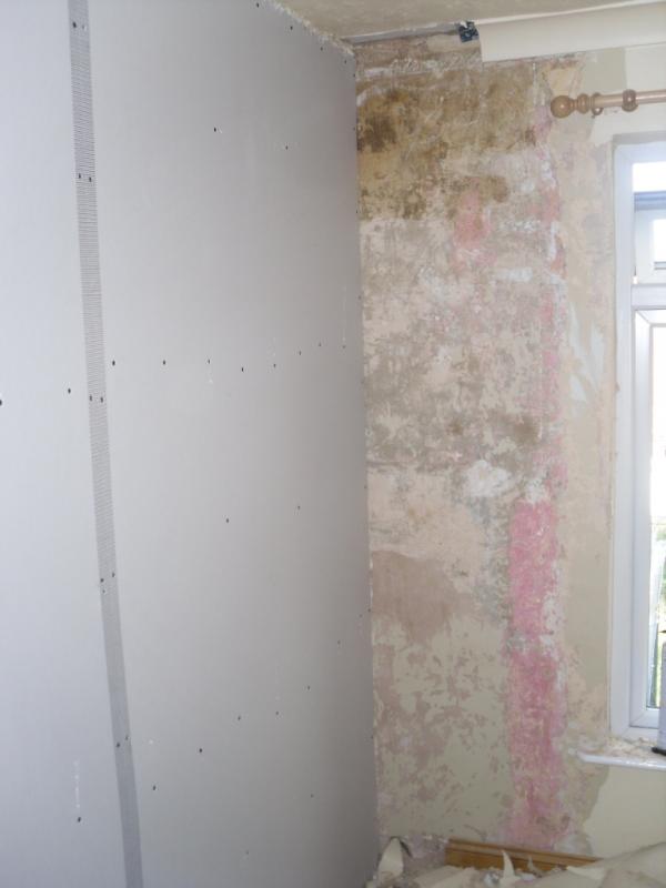

Hi,
I have just split a room with a stud wall (thanks to the guys in the Building forum), and want to know the best way to make it look reasonable. This needs to be balanced by time and cost - baby due in 1 week. You can imagine the problem - getting it in the neck from a very hormonal other half!
The rooms are made up of 3 types of wall:
1. So there is currently the new stud wall, which I am planning to tape and fill.
2. The external walls with old plaster (house built 1890).
3. An old stud wall (probably 50's) with ply instead of plasterboard.
As the old wallpaper is in bad condition my plan is to remove this (as well as I can from the ply!) and cover the whole room in new paper. I would get re-skimmed but don't have the time, especially as I would have to board over the ply. Think i will leave the ceiling paper as it is not too bad.
The other half has picked out some "superfresco" vinyl paper as she says it will cover the lumps and bumps well. I'm not too keen, would lining paper do a good enough job so that we could just paint?
She has also chosen some homebase silk emulsion in a baby blue.......
So, does this sound like an OK plan?
Thanks,
Jim

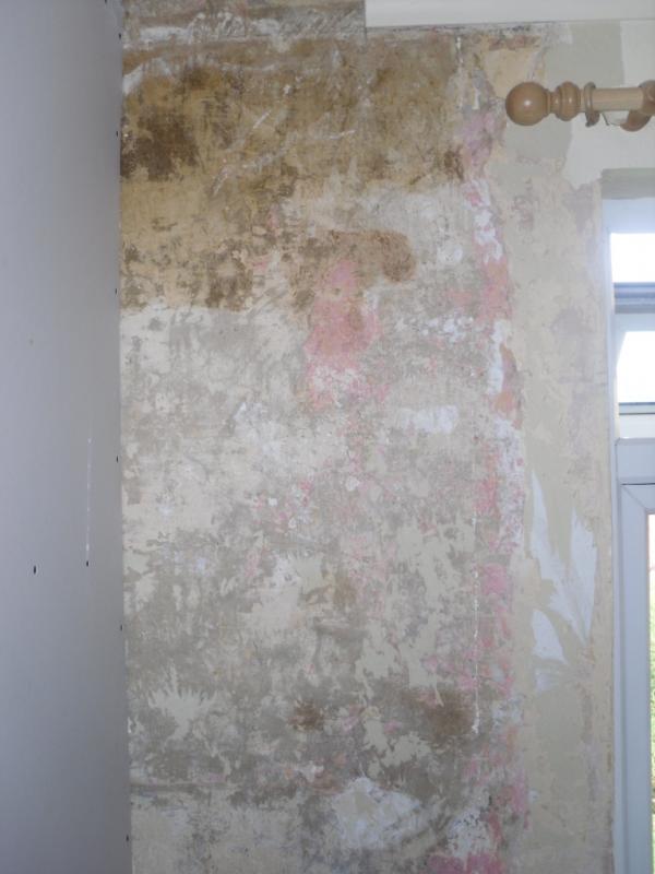

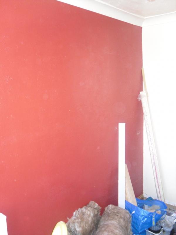

Thank you both. I have peeled back some of the wallpaper. Picture below and of the other walls.
Based on the pics do you think wallrock fiberliner would look ok if just painted or best to go with the superfresco?
With these two types does it really make a big difference to remove all the existing wallpaper? i.e. could you leave the stuff that is still stuck well? Think it may be a problem to get it off the ply.

I have had a good look at those pics, and am of the opinion that your paintable Fresco would be ok and lining is not needed.
Please forgive me if I am wrong here, but I do have a gut insctinct that i'm not that far off.
A couple of points though, my eyes are guided toward the dark staining in the top left of your pics, and it looks to me as if this wall has been subject to condensation or the ingress of water. If this is the case and on the provision that it's cured you will ned to seal those areas with a stain blocker, an alkali resisting primer, or an oil based undercoat.
I would further suggest that you remove all existing wallpaper and size the walls before before you continue.

I saw the stain too, a bit odd. At first I thought damp. The area feels sticky rather than typically damp though. This part of the wall forms the old, now unused, chimney breast, so I thought it maybe oils/tars etc. leeching through. Otherwise I thought that somebody could have applied an anti damp product if there had been damp in the past - leaving this sticky residue.
Of course I could be wrong and it could just be damp!

Judging by your pics you could either use a 12 to 1400 grade lining paper or just apply your Fresco, if you choose the lining route you may in the future decide on hanging wallpaper as opposed to painting. These babas tend to grow up quickly and develop their own opinions. ;)
So cross lining may just be the best way to go,

The stickyness might be because the old paste is damp, thus the wall is damp. Is the old/unused chimney covered/vented.
WRT the paper on the ply, with a decent sander and dust extractor you can just sand it back to feather it off.
Other than that I would agree with TheDec

you might want to think about an air vent, particularly a passive airvent which will allow moisture out but keep the warm air in.
