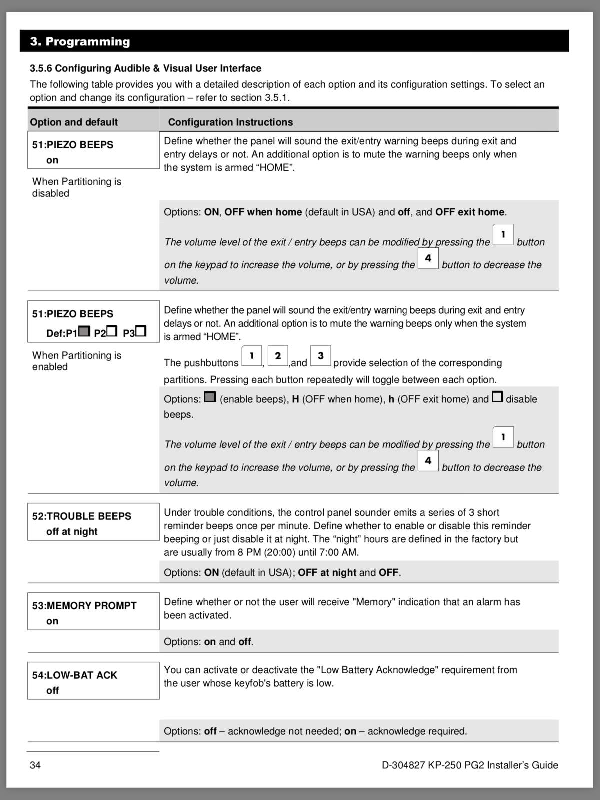

Hi I have the above installed and I cannot lower the volume or disable the entry exit buzzer when I want to enable the home setting. I can find the setting in the installer menu but it won’t store the buzzer mute in when requested, any ideas?

I see two options with partition enabled and disabled have you tried both
51:PIEZO BEEPS
With Partition
disabled
Define whether the panel will sound the exit/entry warning beeps during exit and entry delays or
not. An additional option is to mute the warning beeps only when the system is armed “HOME”.
Options: ON (default), OFF when home (default in USA) and OFF, and OFF exit home.
Note: When exit beeps are OFF, the Success (success) melody will still sound toward the end
of an exit delay.
The volume level of the exit / entry beeps can be modified by pressing the button on the
keypad to increase the volume, or by pressing the button to decrease the volume.
51:PIEZO BEEPS
With Partition enabled
The control panel’s display is: Def:P1 P2 P3
The pushbuttons , , and provide selection of the corresponding partitions.
Pressing each button repeatedly will toggle between each option.
Options: (enable beeps), H (OFF when home), h (OFF exit home) and (disable beeps).
Notes:
When exit beeps are OFF, the Success (success) melody will still sound toward the end of an
exit delay.
Tried both ie with portion enabled and disabled, no success. Is there anything else that would stop it remembering this command.?
