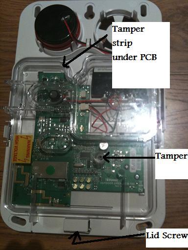

Fitting a Visonic Powermax Complete with MCS-740 outdoor siren.
I am having a problem with it at the moment, unable to arm the system. Checking the status on the alarm panel and it gives an error code “S01 TAMPER OPEN ERROR”. I am assuming this is the outside siren box.
Apparently there are two tampers on the siren box, the one on the front cover which can be heard to click when fitting the cover and the one on the breakaway screw hole at the back.
I’m wondering about the one at the back, a screw is fitted through this to the wall lightly touching the plastic and I can see a gold foil behind the pcb which I am supposing when the plastic breaks away it takes the gold foil with it setting the alarm off.
Hope than you can suggest what the cause of this tamper error is?

I am guessing the bottom of the siren has the cover tamper, the screw just below the middle of the two piezoz's, is designed to break the unit away from the the cover tamper to give a tamper iof its knocked off the wall, but cant say for certain.
I've deleted the siren off the system, no fault message now.
I'll get it back down off the wall tomorrow, if it finally stops raining :D .
Came across this image on another site for the MCS-730 model
The gold foil is under where it says "Tamper strip under PCB"
Need some more images I think, as I cant see much wrt to the wall tamper.
when you take it off, need to try and work out how to secure the tampers manually when its learnt back on.

Set the alarm back to factory default and re- enrolled all sensors. Took the bell box down and laid it down near to the alarm panel and enrolled it again.
There is a contact under the pcb which looks as though it will break away with the plastic if the bell box is wrenched off the wall.
No fault messages so refitted the bell box and everything is ok.
All I can think is the bell box might have been slightly twisted on the wall (stone face on the house) or everything needed to be setup properly.
