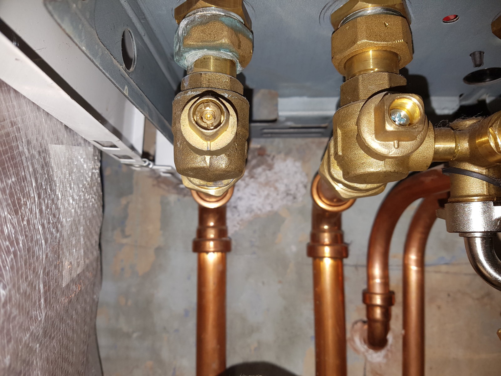

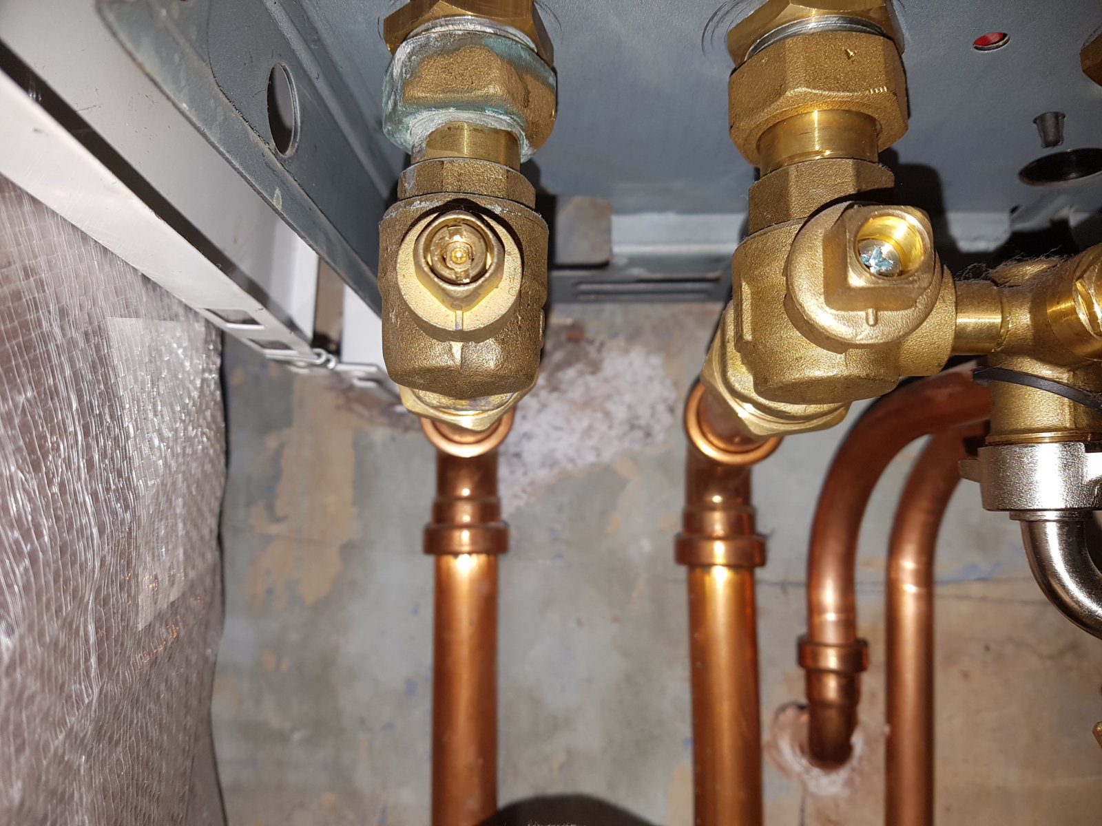

I did think it could be the flow return pipes - would these have been turned when the heat exchanger was changed? The problem I had is I wasnt sure which way to turn them as the screw head wouldnt budge and the other side was incredibly free to move - does this look normal to you guys?
I would be looking at the diverter valve cartridge, they are common to break up inside
Thanks Ian - If i was to change that cartridge would I have to drain the system down? Probably an obvious question just don't want to remove something and get an unrequested shower...
you just need to drain the primary water in the boiler, no need to turn off the cold water inlet, there is a drain point on the lower front of the boiler, dont touch the isolation valves or the PRV, its a very easy job to do, if the cartridge is broken up use long nose pliers or similar to make sure you have got all the pieces of the old cartridge out , as said a very easy job
