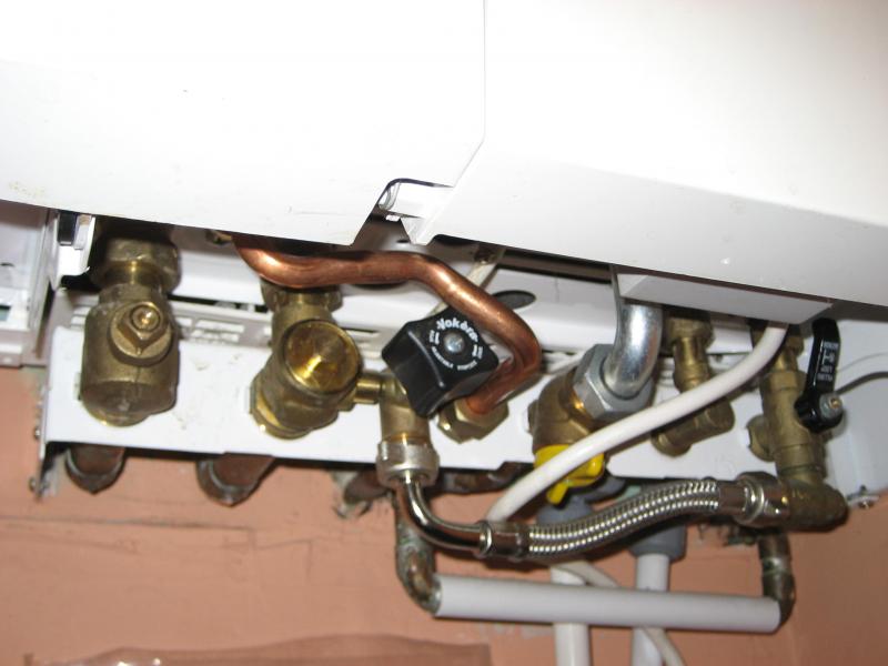

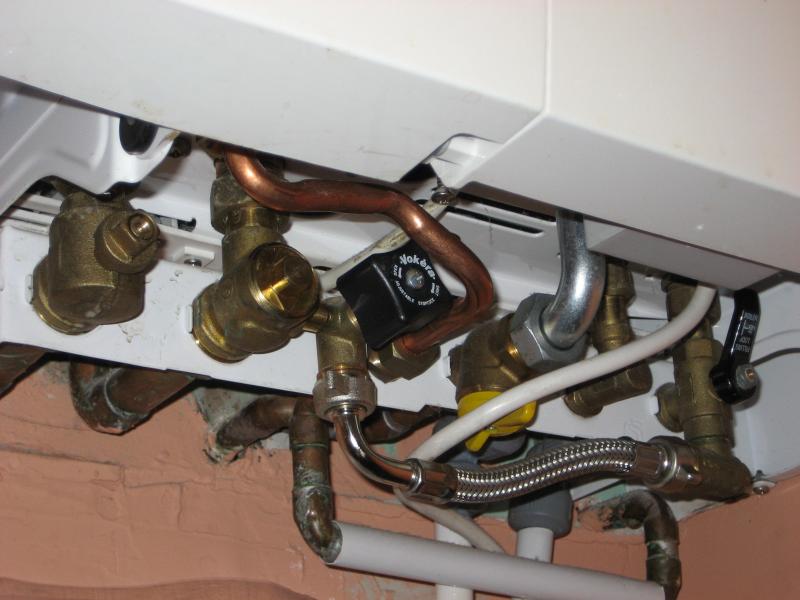

So we are now talking about a connection at the opposite end of where the filler tap is. The braided pipe at the opposite end connects to another brass coupling that has a black square knob on it which say's 'Vokera Adjustable Stopcock'.
Is it that brass coupling/valve that need's replacing or the larger dome shaped thing to the left of it that connects to the main copper pipe that appears to feed into the boiler and also off to the rest of the house?
Can you post a picture?
There seems to be some confusion because there are two versions of the Linea that are a bit different in that area.
Sorry for any confusion.
If you post a picture we will tell you the part you need.
You have the "other version"
Your non return valve is at the right hand end of the braided hose.
Make sure the black tap on the left hand side of the hose is off.
Undo braided hose (any end)
There should be no water at this point.
Slowly pull the little black lever on the right hand side (the boiler filling tap)
Is there any water released?
