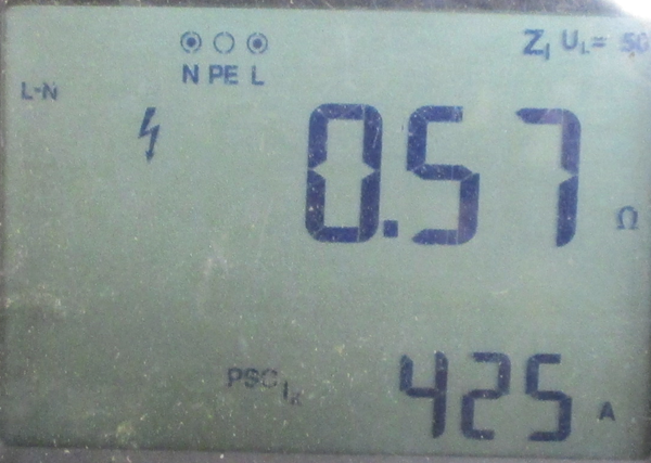

Fair enough. As I said, the test he did must have been a 'loop impedance test', but are you saying that his meter shows Ze and PFC separately (only one at a time), and that he only saw the PFC and would have had (but did not bother to) press/do something to display the actual Ze? With my Fluke, I'm used to being presented with both, as in (just done) ...
... which obviously implies a voltage at the time of about 242 V (425 x 0.57)
I don't know the KEW product, My Robins show one or the other, switchable and I believe 3 ranges each.
Yes, on the basis of the other things you have reported, I would expect that test to show a 'high' resistance (seemingly probably about 115Ω ), in both 'directions'. Are you saying that you only got very low readings (say, <1Ω )?

My Robin KMP4120DL has switchable ranges of 20Ω, 200Ω, 2KΩ, 200A, 2KA & 20KA and just a single display
At home I currently have 0.34Ω & unusually high 241-244V (fluctuating) and 588-597A
Those figures don't quite tally in my head, PSC seems a little low.

It turns out my colleagues KEW MFT is in for calibration and has been using uncalibrated Robin testers, virtually the same as mine, so PFC and LI are not simultaneousely displayed.
Anyway I've just got home from there and signing in we had to state the reason for visit, the security guard was quite chatty and mentioned the socket in the office used to have the same problem and the disused white cable (the 4mm² in this thread) was used to fix it and pointed to the old cable hanging under the counter terminated with choc bloc and plastic tape.
We both tested for PFC & LI but each time the button pushed a different reading between ¼ & 2A or 280 & 1700Ω. consistant with the socket in the bedroom.
