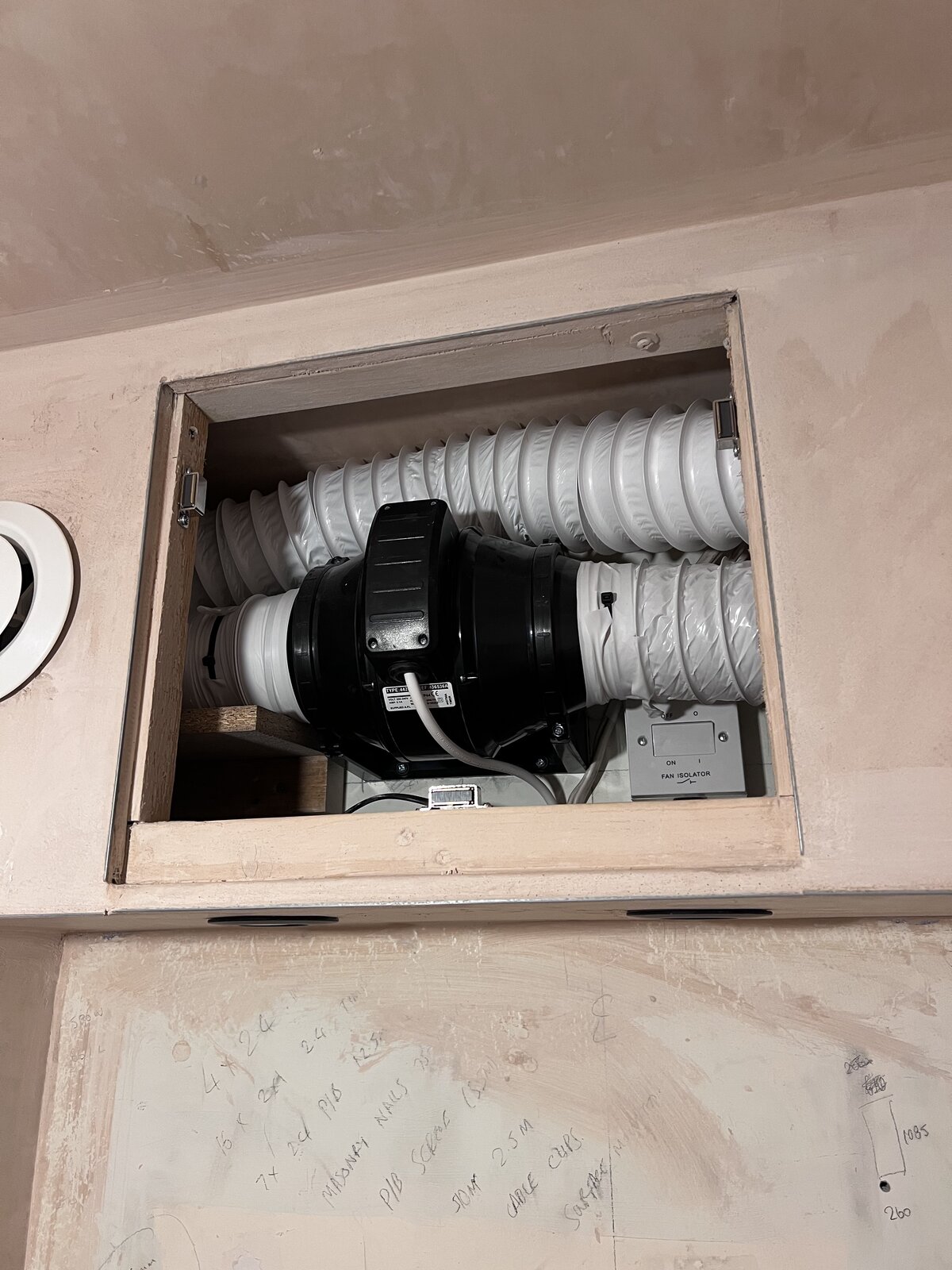

The in-line fan has a run on. It has two ducts venting the separate toilet and bathroom.

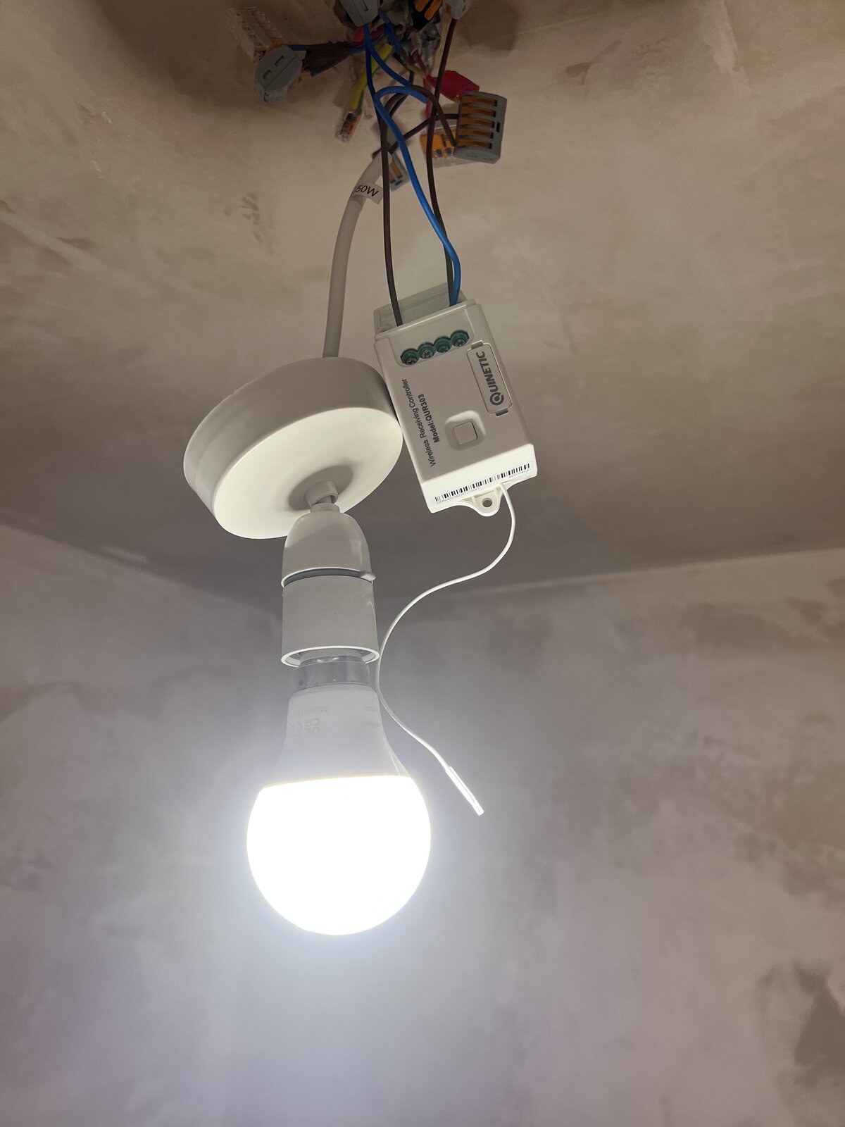

At the isolator is two 4 core cables (live/neutral/extractor switch live and earth) - wired into the isolator terminals together because of the two separate rooms.

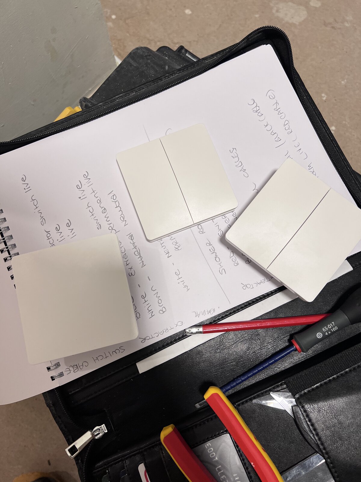

I am trying different things so I have the Quinetic receiver attached to the light in the bathroom (and a two gang wireless switch (wired as a one way) for that receiver.
In the toilet room I have wired a double pole switch (normal), a one gang two way switch, a Quinetic two gang switch with inbuilt receiver.

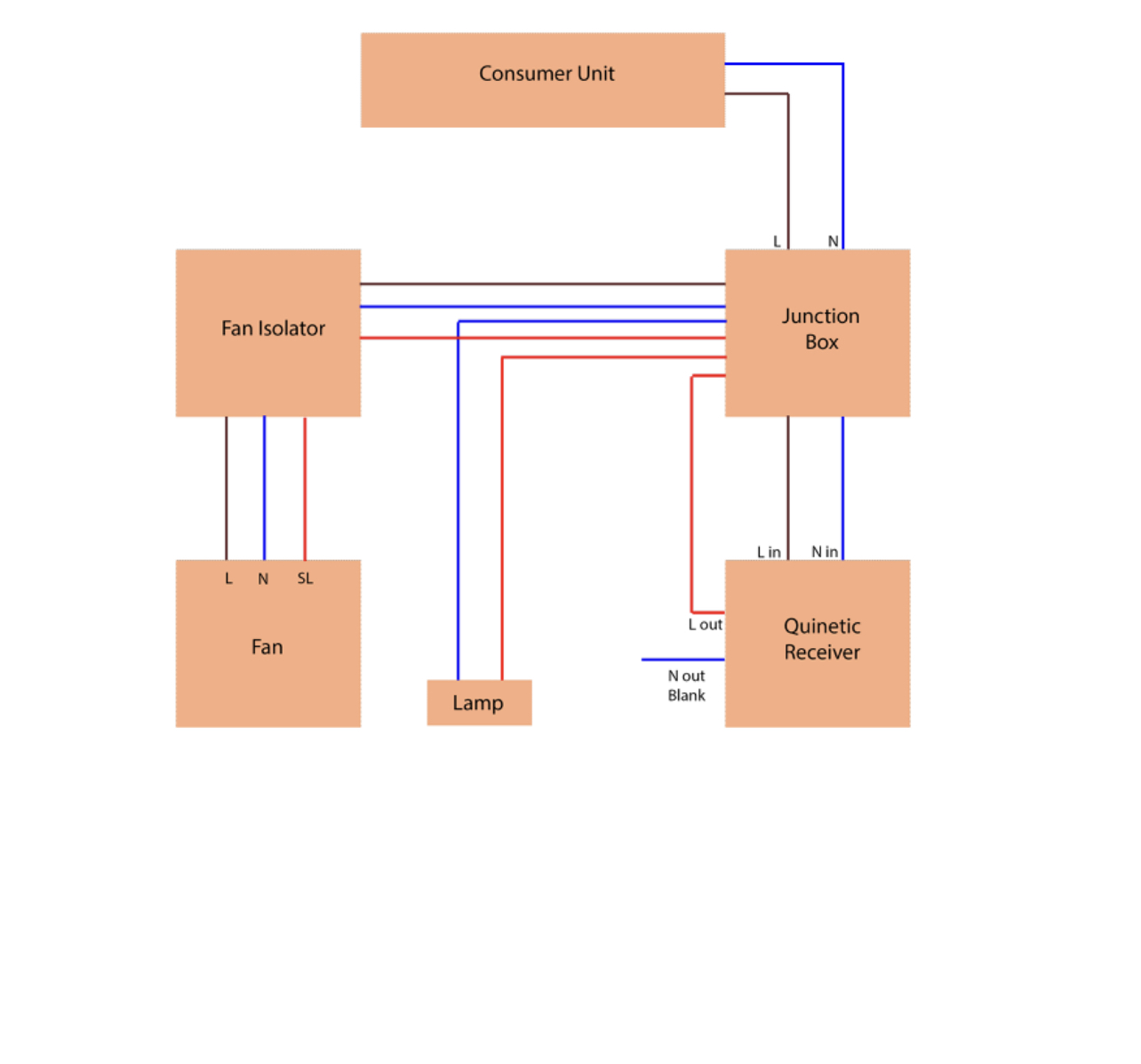

I have attached the wiring diagram from Quinetic for the receiver set up in the bathroom

Both lights are connected to the same fan. If one is on, so is the other one via the fan as both switch lines are connected together.
If you want to use the wireless switches you need 2 on/off receivers and 1 momentary receiver.
The on/off receivers are used for the light in each room
The momentary receiver is used for the switched input to the fan.
The switches are paired to the corresponding light receiver and the fan.
Pressing the switch will turn the light on and also send the start signal to the fan.
Press the switch again to turn the light off, and also send another start signal to the fan so that the fan runs for the required time after the light is off.
The only minor problem with this is that if the light is left on for a long time, the fan will stop after the timer.
Or just install standard wired double pole switches in each room.

So it’s taken a bit of fiddling about but have eventually sorted the above problem out to allow a separate toilet and shower room to be controlled by Quinetic wireless switches.
As per above recommendations … the switch lives can’t be crossed together because a circuit was being created at the fan … so in essence, a switch from either room control the light in the other.
Because there are the individual lamps and a separate cable feeding the extractor to each room … I was able to connect an individual receiver to each load (2 x lights and 2 x extractor feeds). These have just been hidden in the ceiling.
Even better … I thought I would therefore have to control the extractor on a separate switch in a two gang setup … however you can press the pairing button on both receivers in the respective rooms and paid to a single switch. This creating a double pole scenario In essence.
