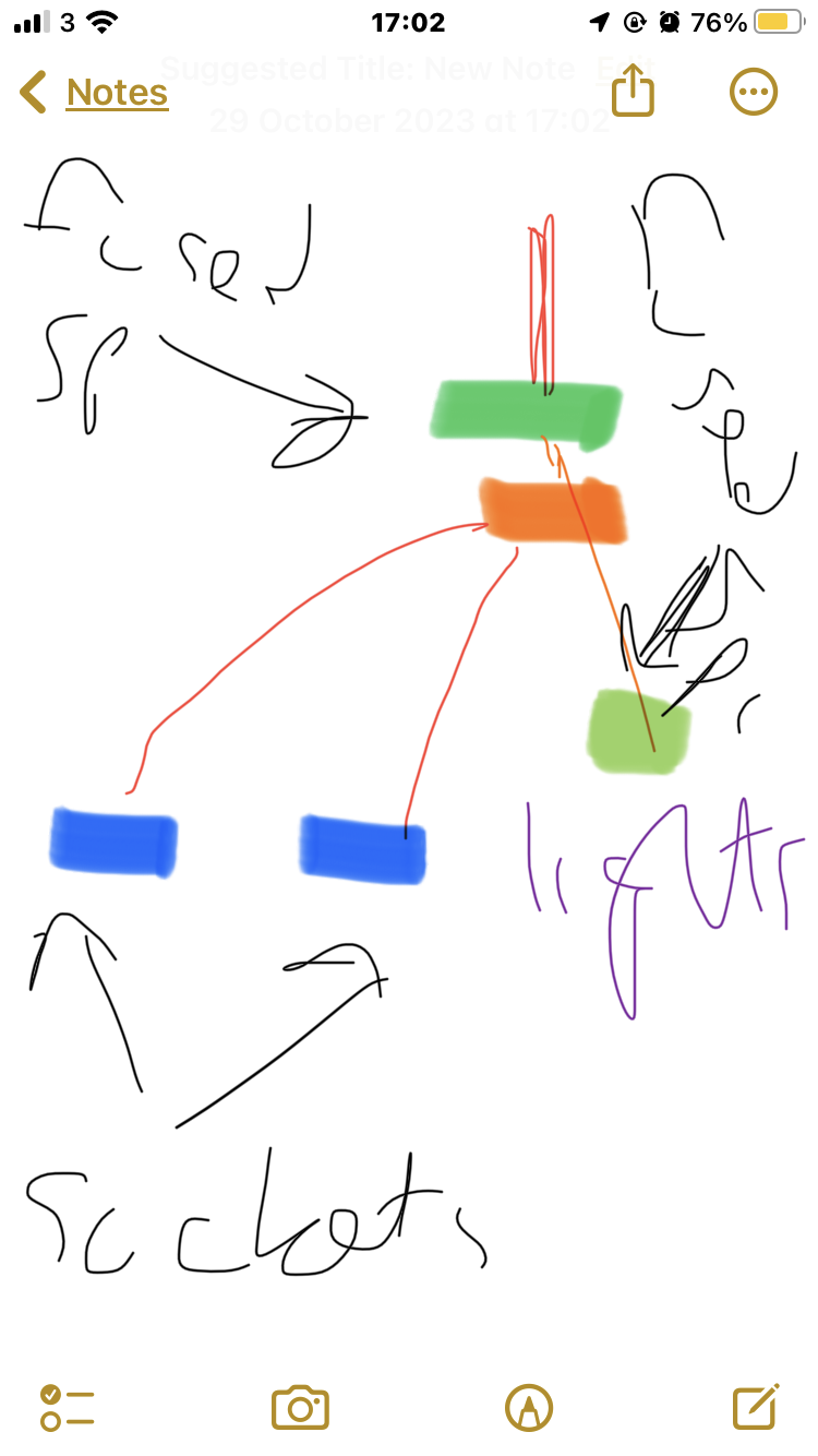

Hi
Firstly apologies for the rubbish diagram … not easy drawing free hand on a phone lol
Key
Green fused spurs… 13A mains in , 3 amp lights
Orange - Wago connector
Blue - sockets
Red - mains live
Is it possible or should I say acceptable to have a mains live coming into a 13Amp spur then the out going to a 3 way Wago then going to a lighting 3 amp spur and two sockets?
Usually I’d wire these in parallel but would be far easier this way

If you mean you have a fused connection unit fed off the circuit which is fused at 13A that is going on to feed two sockets and a further fused connection unit which is fused at 3A feeding some lighting, that seems fine. As long as the loads are connected to the load terminals of the first FCU and the lighting loads to the load terminals of the second FCU (which has been fused down to 3A), that's fine.
Efl thanks for your reply … I did consider that but trying to squeeze three cables in the back seemed a bit of a squeeze lol
Secure thanks for your reply … exactly what you have said !
One t+e off the first spur, dasiy chain the second, do away with the wagos. Lighting spur from fused spur, do away with the second. Will be a bit tight so use a deep back box.
Also socket spur from fused spur.
So socket fused spur to socket spur and lighting fused spur then to lighting spur.
