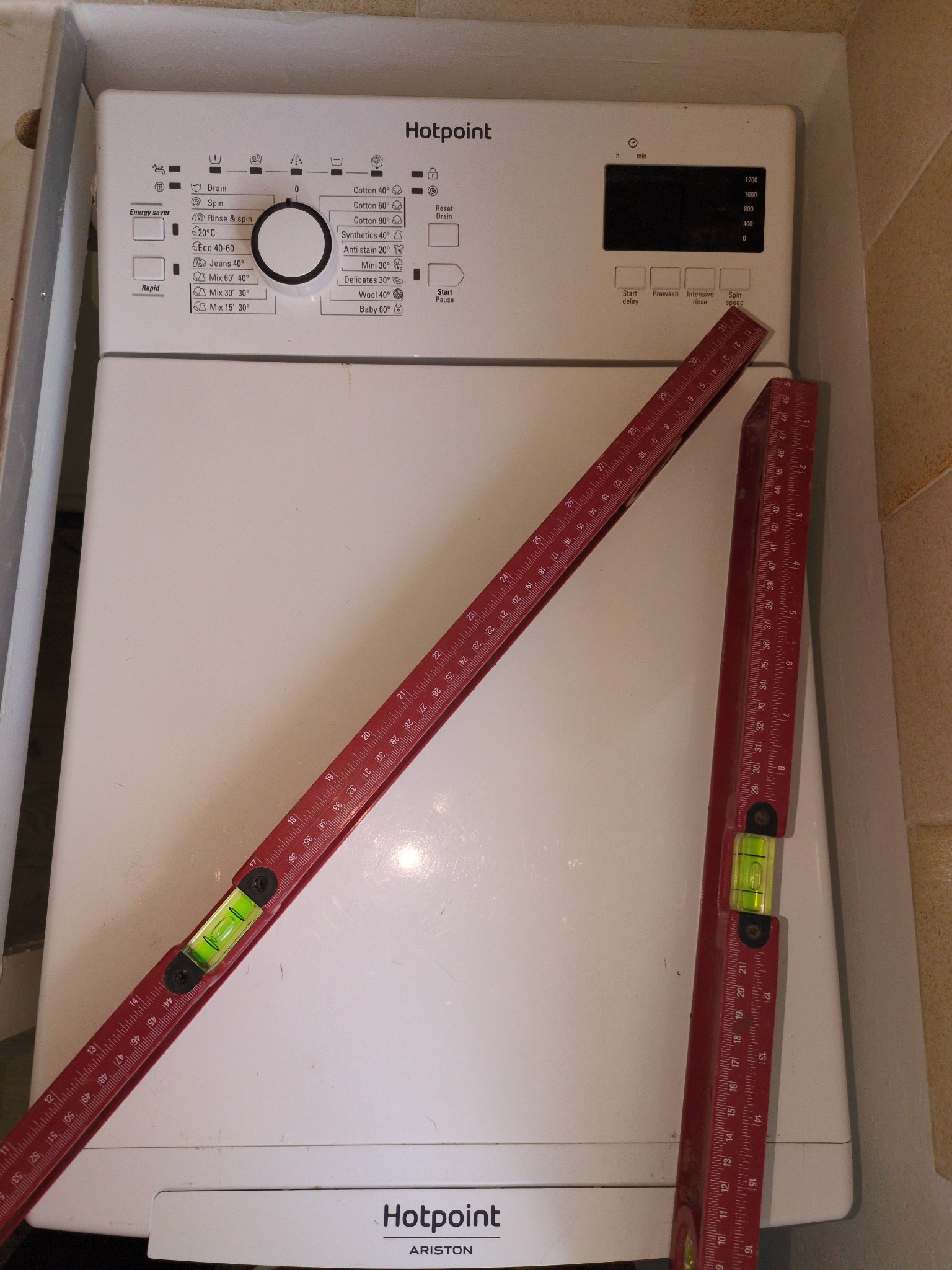

My top loaded (not side loaded) washing machine despite being level with all 4 feet short as can be still walks during spin cycles. The floor is laminate over laminate backing sheet. Am going to call the manufacturer get a call out to see what's wrong. What should I do first?

Shipping bolts removed I just checked
Is it new? Are there any shipping bolts that need to be removed?
About 1 year old has a 10 year warranty. Shipping bolts removed I just checked

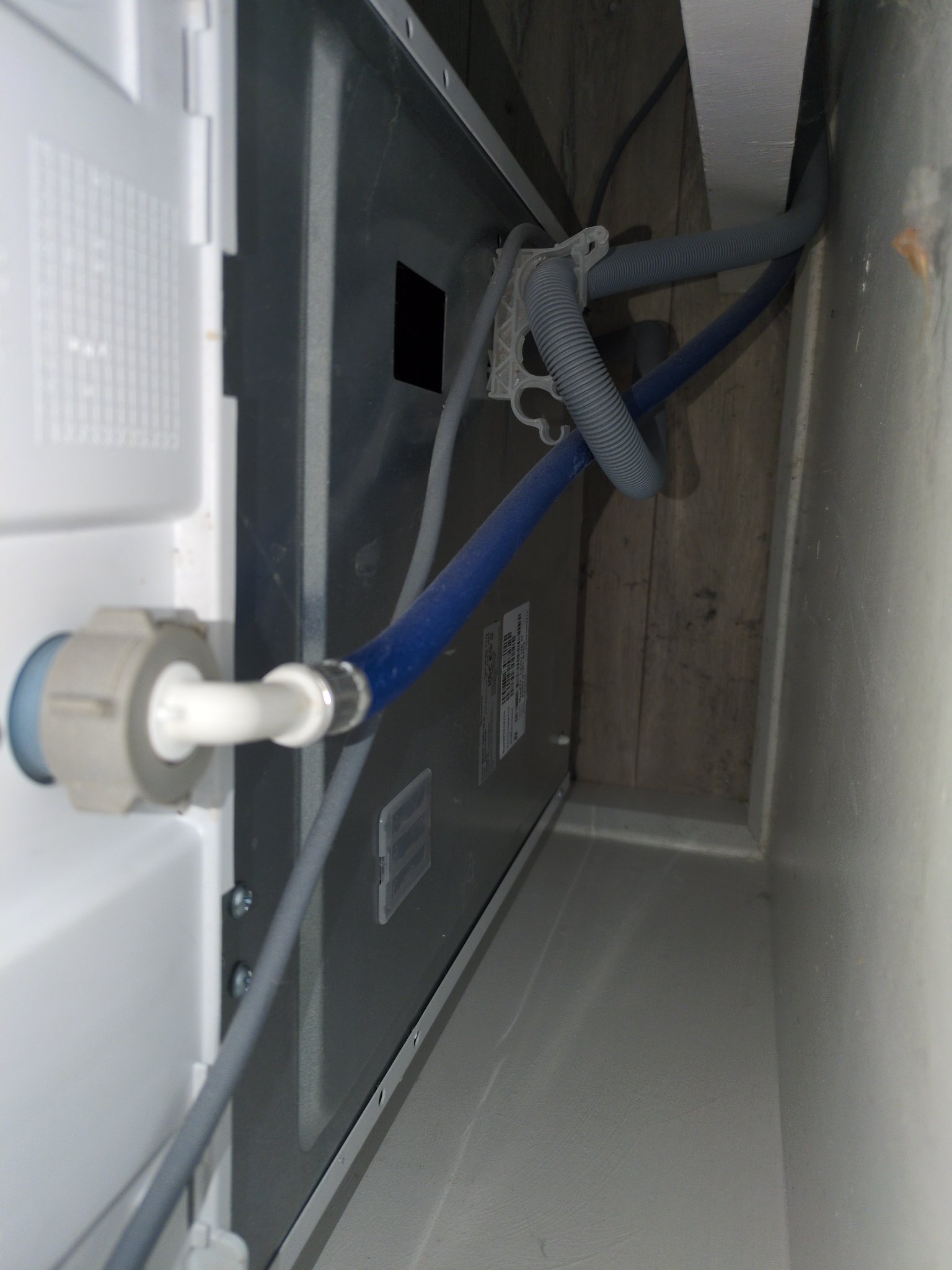

Washing machine is level and on 4 anti vibration pads. Although there is a slightly damp smell coming from underneath I looked under there are no leaks

Damp smell maybe a lack of airflow around machine.
Think about how you can increase that.
Read instructions to see what that says about air gaps.
You can make a stand with sheet material and feet if floor is tiled or uneven.
Need to have a solid even base
The laminate probably flexes when stood on but it's only slight but enough to increase vibration. The previous side load washing machine was on the chipboard and didn't flex. I have had to screw down the laminate to the chipboard in some places due to excessive flex. I can't increase airflow around the washing machine easily. If I cut a 18mm plywood square and put it on top of the plywood (screwed through laminate and into the chipboard) then sat the washing machine on top of the ply square would that help reduce vibration? The plywood should stop laminate flex (if any)
