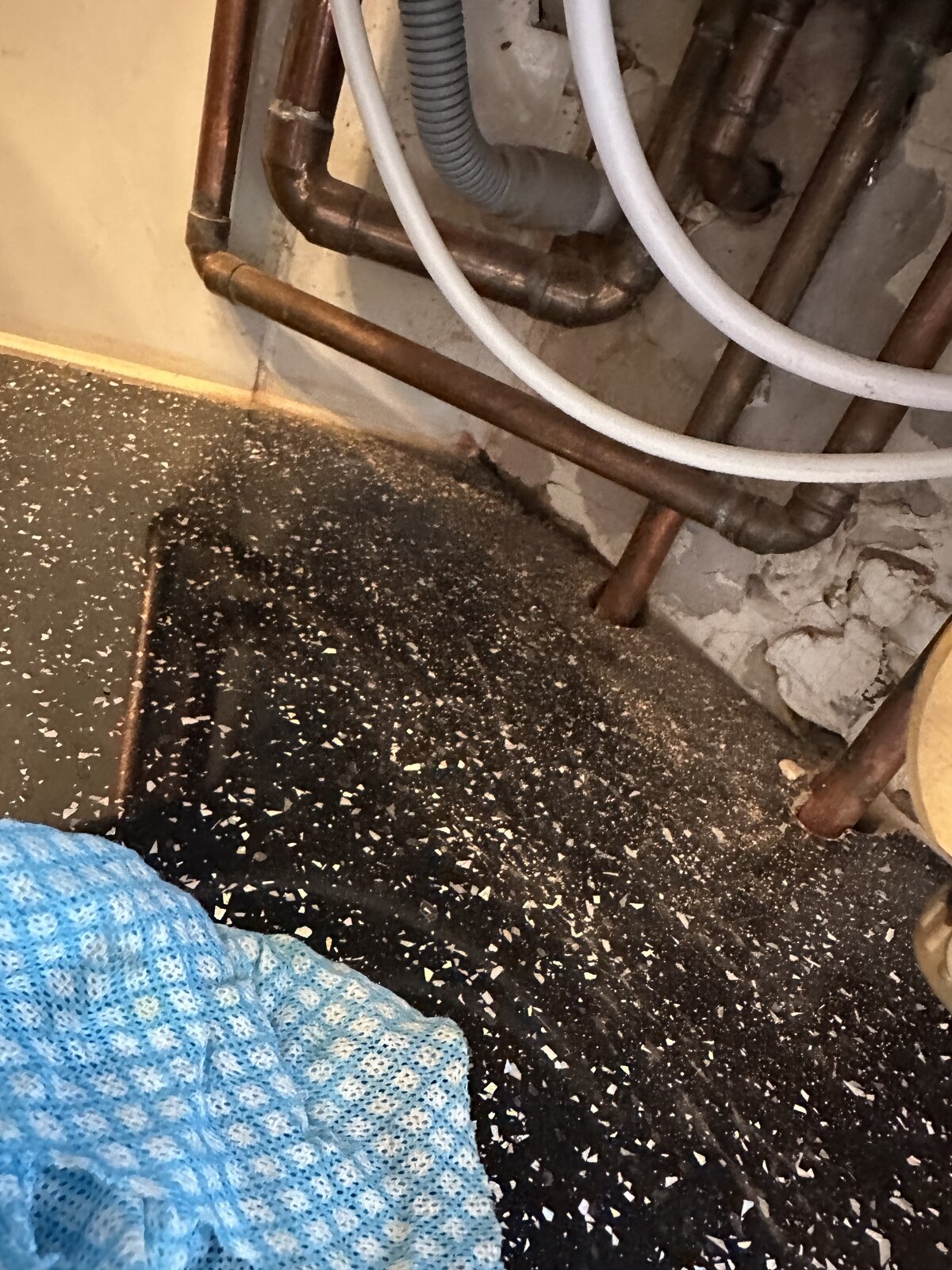

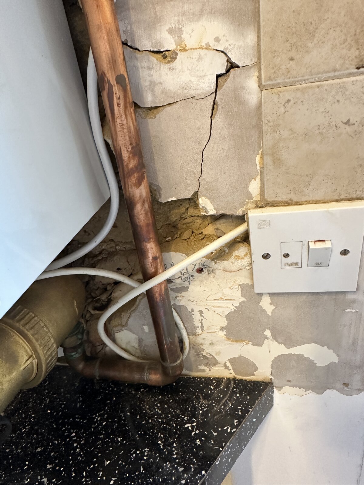

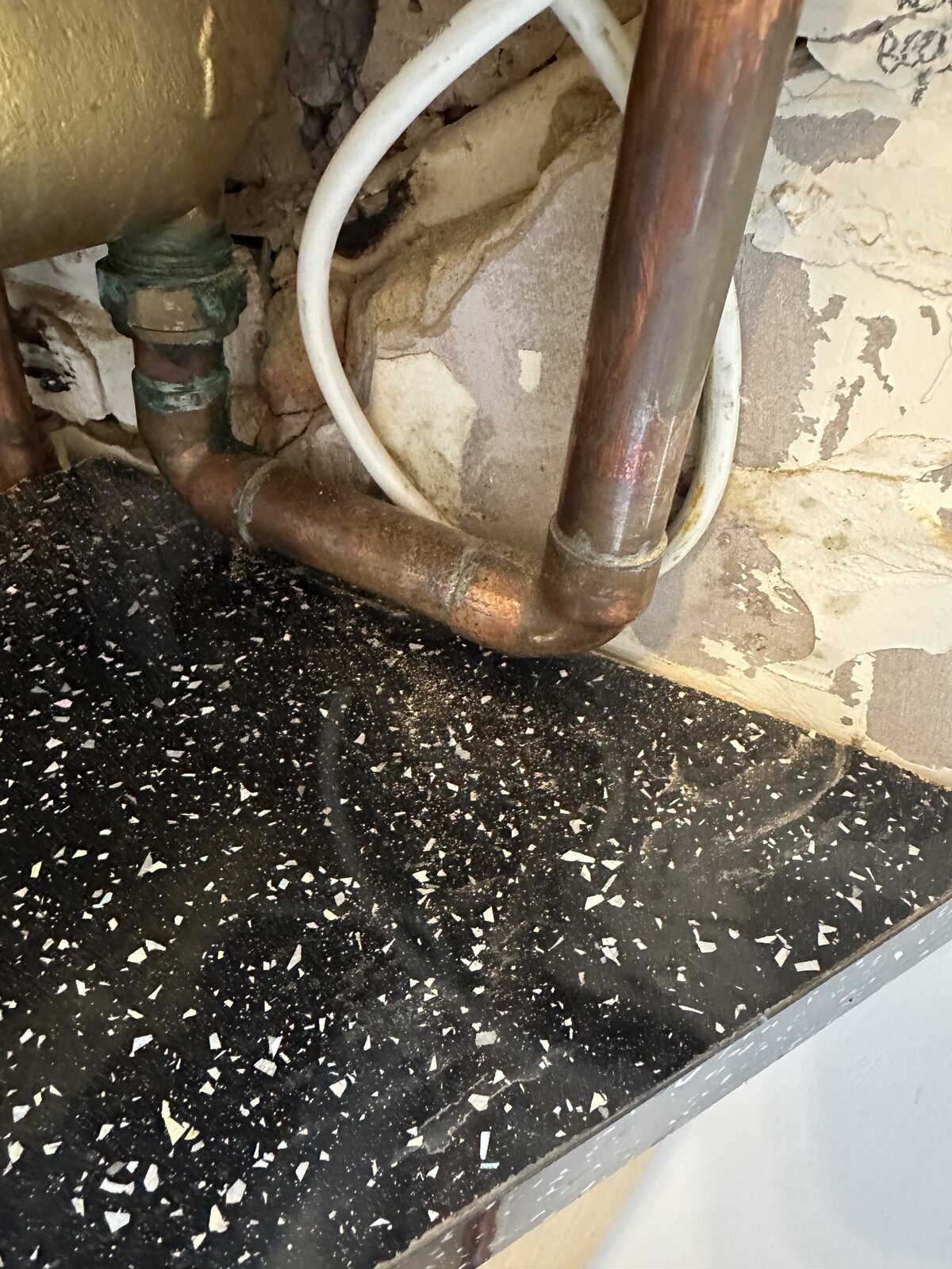

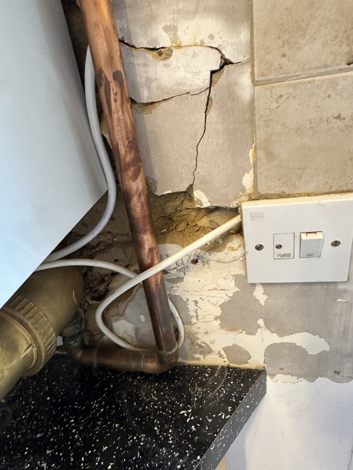

I got a new boiler fitted. The plumber, however left the wall behind stripped down to bricks, pieces of old plaster.
The issue is - there are dust particles falling off the wall and spreading all over my kitchen with boiler use.
The solution I imagine would be to plaster behind the boiler pipes somehow. But this is hard because of lack of space.
But a handyman suggest using - Soudal genius gap filling expanding foam https://www.toolstation.com/soudal-genius-gun-gap-filling-expanding-foam/p15361
Is this a good idea?

I have attached some pictures. He said he can spray the foam and then it will dry and he can cut it into shape….

I wouldn’t use expanding foam. Could possibly use bond and skim, or perhaps if you’ve some tiles left then tile it?
Did the Plumber cause the damage or was already there? Looks like it might have ibeen in poor condition before the boiler was fitted.
Do you intend to hide the boiler?
Shape and slide a slim decorative sheet like Alusplash panel down behind the pipes
I don't understand how expanding foam will help.
If you want to stop the dust, perhaps use either dilute PVA or SBR. It will lock the loose particles in place until you re-tile.
