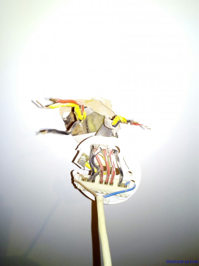

I'm after some help regarding the wiring of 2 wall lights taking power from an existing ceiling rose, controlled by a double switch.
I had a lecky come and sort some wiring for me but unfortunately he's done a Houdini, he was cheap!
The existing rose powered an old fan/light combo, the 2 cables outside of the rose go to the walls lights I assume? How do I go about wiring them together to put power to wall? The rose has a light attached to it currently which works off one of the switches.

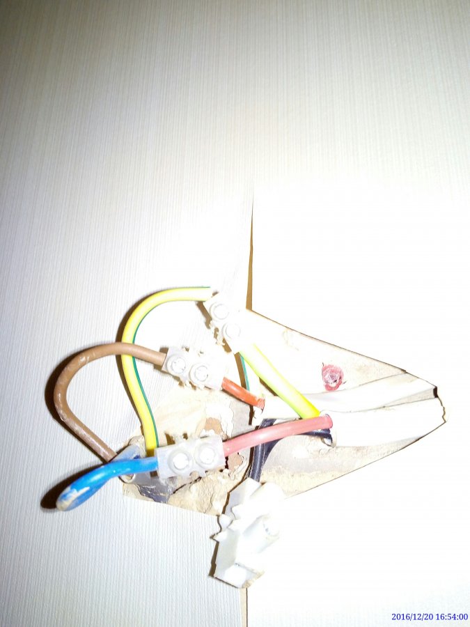

This is the first wall light position. I have no idea what's going on here, how do I wire a light into this?

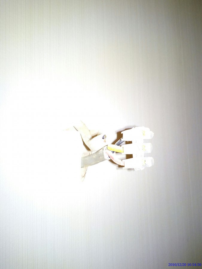

This is the last wall light position. The white cable is still currently fully sheathed. Is it as simple as putting the white cable into the correct positions on the block with the grey cable and wiring the light into the other side?

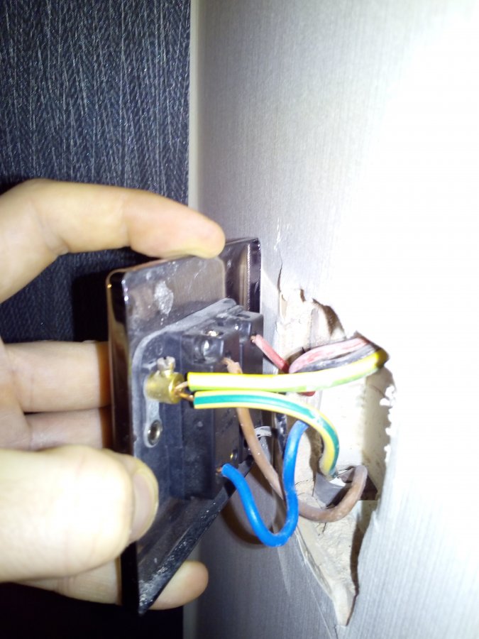

Also there is a cable that has brown and blue wires - that is obviously a newer addition, but all of the other cables in your pictures have black&red wires.
Need to identify where that brown&blue cable ends up. Maybe a photo of the wiring behind the switch will give us a clue.
But I rather think this isn't going to be a quick job to sort out over the Internet..
Yep, i would bet the blue and brown are the switch pair. As TTC has suggested, if that's the case, it won't be too much hassle to work out what's what. PS i think the pendant flex is wired wrongly the blue flex should connect to the 2black cables and the brown should connect to the single black, which is the switched live this should have a brown sleeve or brown tape to indicate it's SL.
Please be careful, as the reds in the centre of the rose are live even when the switch is off.
Turn the circuit off at the mains before connecting the wall lights. The wall lights would be fed from the 2 black and blue flex connector in the rose and the red the the wall lights would connect with the 3 reds in the centre connector.
The first wall light will have a permanent live behind it (the red and brown) the second red is where you would connect the L for the wall light the N would connect to the 2 Blacks in the connector block.
Post the switch wiring BEFORE doing anything ! Please

The blue/brown does go to the switch, unless thats a completely different cable then I'm in a pickle!
Well that makes sense, the wall lights would have been switched with the centre light. Someone has added a separate switch pair which runs to the first wall light under the floor and then up to the switch position.

PS the blue wire at wall light one requires brown sleeving or tape around it as it is the switched L from the switch. The lamp would be wired across the Blue with sleeve and the 2 blacks, and earth to the green and yellow.

What's troubling me now it the fact there are the 2 white cables on the first wall light, and only one on the 2nd but also a twin/grey sheath is there, and 2 whites by the rose? ZERO wires at the wall points are live, which is what I expect.
The second wall light will only have one cable as it's the end of the line.

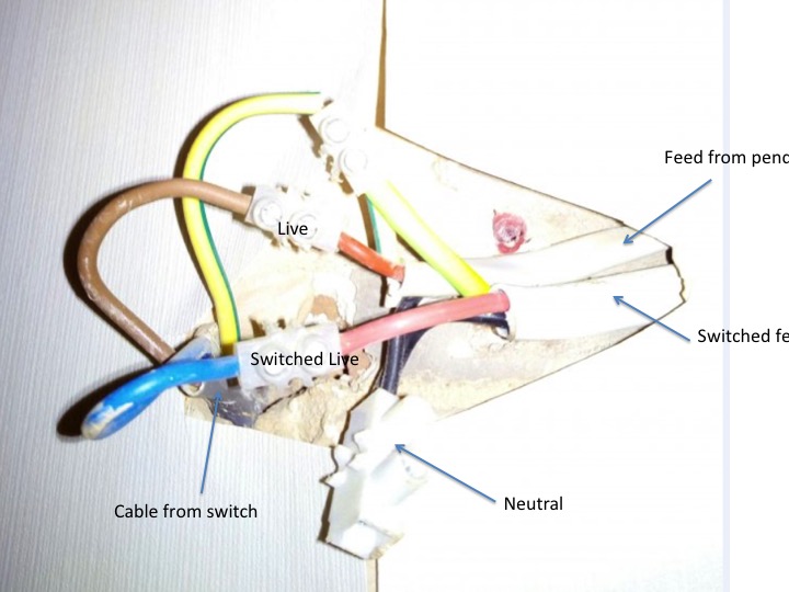

Here is my best GUESS.
It's only a guess as it needs confirmation by use of a test meter. And ALL cables must be checked as to their function before power is applied.
There are two spare cables at the pendant. One MAY be the feed to the wall lights. You will need to buzz them out to check.
The other cable MAY have been the feed to the old light/fan?
The identified cable at the pendant needs to be connected to line and neutral feeds on the ceiling rose.
The wall light position with all the cables would SEEM to be like this.
good luck getting all those wires behind a wall light!
EDIT, the picture has been trunkated.
Top right cable should say "feed from pendant"
bottom right cable = switched feed to second wall light.

Yes exactly like you said, both spare wires above the pendant powered the wall lights, one permanently and the other by the switch. I bought a box of those Wago connectors, which are brilliant, can't believe I've never seen those before! Used those to connect the wiring. I placed the wiring that powered the wall lights permanently into some wago's and put them in a small junction box to hide away above the ceiling.
