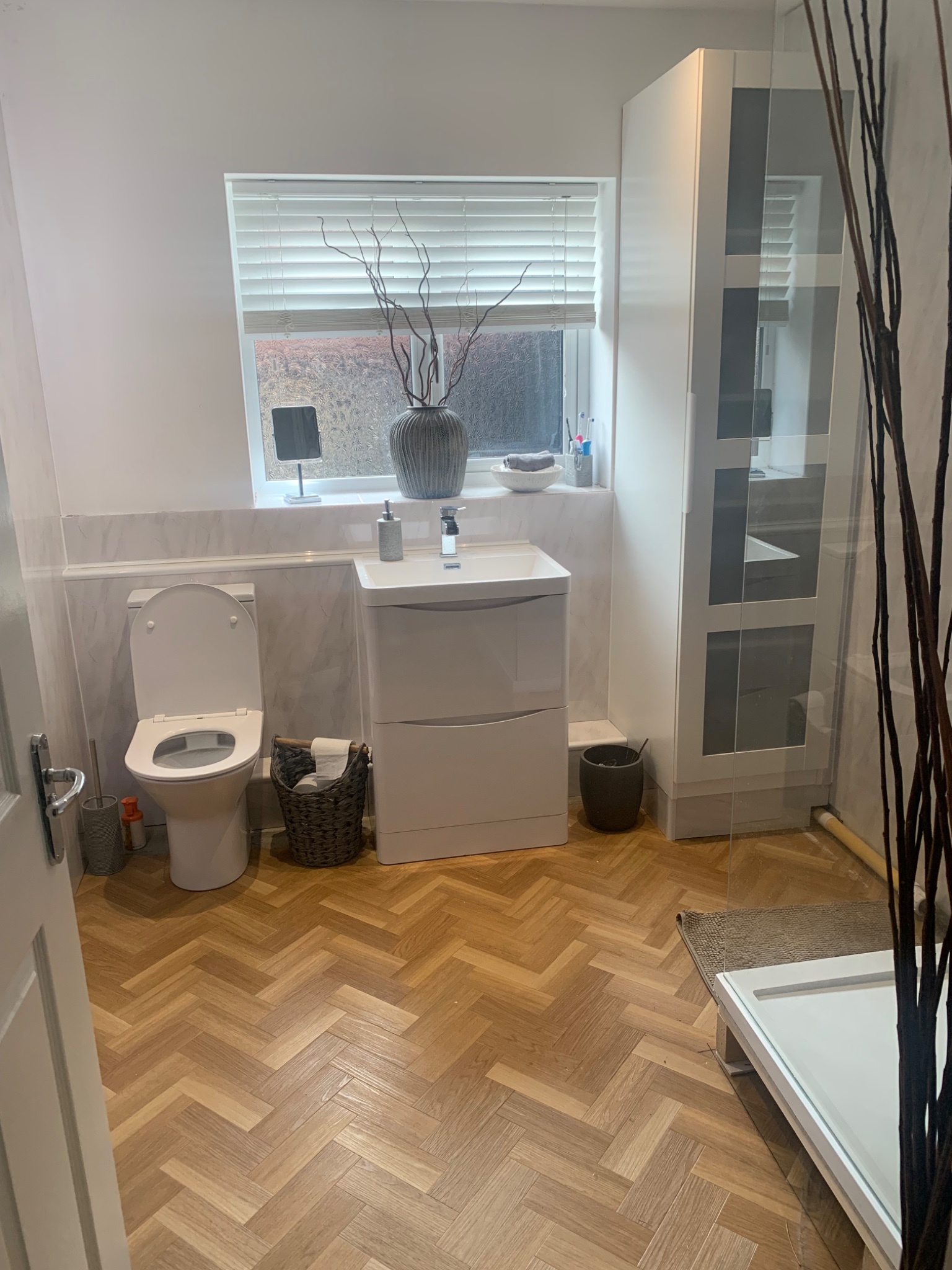

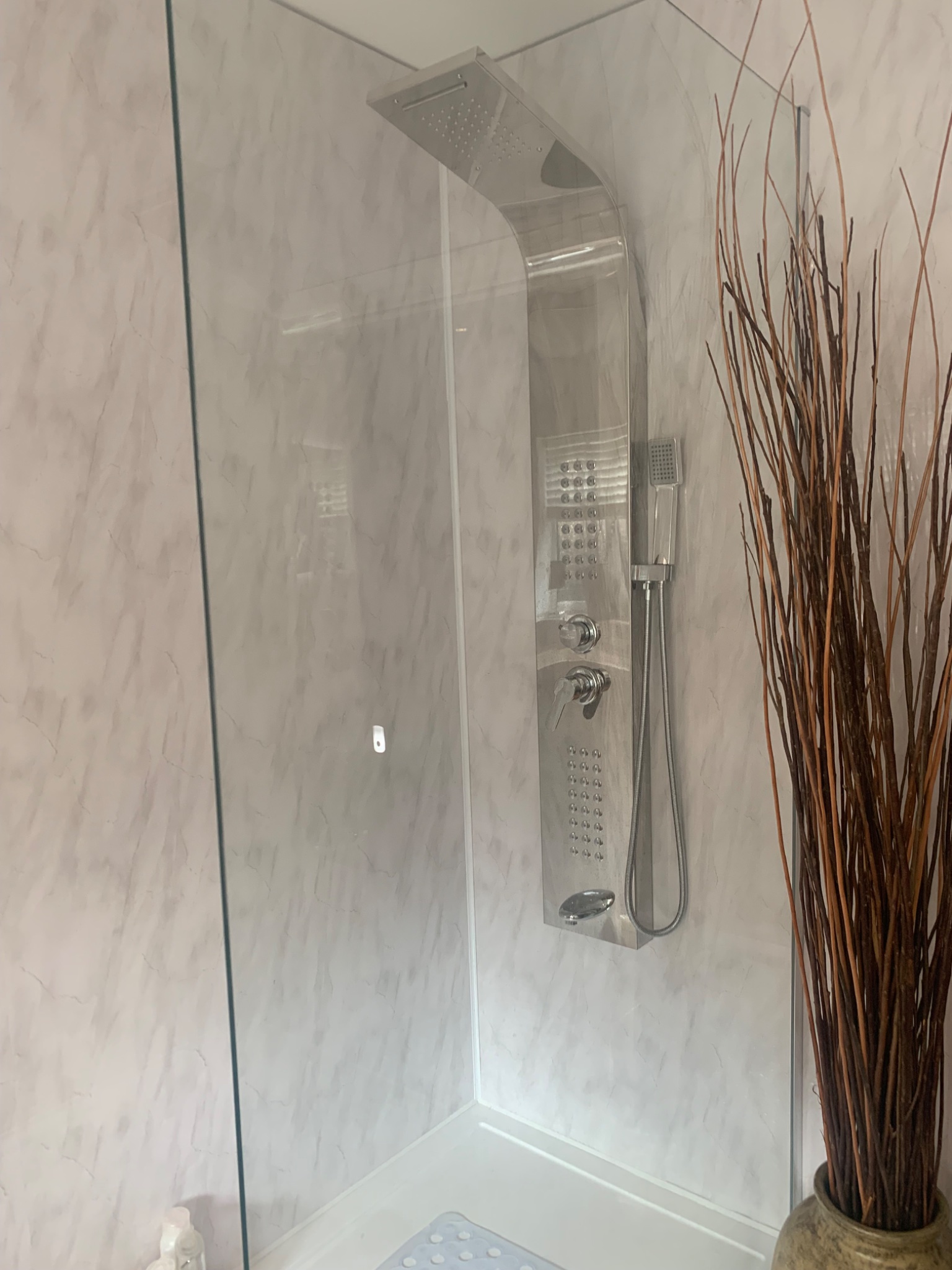

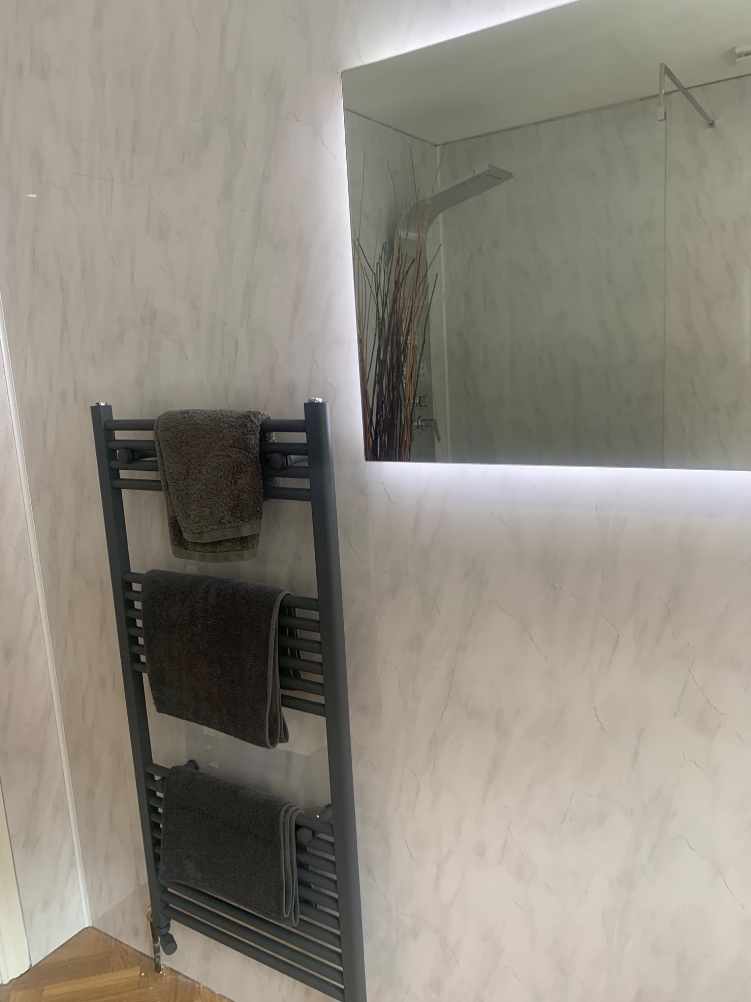

Purchased mine online ,£35 a sheet .
You can get some at 2.6m for higher ceilings .
The only fixings in my shower is the metal upright holding the glass so fixings are not a problem .I used on three walls .The corner and shower base trims should be bought from same supplier .

Ive never had an issue screwing enclosures through hollow boards but I can see how you would if your heavy handed.
The silicone on the enclosure will do 90% of the holding the screws are just to get it flush against the panel whilst the silicone goes off so don't need ramming home as tight as possible.
