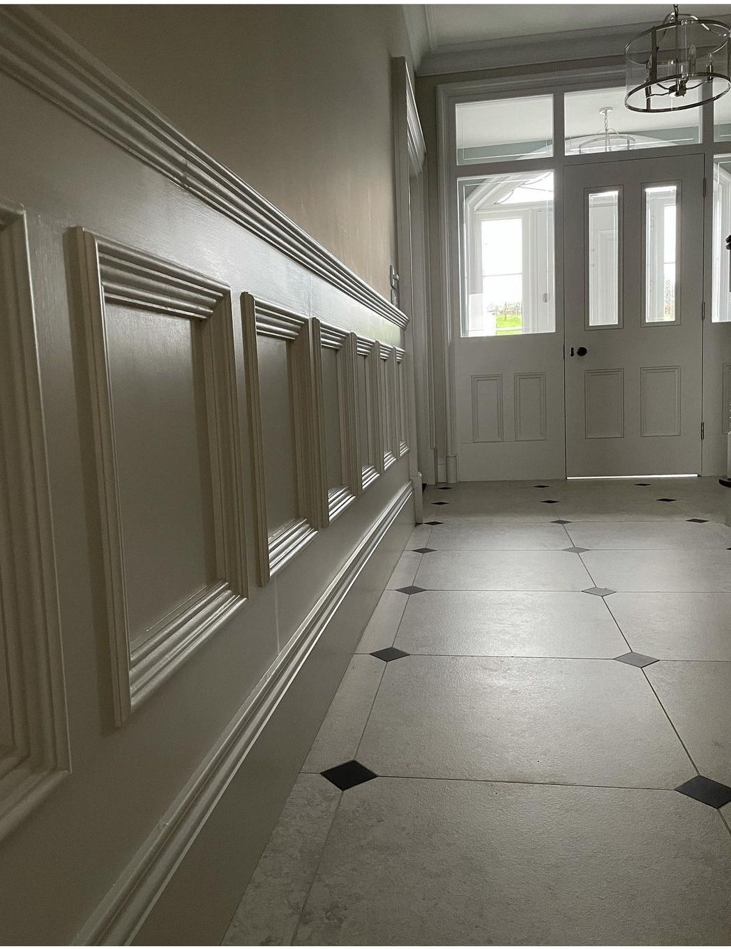

I am doing mdf wall panelling and looking to add the detail on top and inside the wall panelling like picture attached.
Would anyone know best place to get this?

Make your own...
If your wall is uneven you start by fixing 4 or 6mm MDF to the wall, The main frames are basically just straight pieces of 12 to 18mm MR-MDF for the top and bottom rails and more straight rips for the upright stiles. This forms the "frames". The top moulding you see there is just a rebated dado profile planted onto the top of the upper rail. The panels there are moulded-out with a bolection moulding, mitred in the corners and pinned in place. Finally a Victorian skirting is affixed to the bottom. Pretty much all the mouldings used in a job like this can be had off the shelf. Main tools are a portable saw, a mitre saw and (ideally) a 2nd fix pinner (nail gun)
Because every house is different, you can't just buy a kit to do this - it simply wouldn't work. This is bespoke work, made-up on site, which requires the services of an experienced joiner ("carpenter" dahn sarf), especially where you need to take the panelling up a staircase and round awkward corners. Try to find someone who can show you examples of their work locally - this is not a job to hand to chancers
Or you could just DIY...

That's bolection moulding. My preferred supplier:
