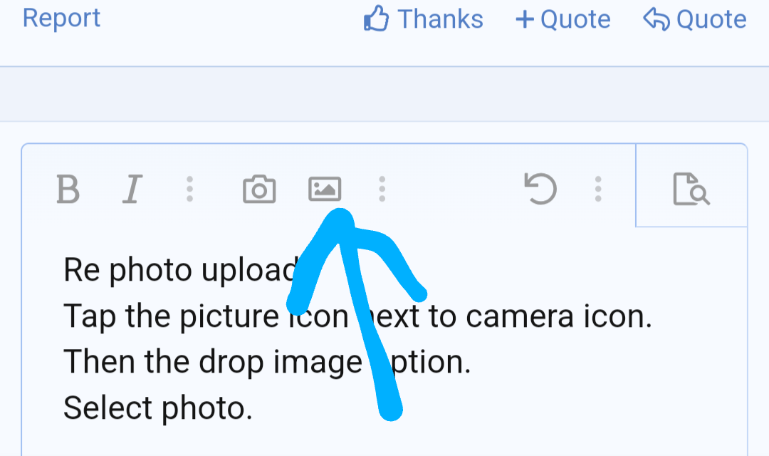

Tried to upload the images directly here but amazingly being told they are too big despite being <1MB, so here's a link
