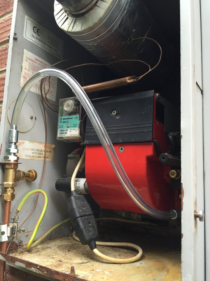

thank you for your replies, yes the boiler is around 4 or 5 foot which is above the tank.
our boiler man hasnt been in touch yet so i havnt been able to ask him whether it was a non return valve that he has fitted.
i went to my mums today who has exactly the same boiler as me & has had no problems what so ever, i took a picture of hers inside to compare the valves & yes they are different...she has the same valve as what was taken out of ours...i will post a pic of hers.

Yes looks like you have a bit missing.
Don't get your existing boiler guy back. He has just been wasting your money and time.
We work on a lot of wallstars and have had a big problem with the replacement fire valve/Non return valves being faulty from the off. Just something you need to be aware of for when you get one fitted.
Make sure the flexi pipe is sealed with PTFE onto the fire valve and also the fitting at the pump end as air will drag in any where it can- even on the shaft of the fire valve. Don't use oil sealant as the pipe needs to be removable for replacement.
I'm a bit concerned there's so many compression fittings in the oil line, there needs to be as little as possible to minimise possibilities of air ingress.
Having said that, it seems this latest problem is not due to air in oil line. Boilman2 is right, the spark generator is a particular weak point on these and needs to be checked,

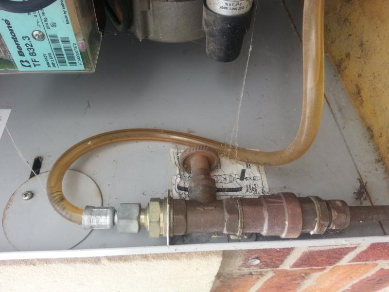

our engineer came & changed the valve to a non return & it ran ok for 2 weeks then locked out, last week he changed the clear pipe in the boiler & it ran until today & locked out again only this time there is hardly any oil in the pipe. I'm at my wits end with this, does anyone have any idea what can be causing it???
sarah

Looks like there's a massive static air pocket in the clear flexible oil line. Air must be getting into the oil line somewhere.
Something that's has worked for me with Wallstars with an intermittent fault is to put an elbow in the oil line as it enters the boiler casing so that the NRV runs horizontal to the floor of the casing and position the flexible oil line so that it runs up towards the oil pump this allowing air to not get trapped in the loop. The air simply goes up intonthenool pulp and is expelled through the nozzle.
