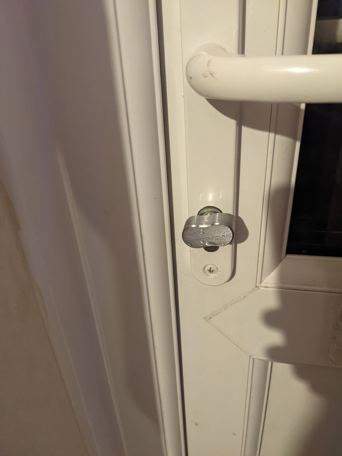

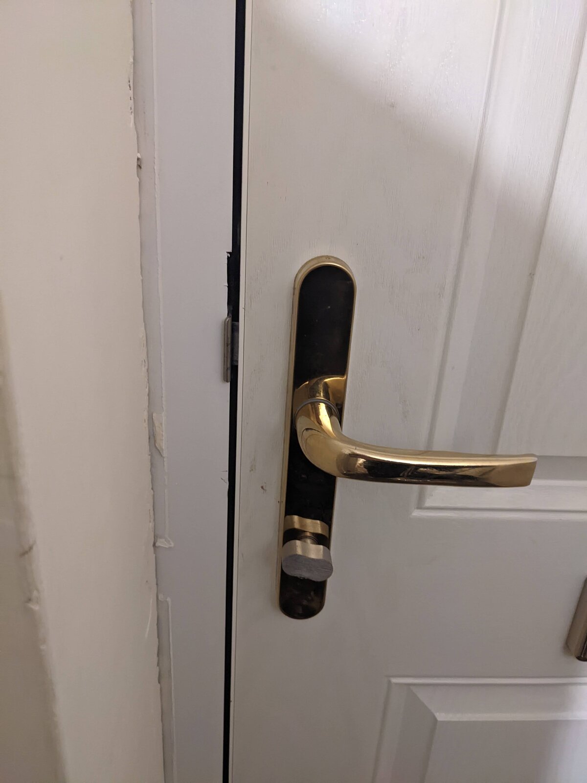

I got these 2 pics, I wanted to add locks in addition to these rather than change them if possible.
Those are pictures of the door handles. Look at the edge of the door and you will see parts of the lock.
The letterbox is relevant because a simple tool can be inserted to operate the internal handle or key.
The external keyhole is relevant because some lock barrels can be easily broken or pulled out.

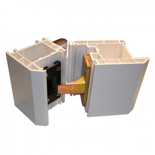

The first picture shows an outward opening door? - this might also have an issue with just prising the door off of the hinges (depending on the type)!
Some hinge bolts and receivers may be of benefit :)
