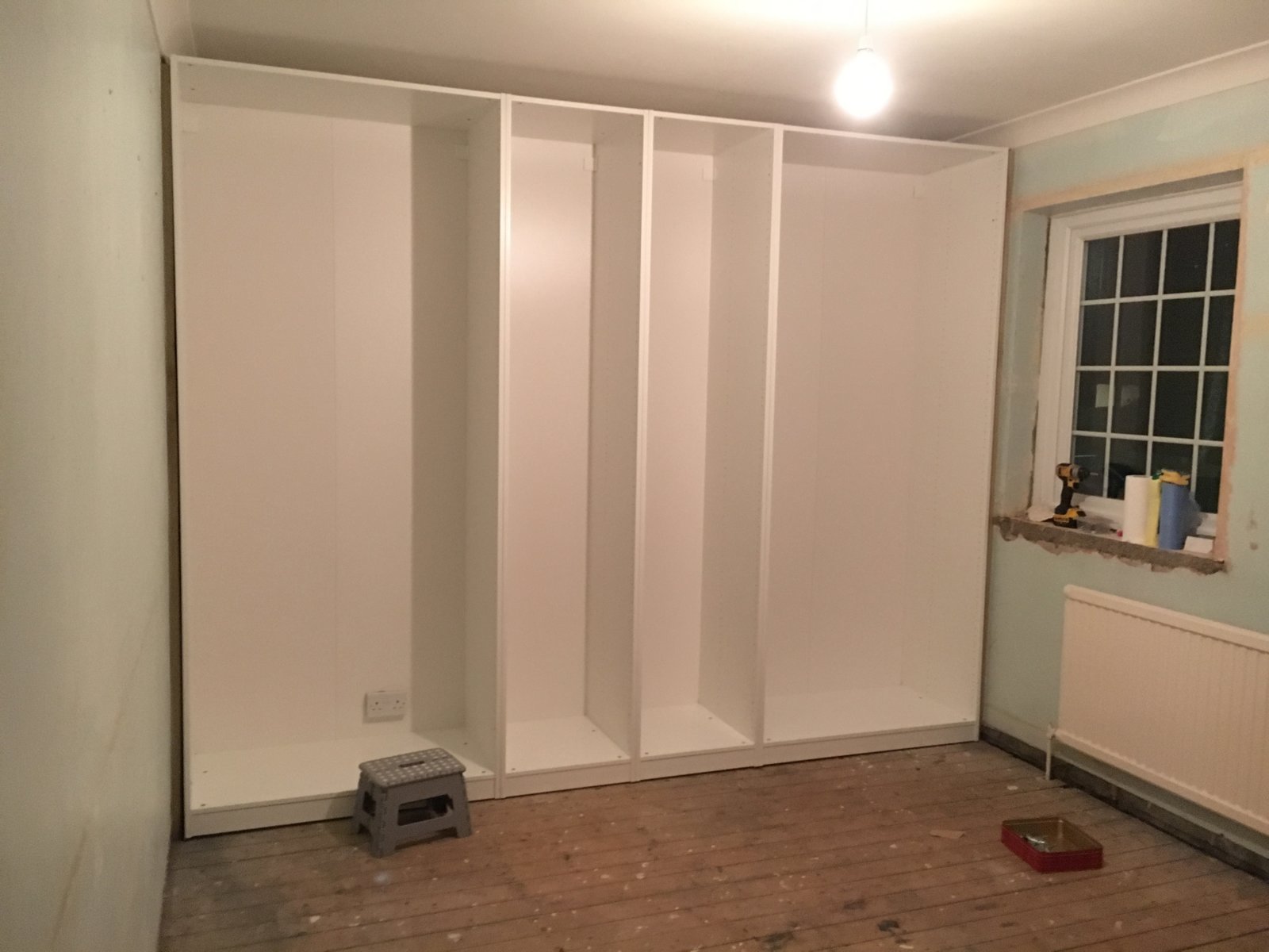

Hi,
I am fitting wardrobes and would like to install LED lights which come on when any of the doors are opened. There are four carcasses with a total of 6 doors and my plan would be to run one single 3m strip of LED lights along the top by drilling through the carcasses.
this is the type of thing I have in mind:
https://www.ebay.co.uk/itm/RGB-Stri...630157&hash=item1a32b887bc:g:Y60AAOSw76hZjVa5
There is a double socket in one of the wardrobes where they could be plugged in. I am unsure of how to get them to operate like I want them to so would really appreciate some advice on suitable switches, and wiring diagram etc etc.
Thanks!

Do you really want the variability of colour that RGB lighting provides in a wardrobe? I would have thought plain white would be better.
Lighting with a plug-in supply like that is no good, as you won't be able to switch the supply on and off with door switches - you need to find some where the supply has a flying lead for connection so that it can go via the switches. All of which you connect in parallel, so that any of them will turn the lights on.
You need push-to-break switches such as these:
https://www.tlc-direct.co.uk/Main_Index/Wiring_Accessories_Menu_Index/Switches_Miniture/index.html
Put them as close to the hinged sides of the doors as possible, as they are surprisingly powerful little b****rs, and will push the door open if they are to far from the hinge.

Power supply/driver/LED transformer - they get called all sorts of things, some more "correct" than others.
You can leave the power supply permanently connected and put the switches in the 12 volt side. This is how it is usually done these days by wardrobe fitters. Modern switch mode supplies take naff all electricity on no load.
Switches in the 12v side will result in the switches failing, as they are only rated for 1 or 2 amps maximum and not designed for DC either.
;)Okay so the plot thickens lol. Anyone able to provide me with a list of stuff that can get this job done?
Looking at the exposed connections on the back of the switches that davelx linked to, I would suggest that under no circumstances should they be used on anything except extra-low voltage (under 50V AC or 90V DC) unless extra insulation/shielding was provided.
