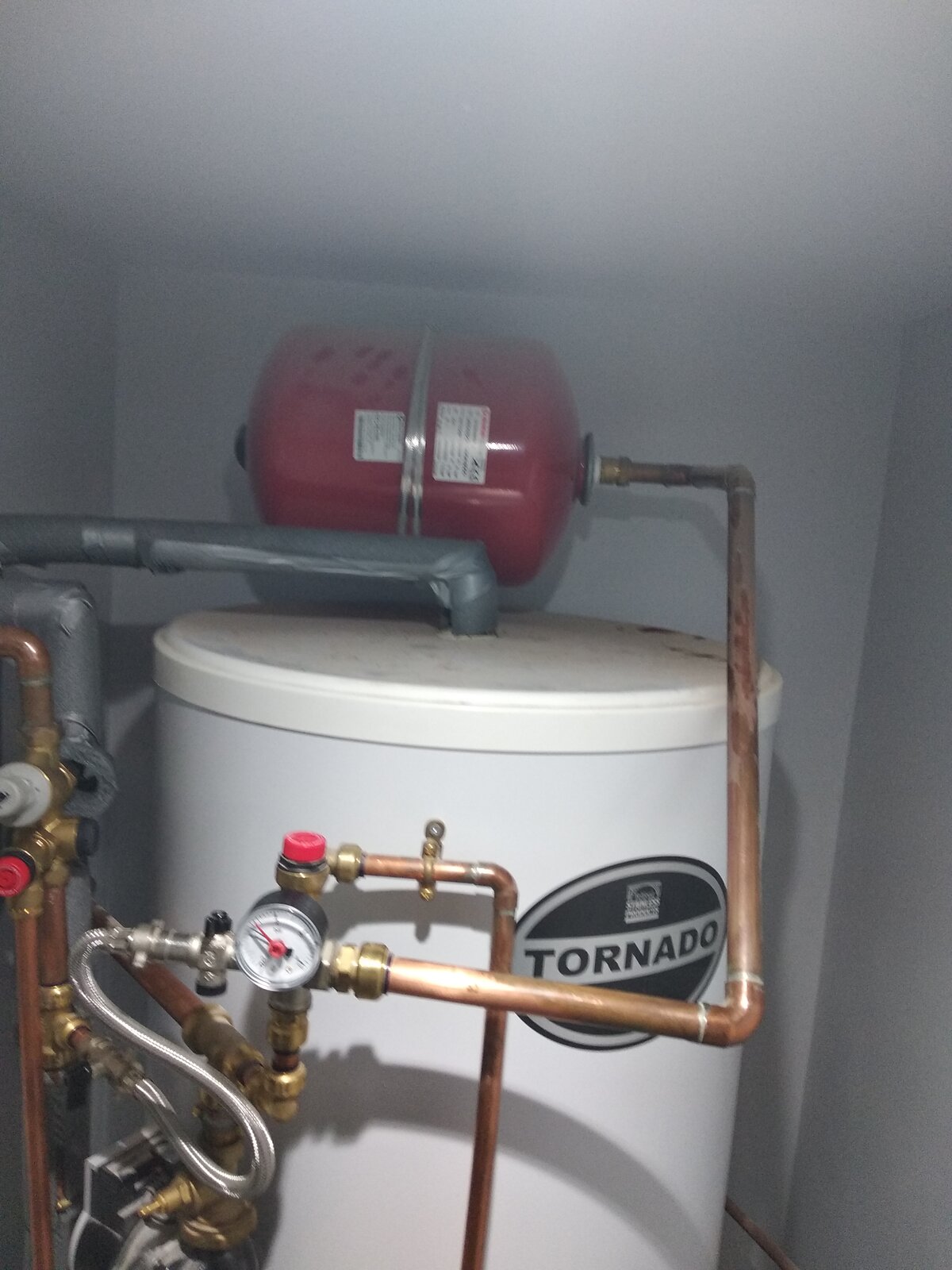

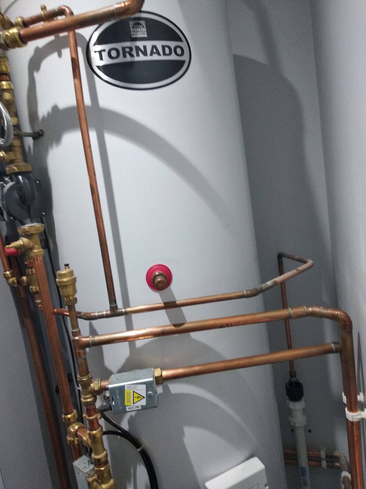

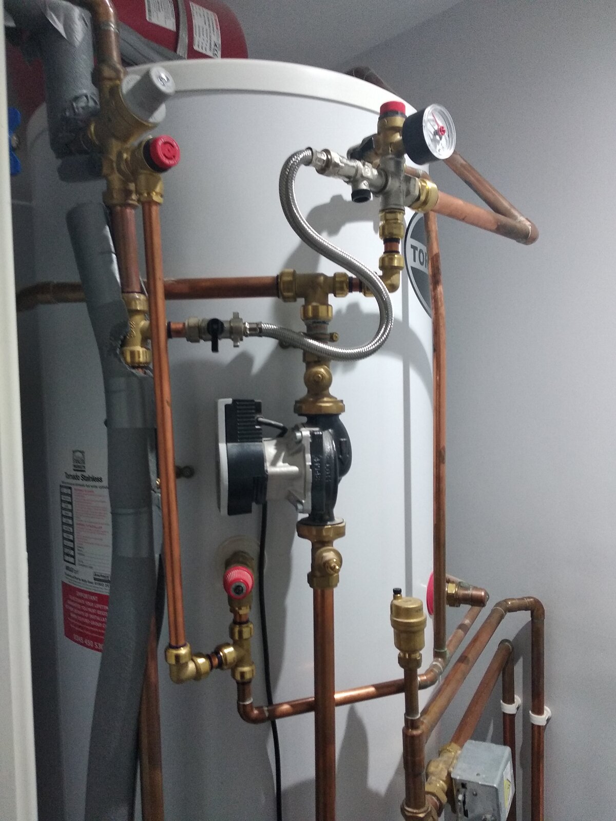

Hi, firstly thank you to the both of you for your time and replies, really appreciated.
Just to confirm, the plumber is G3 qualified. I have also attached a few pictures in case it helps.
THe plumber fit a pre-plumbed Tornado Indirect Unvented cylinder from Telford Cylinders, this is used to provide hot water for the central heating, hot water and underfloor heating system (which i wondered if that has any impact).
I appreciate the hot pipes may warm the cold but as another test, i have turned off the hot water, and then the heating for a few days each and we still get the same problem. Does this not mean that the pipes in the ceiling weren't getting hot and therefore the cold water pipes shouldn't be getting really warm like they do normally as there is less heat going on in the ceiling.
However, during this time we still had the UFH still on throughout the day, therefore the cylinder was still working I assume.
Today, i have tried turning off the UFH throughout the day (and yesterday afternoon) and the heating and hot water went off first thing. During today there seemed to be less warm water coming through the cold tap and didn't need to run it off for 30secs. SO i suppose i was just wondering if the piping to the UFH could be causing the issue of heat / pressure build up in the tank and somehow getting to the cold supply.
On that point, the thing the plumber changed, just in case it was faulty, was the cold inlet group. I understand this to be a Caleffi Inlet control Multibloc valve. From what i have researched, this contains a pressure reducing valve, pressure relief valve, strainer, balanced cold water connection AND a check valve.
This is fitted at the top of the cold inlet pipe and i assume this check valve would stop the warm water going in to the cold supply? The pipes before this valve are only really cold when we run the cold tap. If i check it in a morning before anything is used and the system has been on for a few hours then those pipes are not very cold at all and when i runa cold tap, it seems to take a while for them to turn really cold.
I understand the external expansion tank (which i wasn't sure if it was needed as it says in the manaual there is an internal one in the cylinder) was set at the correct level when it was set up less thana year ago but not had anyone check it recently. This is piped to a pressure control which is around 1.5bar but on the set up diagram it seems to indicate this should be piped to the Caleffi valve but mine isn't.
Based on one of your comments earlier Endaxi, i notice that just below the Caleffi valve there is a T off the cold inlet pipe and that runs to a flexi hose that goes to a pressure gauge (as previously mentioned set at 1.5bar) and then continues to the external expansion tank. I have no idea what that means or if correct but could cause the problem?

The NRV is downstream of the balanced cold supply, to stop exactly that occurrence where the balanced cold could be backfed by the cylinder expansion. In the combination valve the NRV it is the first thing the returning water hits as it tries to enter the valve.
I'll bet that the balanced supply is sitting next to a CH pipe somewhere and it's warming the cold pipe up .... I wouldn't say it's "just how the system works" rather that it's how the system has been designed and run/laid out by the installer
The T off is just feeding the CH filling loop and looks shut. The red expansion vessel, after the fill valve double checkvalve and blow off, isn't for the HW cylinder, it's for the Central Heating. The cylinder will be using its internal bubble, it could need re-charged but I would hope that's already been checked by your plumber.
Really need to map where the pipes are running, even just to rule it out.

Phil, I’m trying to find a way to get my main point across.
If you follow the cold inlet pipe to your cylinder does it go straight to your inlet group (combination valve) or does it reach a T first?
Mine went to a T first. The back flowing expanded hot water from the tank could not turn right at the T and pass through the inlet group (combination valve) due to the NRV but it could turn left and flow through any balanced cold tap that was opened.
I now have an additional PRV/NRV between the cold inlet to the cylinder and the T so that no water is capable of back flowing anywhere from the cylinder inlet.
