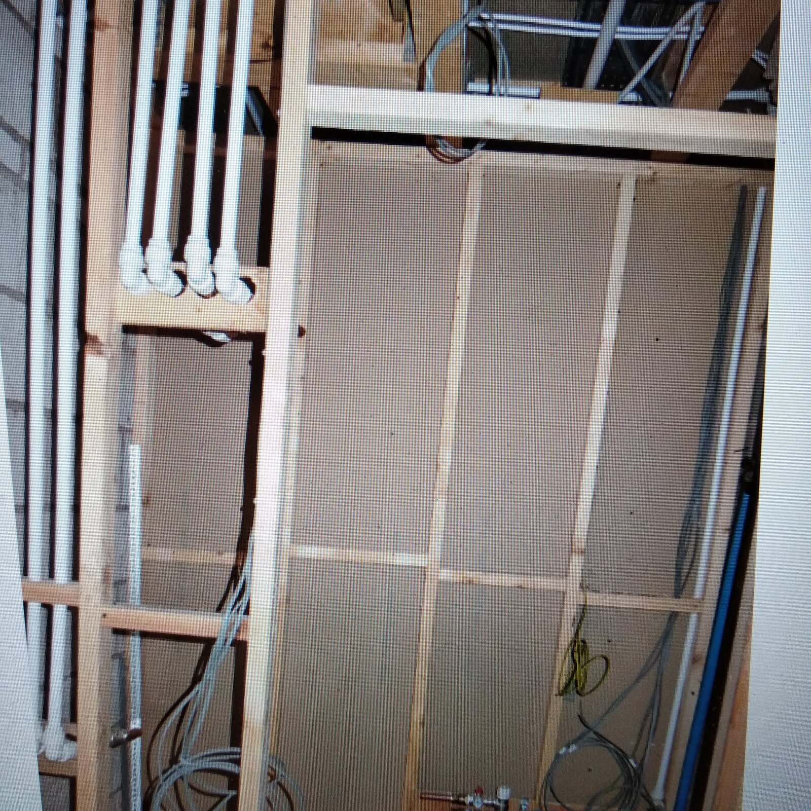

Here is one pic of pipe spacing
Here are the 4 pipes that were installed. I think the 2 on the right are the cold feed in and cold balanced out.
I assume the others are hot and CH but thought I'd share so you could see spacing more than anything.
Thanks again
Phil
If those pipes in pic 3 are boxed in together without any insulation and the 2 on the left are hot then that space will be getting warmed and at that point at least, so will any standing water in the cold pipework.
