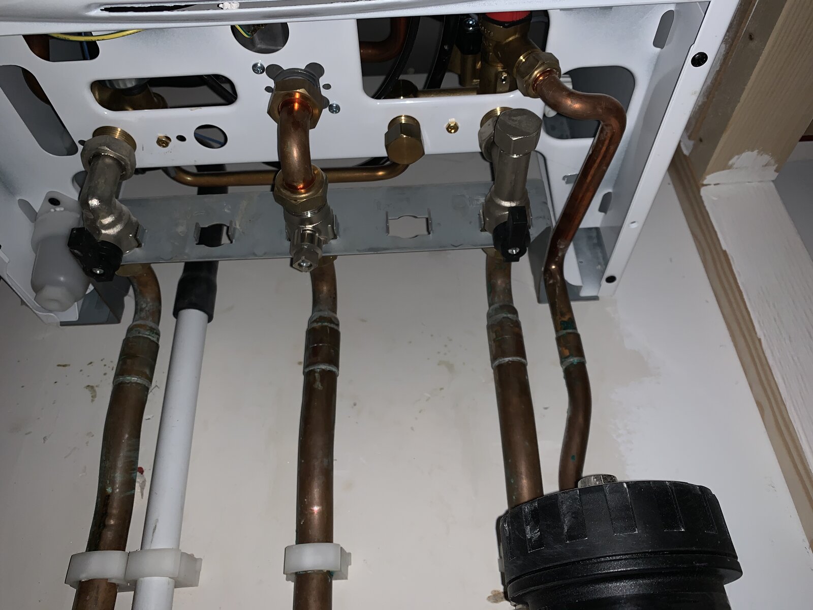

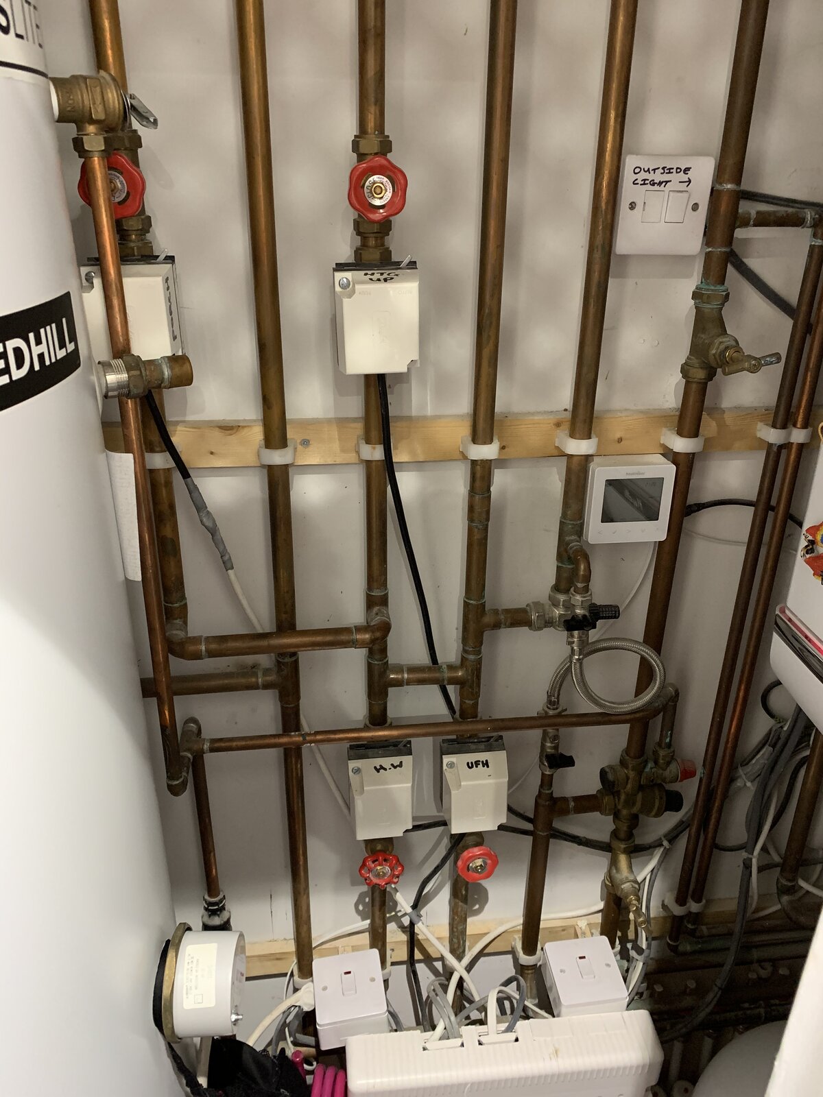

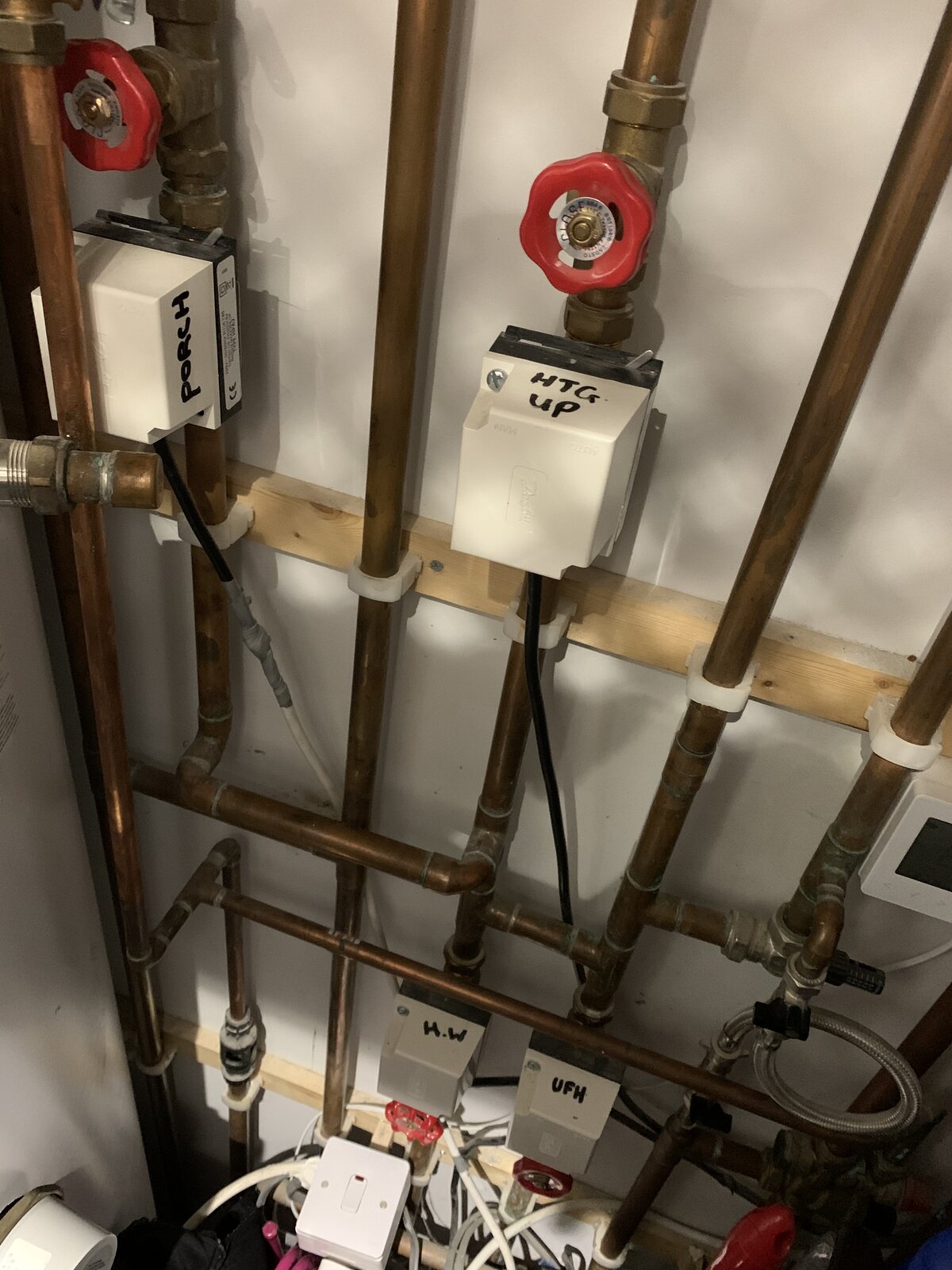

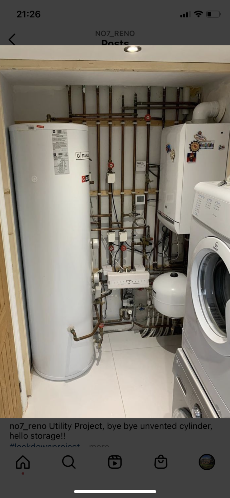

Good evening guys, apologies for digging up an old post but I feel I have feel I have similar issues to that stated. My hot water tap has warm water and a surge of high pressure when turn turning the cold water tap on. The hot water follows around 5 seconds after turning the cold tap on. I have isolated the hot water supply to the house from the top of the cylinder. So only the cold water runs (which isn’t so cold at times). Can anyone recommend any other checks I need to preform please to iron these issues out? I’ve attached a photo of the set up, I think it’s an invented cylinder with a system boiler? The cold water feed is very cold running from the Mains up through the back wall so don’t think it’s getting warm from the other pipes? Any help would be great. Cheers Ash.

The cold water in our downstairs wc initially runs cold for a few seconds, then warm for a few seconds, then cold again. I just put it down to the pipes being routed through our airing cupboard warming that section of cold pipe.
Good morning, the pressure seems to be rather high in the line when opening, I know the heat expands the water in the line but the cold water supply is freezing in the boiling room, id very much doubt the cold water line is conducting that much heat from the run through the floor boards section?
