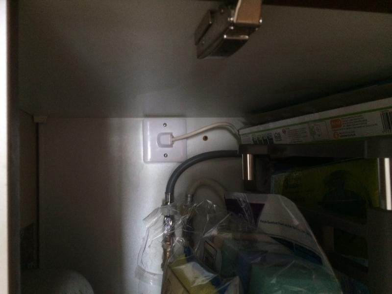

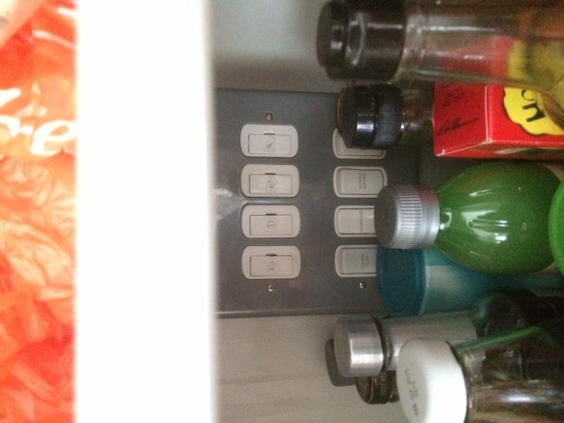

in the kitchen there is a fuse box with switches and fuses for each kitchen appliance. I replaced the 13A fuse for the washing machine and the RDC circuit blew. I changed the fuse again and circuit blew.

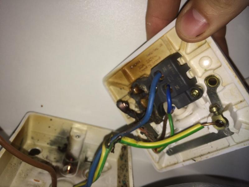

I looked under the sink and opened the fitting where the washing machine is connected. Opened it up and found that the live had melted the fitting (it's not like a plug socket but i dont know the right word for it so put a pic in my album) . Fitting is 20A if that's useful.

I expect the problem was in the flex outlet. The thing that has burnt out.
Looks like the brown and green wires shorted together
Yes exactly. I replaced this outlet with the one from the dishwasher, cleaned up the cables but the washing machine didnt work....
Oh I see. I thought the dishwasher was close and you used the dishwasher outlet. But I now understand you borrowed its faceplate.
Maybe you need to inspect the rear of switches in the cupboard and see if there is damage.
Buzz out the switch and fuse holder if you can or swap for another.
Or maybe the brown is more burnt out than you think.
Did you replace the fuse when you tried it with the dishwasher plate?
Hi Andy. Yes I stuck another 13A fuse in. I also took the plate of the fuse box in the kitchen and tried to pop the switches to switch the washing machine over with the dishwasher but there was so much wiring in there it seemed daunting and at that point i didnt know whether it was the washing machine itself that had packed up. I guess i'll have to reopen the fuse box and try borrowing the dishwasher switch though.....
