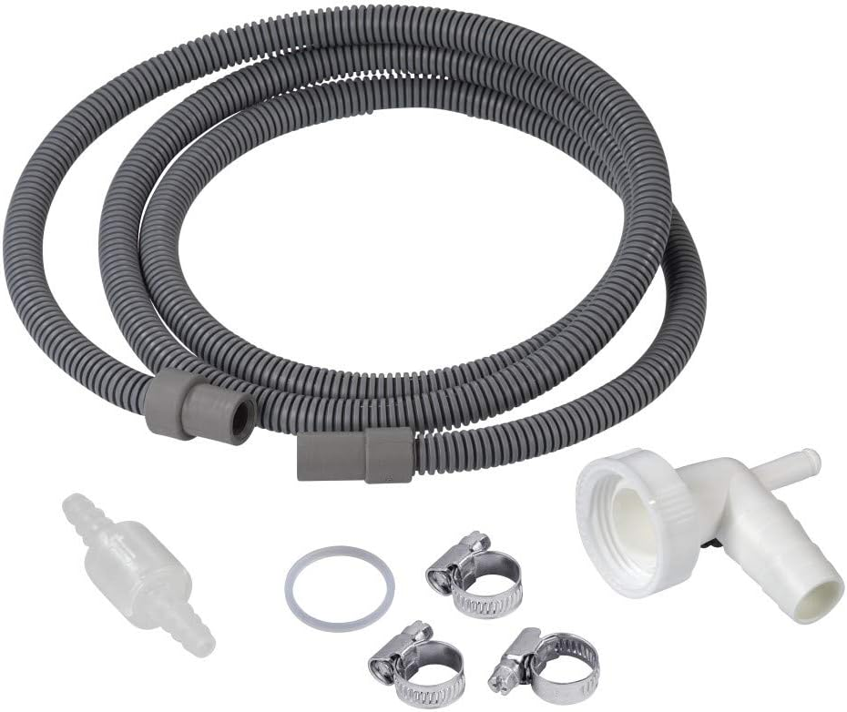

Hi,
I'd like to connect my washing machine and condensing dyer to the same standpipe. I've seen this McAlpine Twin Hose Connector. The washing machine hose would connect perfectly to that but the dryer hose is only 10mm. Does anyone know of a 10mm to 20mm adapter I could use, or suggest another way?
Thanks!
You do get specific adapter kits with a small spigot adapter to fit a TD drain hose, not seen a reducer but I'm sure if you look hard enough one could be found
